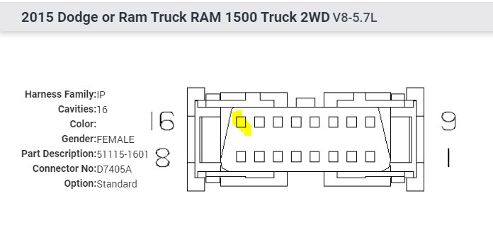

Trying to get an inspection done and the obd isn't connecting.
Sep 11, 2022 at 12:38 AM
  • 110,244 POSTS
When you connect the scan tool, does it power up normally? If not, first check pin 16 for power. That should have battery voltage at all times. If it is good, check pins 4 and 5 for continuity to ground.
I attached a pic below showing the pin locations.
Let me know what you find.
See pic below.
