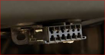

Hello again.
I have attached a picture of what the OBD1 connector looks like. Hope this helps in your search.
Danny-

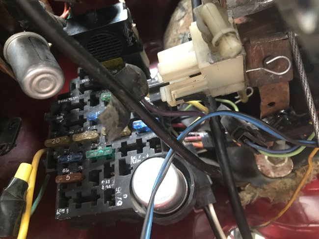

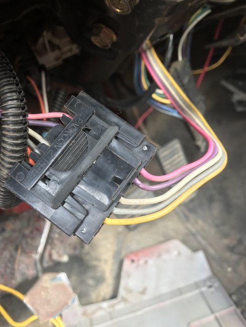

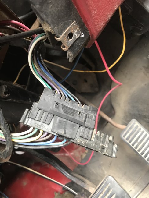

I still cannot find it. Here are some photos of what is there:
Sep 30, 2018 at 8:36 AM
DANNY L
  • 5,648 POSTS
Hello again.
You might want to see if they stuck it up somewhere in the middle of the dash?
Danny-
Sep 30, 2018 at 9:03 AM
SCOTTDANNY22
  • 36 POSTS
I have taken the dash apart nothing even resembles one except for the pictures I posted. This is a 1983 GMC Tahoe pick up with a 2.8 liter v6 manual transmission two wheel drive.
Sep 30, 2018 at 10:18 AM
SCOTTDANNY22
  • 36 POSTS
Can it be located anywhere else? I have traced down every wire in the dash took the whole thing apart and there just is not one.

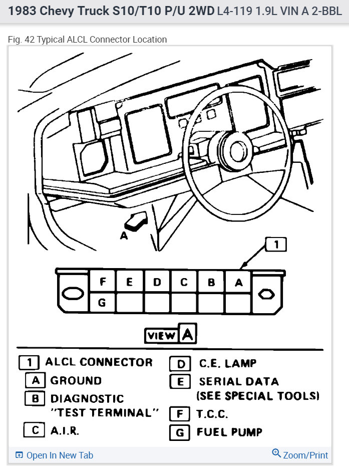

  • 55,583 POSTS
I have found this image for you. Check out the diagrams (below). Please let us know if you need anything else to get the problem fixed.
Oct 2, 2018 at 12:57 PM
SCOTTDANNY22
  • 36 POSTS
Mine is a 1983 GMC Tahoe pick up with a 2.8. I had a retired GM mechanic tell me that they did not have them in 1983 but you say they do. Who is correct?
Oct 8, 2018 at 4:33 PM
  • 55,583 POSTS
I can only go with what the manual tells me. Can you confirm no wires have been cut out and the ALDL removed?
