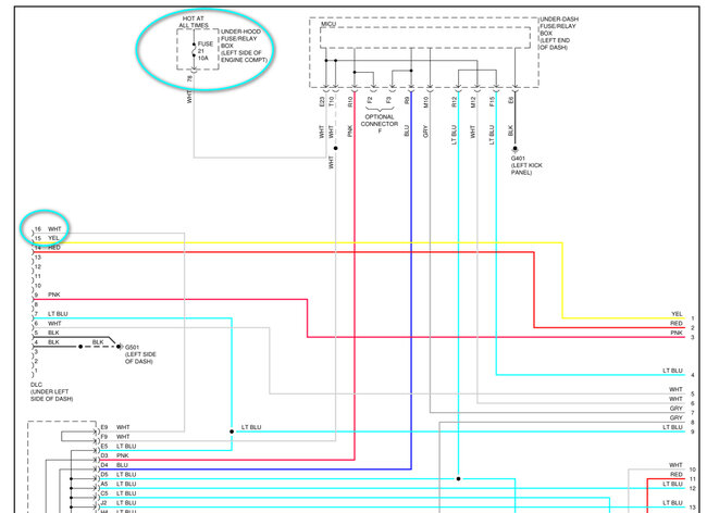

We took our car into Safelite to replace the windshield. When they connected their scanner to the OBD2 port they could not get a reading... So, first of all i need to know which pin to check on the port for power and i need to know which fuse is associated with it. Thank you for your time.

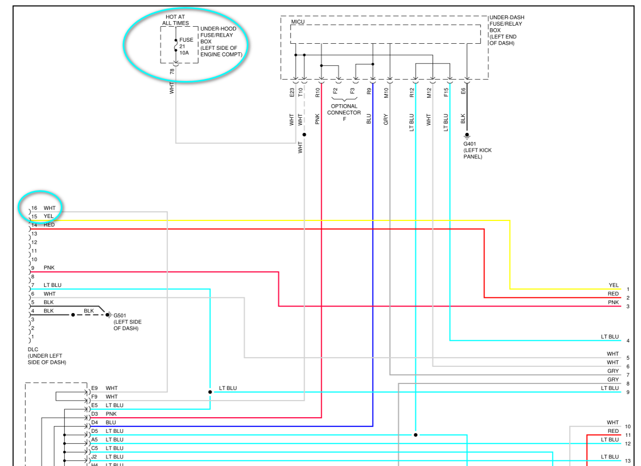

First check that fuse F21(10A) in under-hood fuse block is intact.
How to check fuse:
At the DLC pin 16, white wire, has constant 12V supplied by fuse F21.
At the DLC pins 4+5, black wire, are the ground
You can check for power and ground at the DLC using either a voltmeter or a test light.

Hey Boris, hope you are well. It turns out there was a problem with their scanner. i bought my own scanner and it connected immediately. Thanks for your time.
