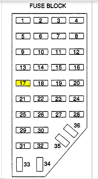

Where is the OBD 2 fuse located?
2002 MAZDA B4000
148,000 MILES • 4.0L • 6 CYL • 4WD • AUTOMATIC
STEPHEN L CARTER
My obd2 is not powering up.

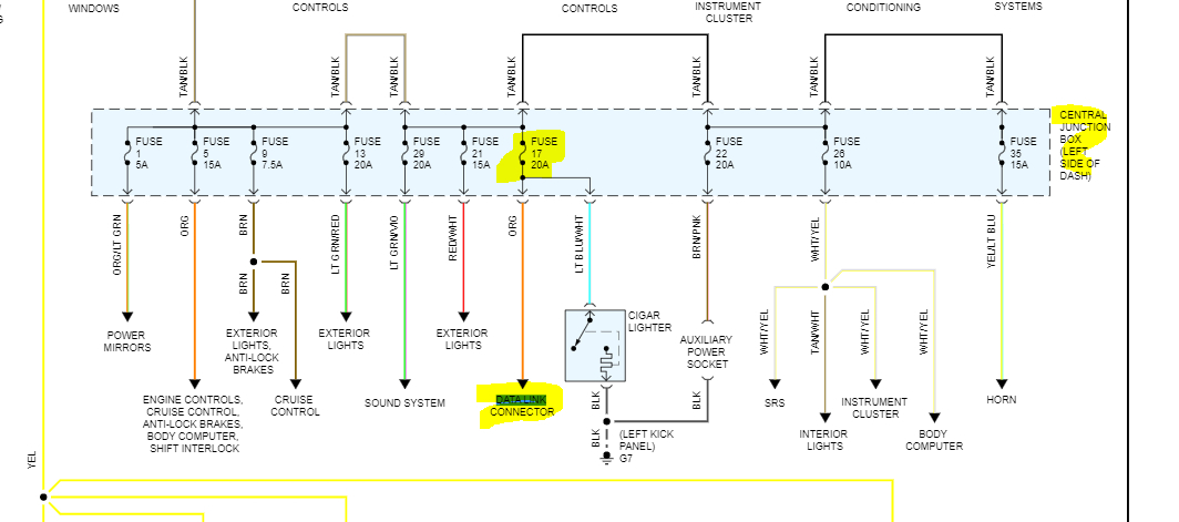

It's fuse 17 in the central junction box. See pic 1 below. If you look at pic 2, it shows the fuse you are looking for. When you check the fuse, also confirm there is power to and from it.
