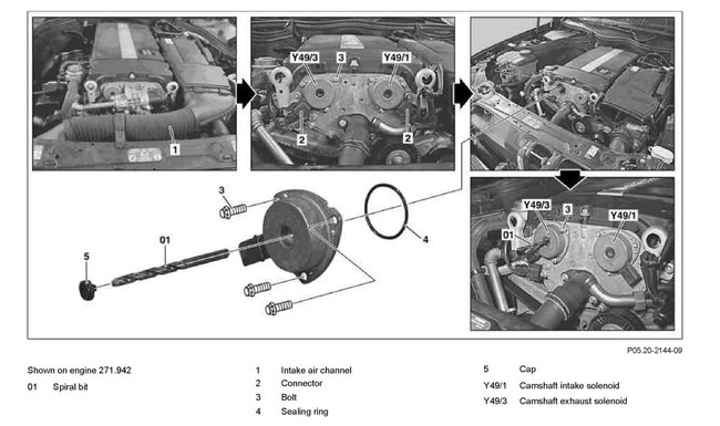

Dear, I have a problem with my car listed above Kompressor. Auto diagnostics showed a fault code P0020 A camshaft position actuator circuit (bank 2). Please tell me how to solve this problem and what is the issue. otherwise the car is pulling well, only sometimes it changes the engine's operation to the back of the gas. Thanks a lot in advance, big regards.

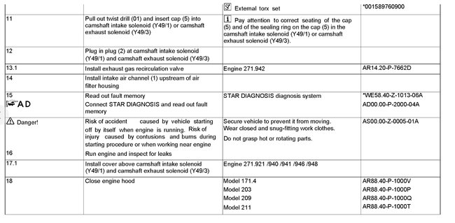

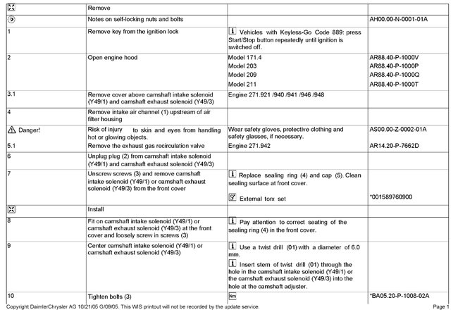

It sounds like he camshaft solenoid has gone out. here are instructions and diagrams below to help you fix the problem. Check out the diagrams (below). Please let us know what happens.
