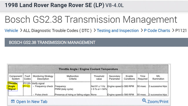

Received the OBD 2 Code P1121 for the vehicle listed above SE Sport Utility 4-door, which is supposedly the accelerator pedal position sensor, yet are not finding the part called "accelerator pedal position sensor".

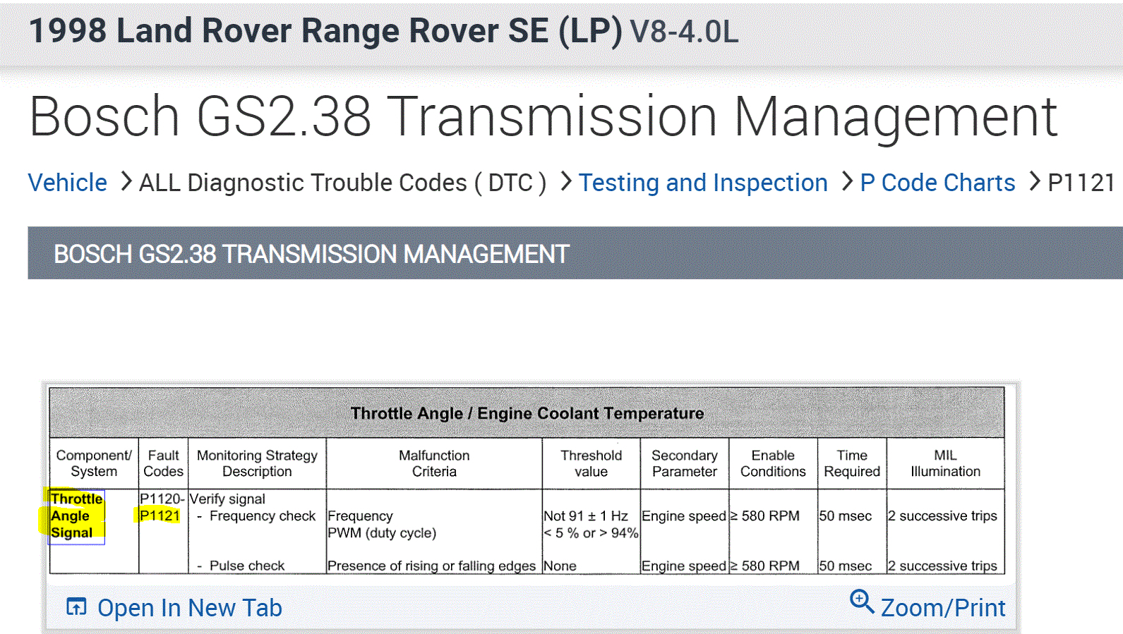

This vehicle doesn't have an APP sensor. The code is related to the throttle position sensor. What is happening as you drive?
See pic below for code info.
Let me know what you are experiencing.
See pic below.

This involves a 1998 Range Rover (in basic-Decent condition) that I had barely driven for a while. So, I had replaced some parts and started to drive it just recently and maybe close to a month ago (Maybe in May/June), while I was in some Parking lots it was close to almost being stopped (at low speeds), the engine Shut off, but did crank right back up. The last few times that I drove this SUV, it did not turn off like that, but I did get that P1121 Code from an OBD 2 Scan tool. So, maybe the Throttle Position Sensor is "dirty", or might need replacing? (If I keep getting that P1121 Code and you're saying that the 1998 Range Rover does not have an A.P.P)

I dug through a couple of different manuals, and they don't show an APP. The code in the manuals is related to the throttle position sensor/throttle angle sensor.
The TPS should be on the throttle body. Make sure the connection is good and didn't get corroded from sitting. Also, take notice if the throttle body is actuated by a cable.
