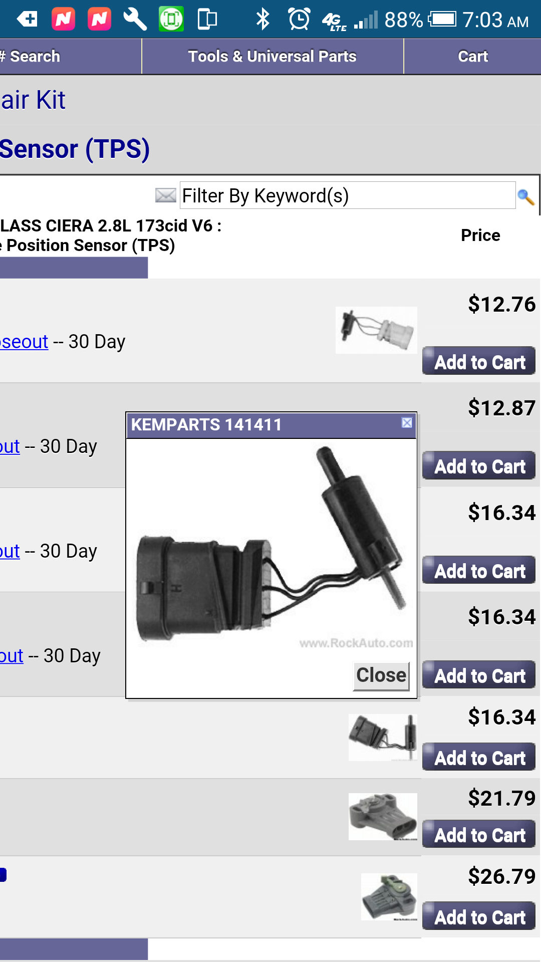

There's a picture of it.
Sep 10, 2016 at 7:06 AM
XCRIDER76
  • 5 POSTS
In that picture the one thats $21.79 is the one that shows fits my vehicle. Also i cant find it on the engine anywhere. I've researched all over and cant find pic of my car and same shape engine with it showing where tps is

That's the one that fits the one with a carb.Maybe it's missing?Have you had the car long?

Your goingvto have to sort all that stuff out.Someone probably removed the sensor and never put it back.Missing vacuum hoses can cause vacuum leaks and idle issues.
