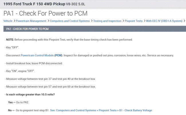

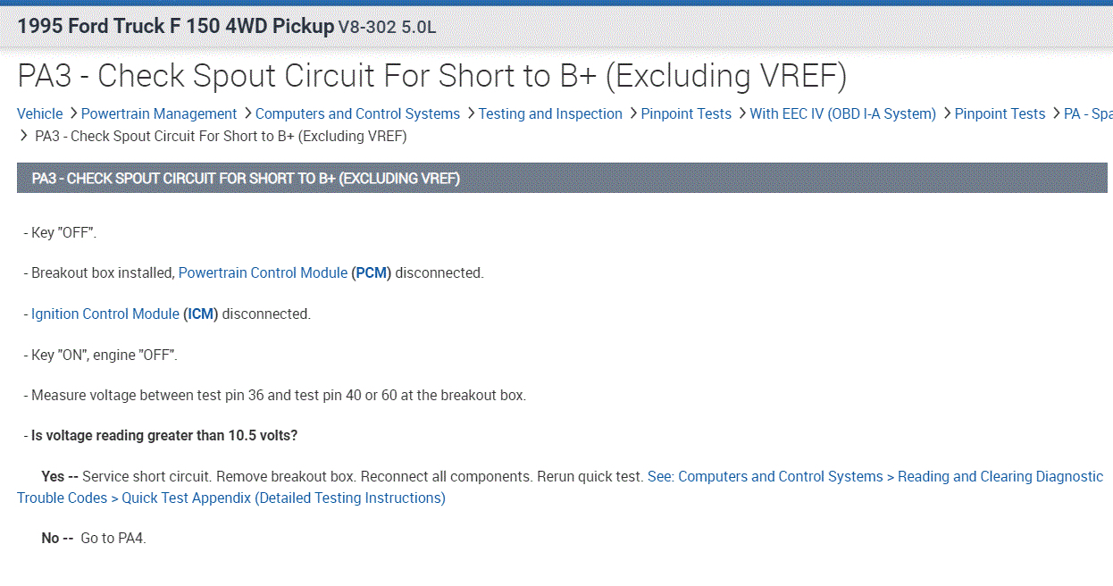

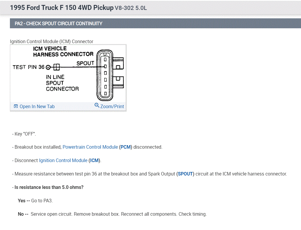

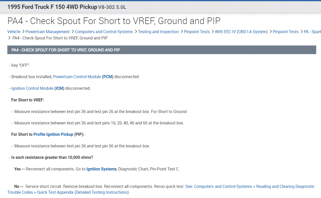

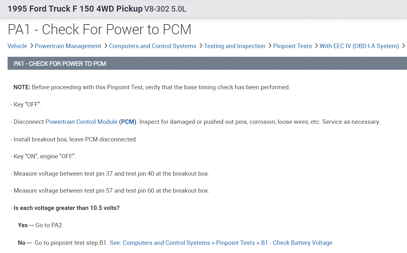

Based on the codes you provided, the one that stands out the most to cause this type of issue is the 213. That code is related to the ignition system, specifically the spout (SparkOutput). Since the vehicle runs good most of the time, chances are it is a connection issue. It could even be corrosion at the PCM or ignition control module.
To get started, I attached the first 4 steps in the diagnostics. Before you start, make sure the battery is fully charged.
Take a look through them and let me know if you are comfortable performing them.

Hey. Thanks, but I do not have a breakout box. Can I make one?

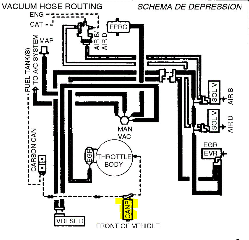

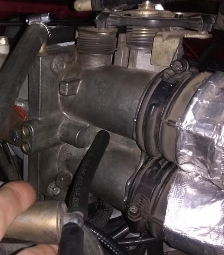

Hey Buddy, I think I know it comes from charcoal canister but what is it for? part in question is the solenoid? in picture.
Mar 9, 2022 at 3:52 AM
  • 110,240 POSTS
Yes, a vacuum leak can be causing issues. As far as the pic you attached, that appears to be the canister purge solenoid. It is located in the vapor line between the fuel vapor canister and throttle body.
Normally, that vent is closed. However, based on running conditions at any given time, the PCM determines when it is a good time for the engine to receive gas vapors from the canister. Then, the valve is opened allowing that to happen.
If you remove the vacuum hose from the canister which leads to the valve, there should be no vacuum when the engine is running. If there is, chances are the valve is stuck open.
See pic below.
Let me know if that helps.
Mar 9, 2022 at 5:56 AM

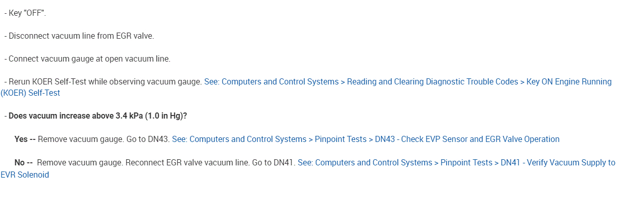

What do I need to do to troubleshoot the EGR? Many thanks.

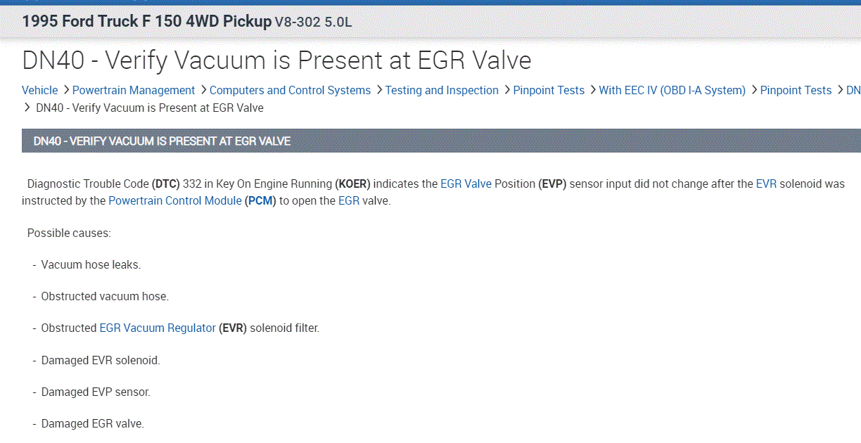

Now, 332 is related to the EGR. It indicates insufficient flow. So, it could be a carbon issue or the EGR isn't opening when the request is made.
Also, if you look below, I attached the directions for testing the EGR. The test I provided is step 1. I need to know the results of this test to know which direction to point you next. So, perform the test and let me know the results.
I will watch for your reply.
