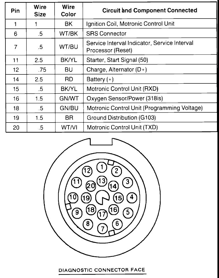

Obd 1 code?
1990 BMW 325I
174,000 MILES
YON KOPACZ
Could you please send me the correct pins in the diagnostic plug to retrieve the codes via the check engine light?
