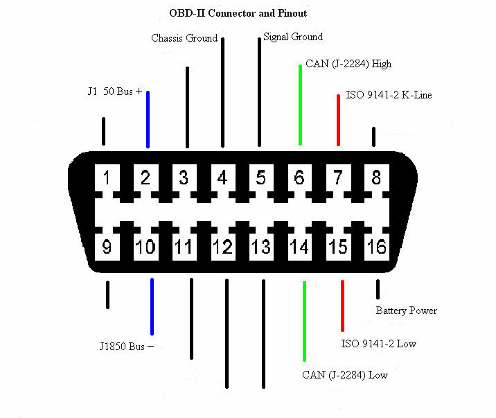

Scanner will not communicate.
Feb 26, 2018 at 10:30 PM
STEVE W.
  • 15,351 POSTS
Use a meter or test light to be sure you have battery voltage on pin 16 and ground at pins 4 and 5. If no power check the DLC fuse in the under hood fuse block. If you have power and ground then try a different scan tool or try the one you have on a different vehicle to verify it works. What is the issue you are trying to scan for?

Good to hear did you get the scanner to work? also, please try the scanner on a different car to confirm it works.
