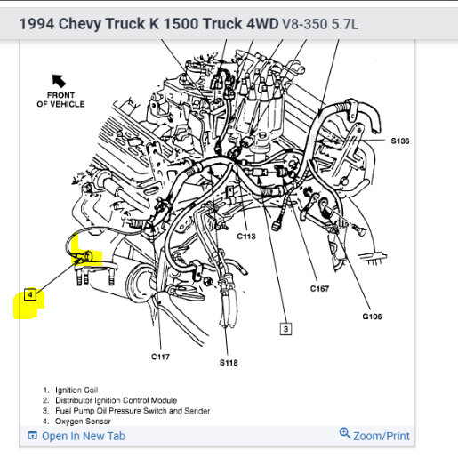

How many O2 sensors does this truck have, and where are they located?
1994 CHEVROLET 1500
221,000 MILES • 5.7L • V8 • 4WD • MANUAL
MIKEDOOM
  • 6 POSTS
Trying to get my 1994 f1500 Silverado to pass emissions. Runs well. Going to rebuild the injectors and O2 sensor. The problem is I've found the sensor just past the left side manifold and there's a plug in the hole just before the cat. Should I put the new O2 before cat or where it is now?
O2 wrong place. High HC's.
Oct 19, 2022 at 11:16 AM
  • 110,194 POSTS
There are a total of two sensors. One is upstream and the other downstream. The upstream is located at the end of the left exhaust manifold. See pic 1.

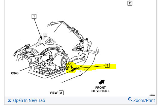

The downstream is next to the right side of the transmission where the Y pipe ends. See pic 2 below.
Are these the ones you are asking about?

Jacobandnickolas, they are but the one at the y is plugged and there's no connector for an O2 there. I've been told the 94 only has one on the left side. My problem is still high HC at idle. I've replaced about everything and it keeps getting worse. I've replaced TPS, ICS, EGR solenoid, air filter, distributor, cap, rotor, wires, spark plugs, coil, set timing to 0 with spark wire unplugged. Rebuilt TBI and had injectors serviced replaced vacuum lines can't find any leaks replaced O2 non-heated sensor. (May have done a couple of others but can't recall right now) just remembered did PVC and replaced gas cap. I've done three tests at idle they started at 302 replaced things then went to 404 replaced to where I am now and today, they measured 532 the max is 220 the high RPMs went up then down but are way under the 220 limit at 102. Not showing any error codes, I've been working on vehicles for a long time and have run out of things to try. Just rebuilt lower end new rings etcetera replaced thermostat when put back together. The truck is running fine no misfires, starts right up no missed through gears, could spin out if I could afford the tires, vacuum reads 17. The mechanic at the emissions said the truck was running great. Any help or suggestions would be greatly appreciated. Mike D.
