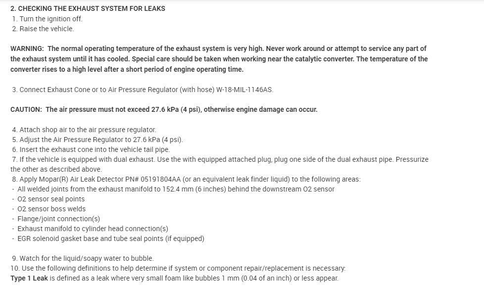

As for an exhaust leak, I tried to check, but just by ear. Any suggestions on a better method?

As far as the exhaust leak is concerned, it could simply sound like ticking. Also, when you check for vacuum leaks, try using carb cleaner to see if the RPMs change at any point.

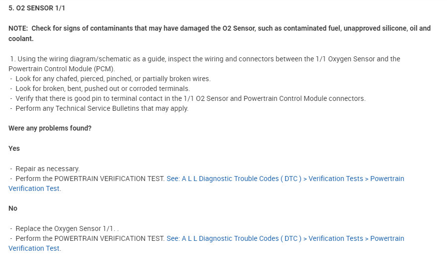

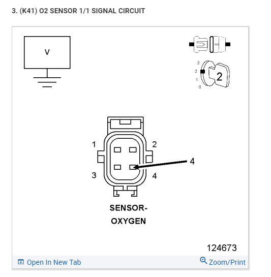

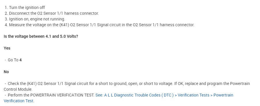

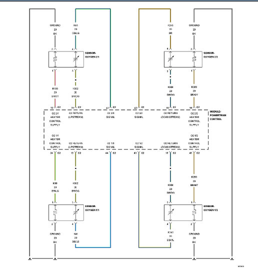

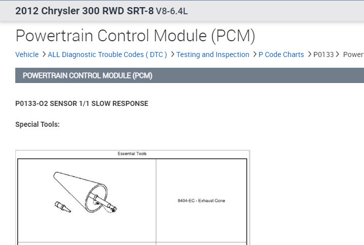

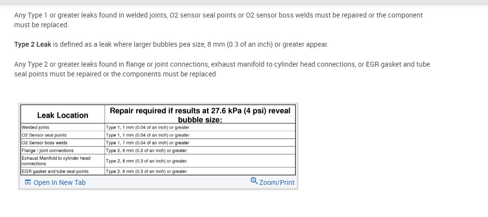

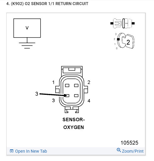

The condensation, to a degree, is normal in the exhaust. As far as the slow response, it could be a connector issue or a wiring issue.

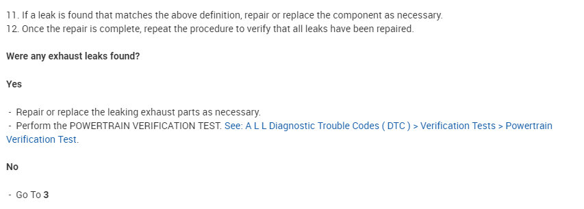

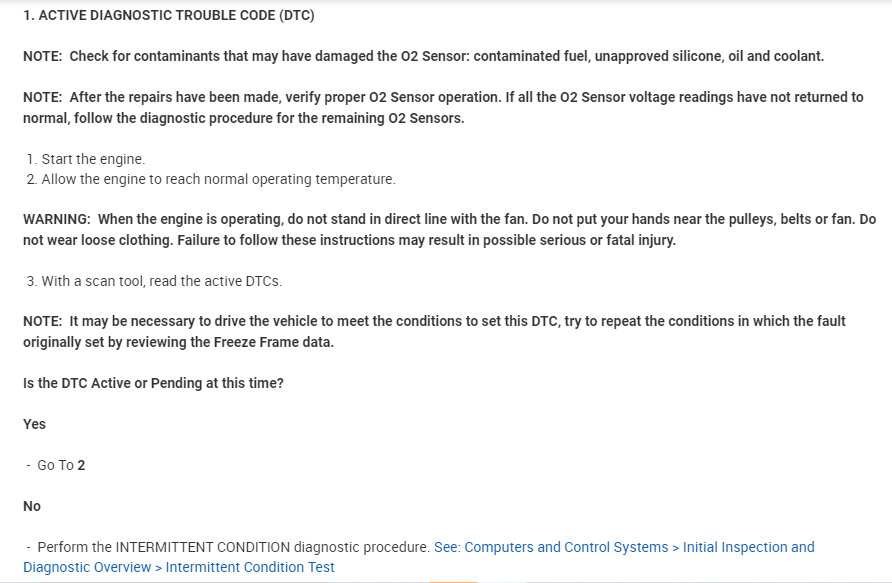

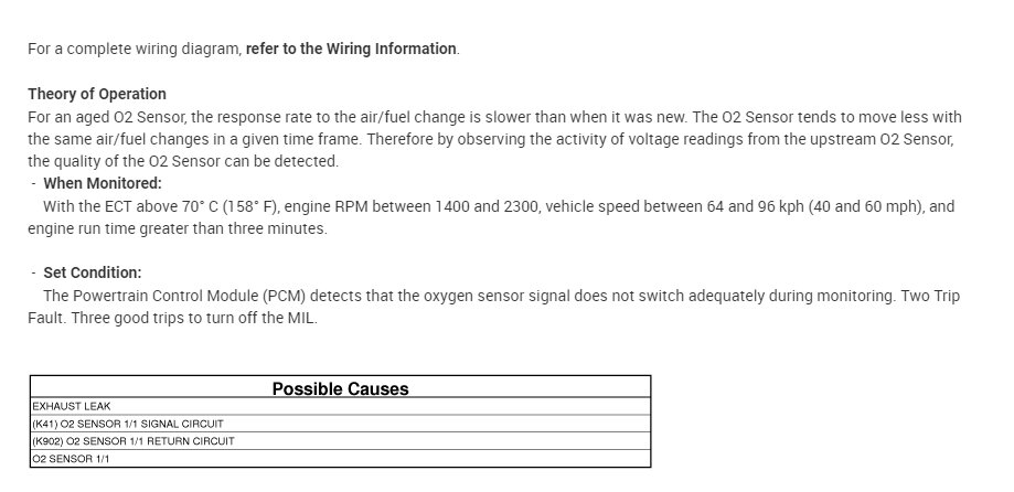

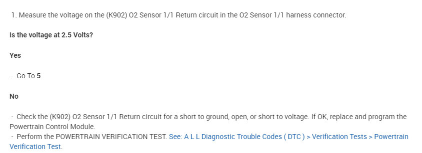

Do me a favor. Take a look at the diagnostics that I attached below and let me know if you are comfortable performing them. Some have already been completed.

I think I can perform most of that , except for the exhaust leak test. I'm a mobile tech , and I am limited in specialty equipment.

So, it turns out the muffler shop that originally replaced the cat swapped the leads on the O2 sensors, so the upstream sensor was in the downstream position
After putting them back in order, O2 sensor voltage readings starting to look more normal, no more slow response or out of whack numbers
