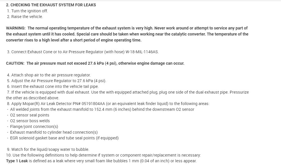

As for an exhaust leak, I tried to check, but just by ear. Any suggestions on a better method?
Thanks again.
Feb 22, 2023 at 2:02 PM
  • 110,236 POSTS
As far as the exhaust leak is concerned, it could simply sound like ticking. Also, when you check for vacuum leaks, try using carb cleaner to see if the RPMs change at any point.

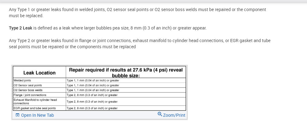

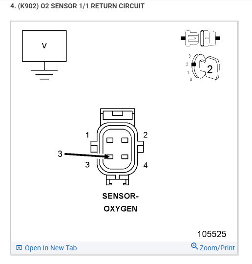

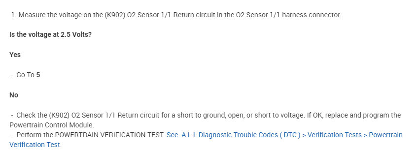

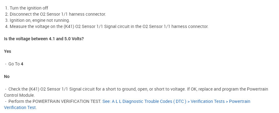

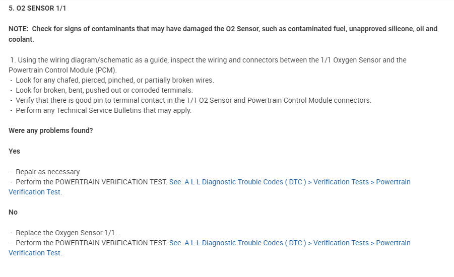

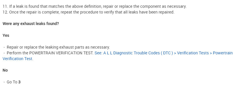

  • 110,236 POSTS
The condensation, to a degree, is normal in the exhaust. As far as the slow response, it could be a connector issue or a wiring issue.

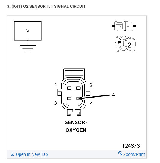

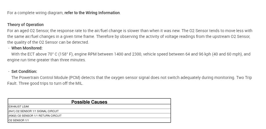

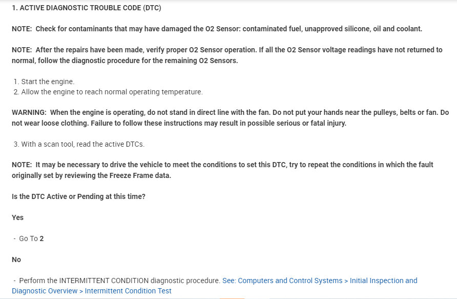

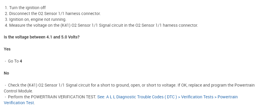

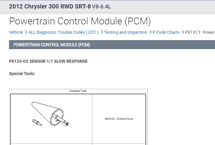

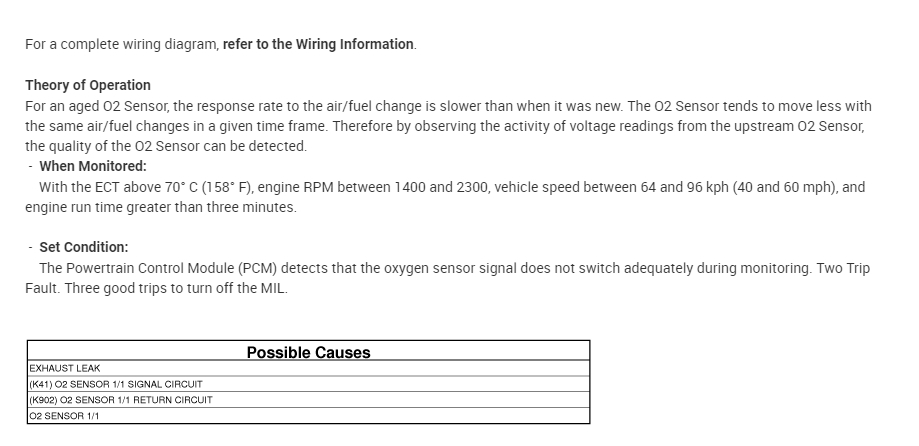

Do me a favor. Take a look at the diagnostics that I attached below and let me know if you are comfortable performing them. Some have already been completed.
Feb 24, 2023 at 1:18 PM
TOTALMC
  • 117 POSTS
Okay, thanks.
I think I can perform most of that , except for the exhaust leak test. I'm a mobile tech , and I am limited in specialty equipment.
Feb 24, 2023 at 1:55 PM
  • 110,236 POSTS
Sounds good. If you have a chance, let me know what you find.

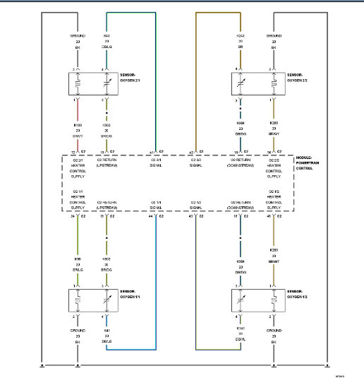

So, it turns out the muffler shop that originally replaced the cat swapped the leads on the O2 sensors, so the upstream sensor was in the downstream position
After putting them back in order, O2 sensor voltage readings starting to look more normal, no more slow response or out of whack numbers
STFT's still get a little high at 2,500 RPMs, they get up into the teens, but they were moving into the 30's.
Fixed a small vacuum leak I found in whatever the finger thickness pipe that runs along the top of the manifold is, but I thought a vacuum leak supposed to go away as you increase RPMs, so I'm not sure if the high fuel trim numbers are something else or not.
After a drive cycle the vehicle was able to pass smog, so that's the main concern.
Feb 27, 2023 at 5:26 AM
  • 110,236 POSTS
Wow, that will certainly do it. I'm glad you got it taken care of and passed smog. Thanks for the update.
