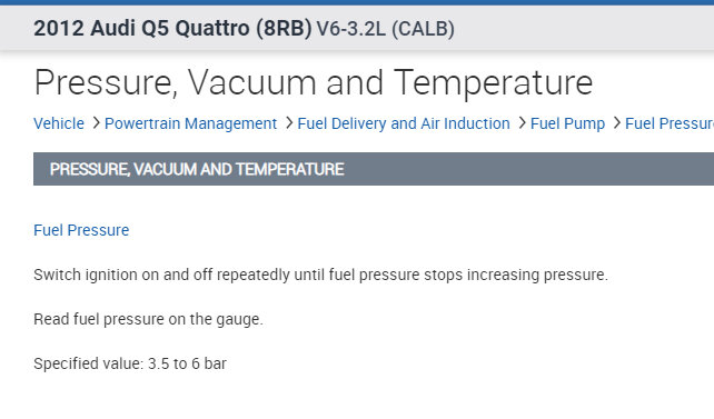

Last, the idea that you have a rich fuel mixture on both banks could simply be the result of a faulty fuel pressure regulator. Has that been checked? If not, here is a link that explains how to check fuel pressure. You will need a gauge, but most parts stores will lend one to you.
I attached the manufacturer's fuel pressure specifications below for you.
Let me know what you find.
joe
See pic below.
