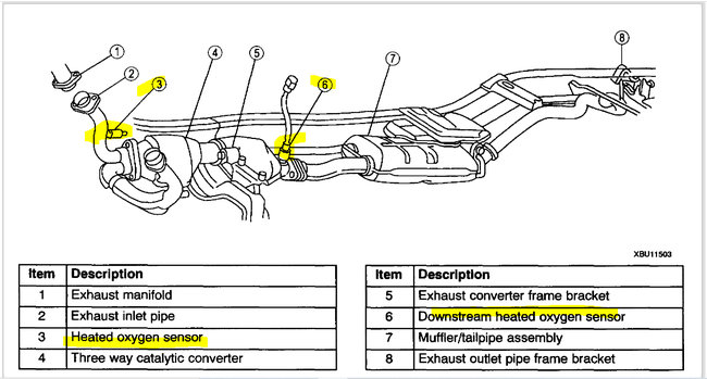

I attached an exploded view of the entire exhaust system below. From what I am seeing and reading, there are two. One is upstream from the converter and the other is right after it.
Take a look and let me know if that helps.
See pic below.
