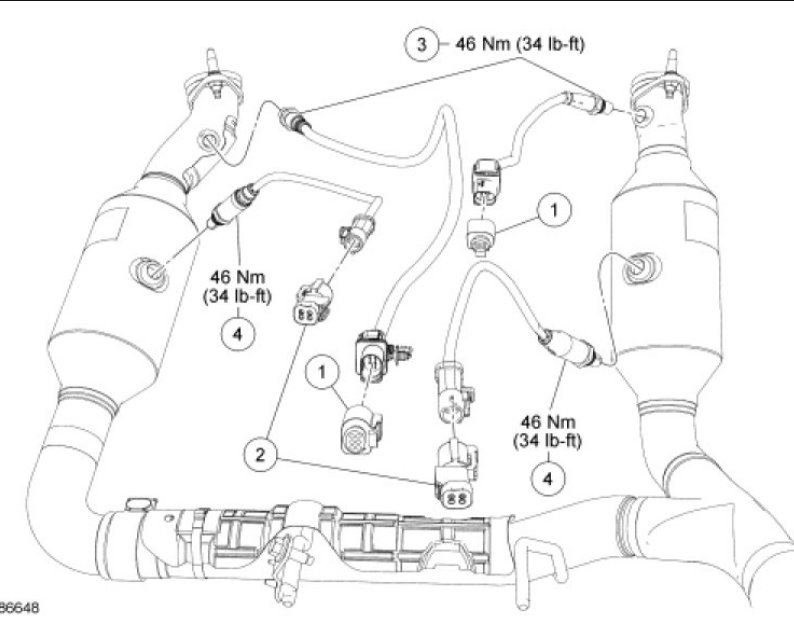

the O2 sensor can be read using live data feed, if it is not working with in the required voltage it should be replaced. failed o2 sensors will increase fuel economy. Here is how you can change the sensors and their location as well in the diagrams below but check out this guide first
https://www.2carpros.com/articles/how-to-replace-an-oxygen-sensor
and
https://www.2carpros.com/articles/how-to-test-an-oxygen-sensor-02-sensor
Please run down these guides and report back. The secondary sensors are thein the catalytic converters. Check out the diagrams (Below). Please let us know what happens.

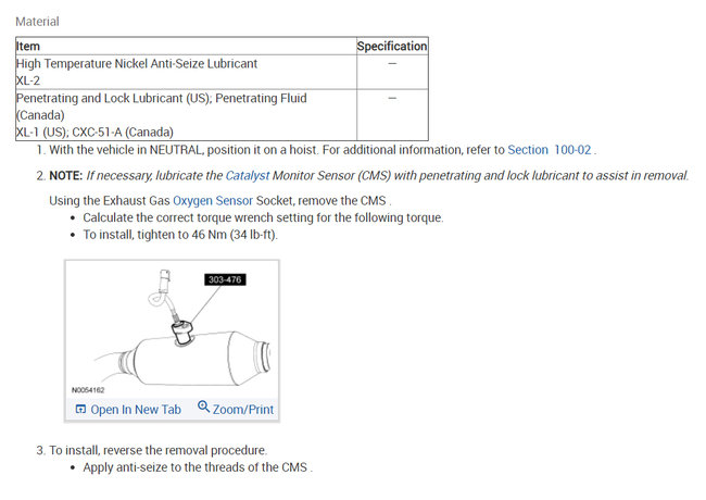

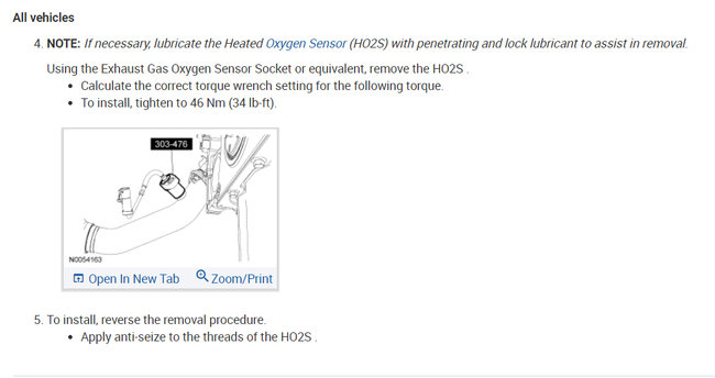

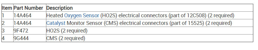

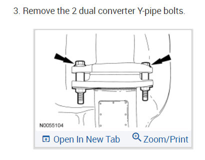

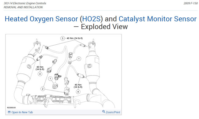

It's showing four sensors in total. Two are pre-catalytic converter and the other two are mounted in the converters. I've attached a picture below. Here is a tutorial showing how to replace Ho2 sensors:
https://www.2carpros.com/articles/how-an-oxygen-sensor-works
Hope this helps and thanks for using 2CarPros.

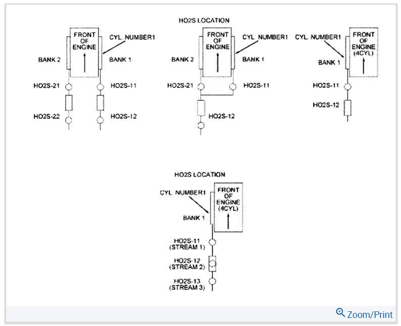

Where is the location of the heated oxygen sensor Bank 1 Sensor 1. Is it on the drivers or passenger side of my 2006 F150 5.4l v8?
Sep 10, 2020 at 11:07 AM (Merged)
  • 75,988 POSTS

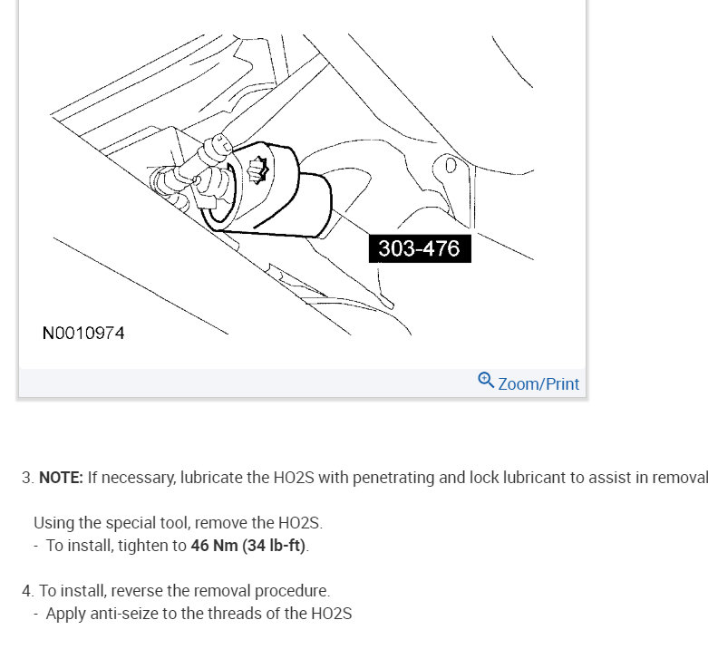

Here is a guide to help you see what you are in for when changing the sensors out and the location of the sensors in your truck below.

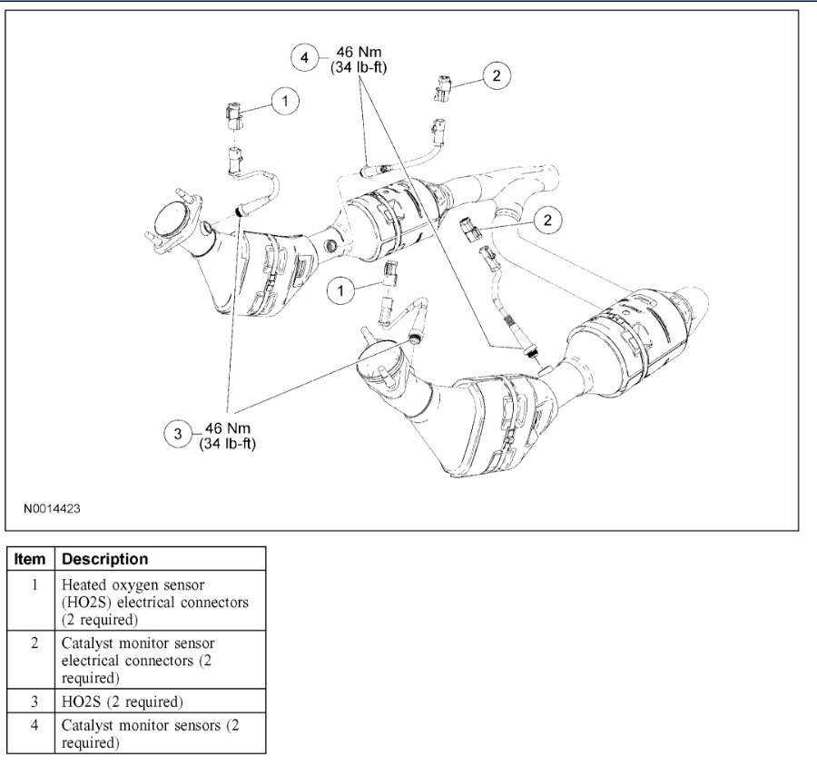

2003 F150 4.6l V8 - How many and where are the O2 sensor located. If my engine light came on do I need to change both of them? I got codes 0171 & 0174 when it was tested.
Sep 10, 2020 at 11:09 AM (Merged)
WRENCHTECH
  • 20,758 POSTS
No, that is not bad sensors causing that problem. It is your engine running too lean for some reason and that's what you need to find. Look at fuel pressure, vacuum leaks, MAF and other things that effect fuel pressure.

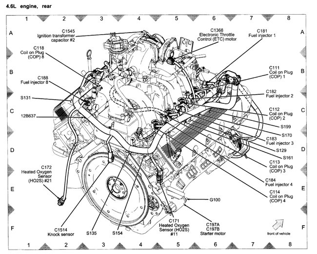

  • 48,601 POSTS
there are four, but re-scan as it should say which one it is probably the one before converter though. make sure not air or vacuum leaks though as the manifold may still be leaking vacuum.
