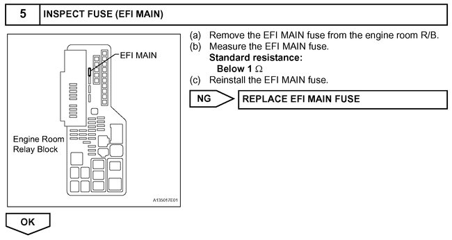

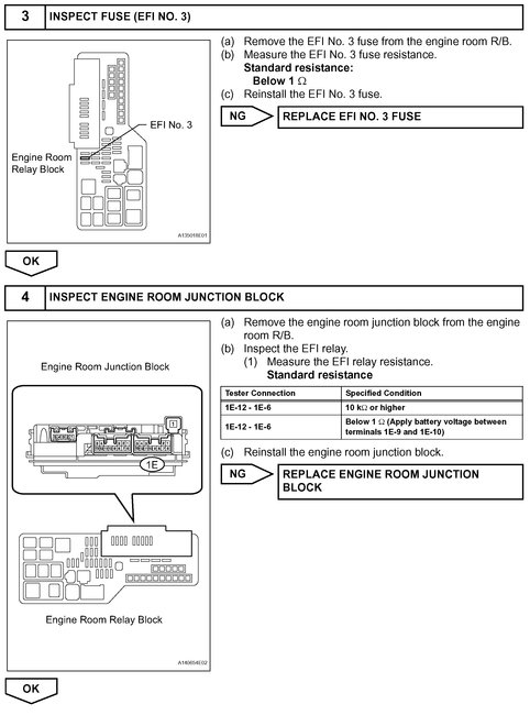

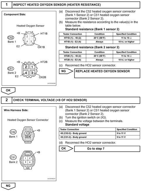

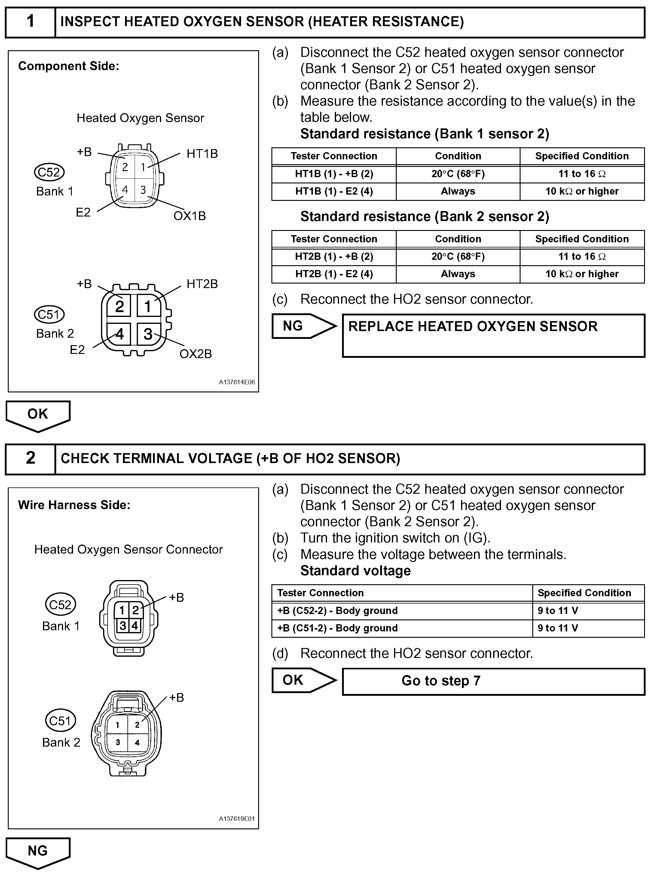

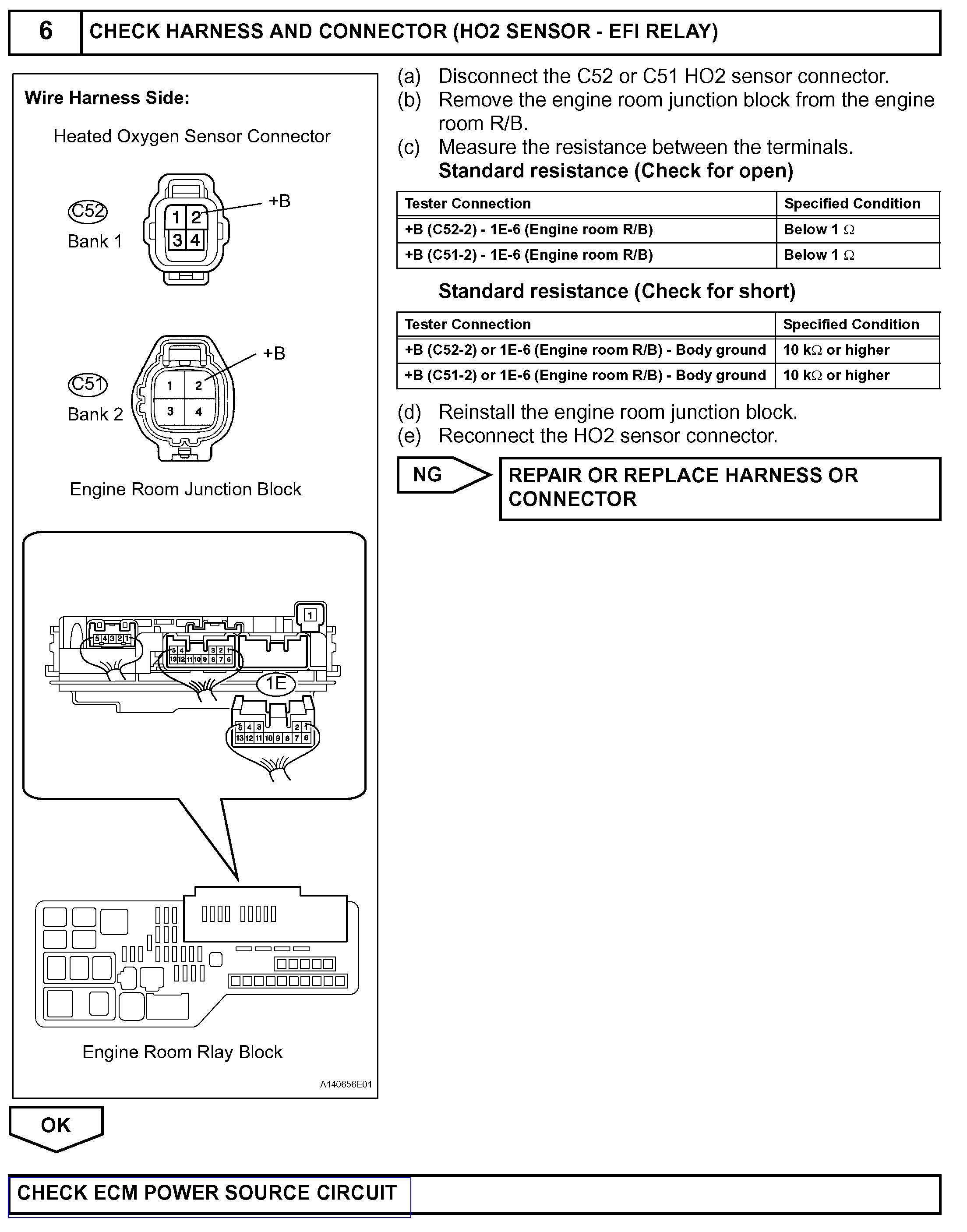

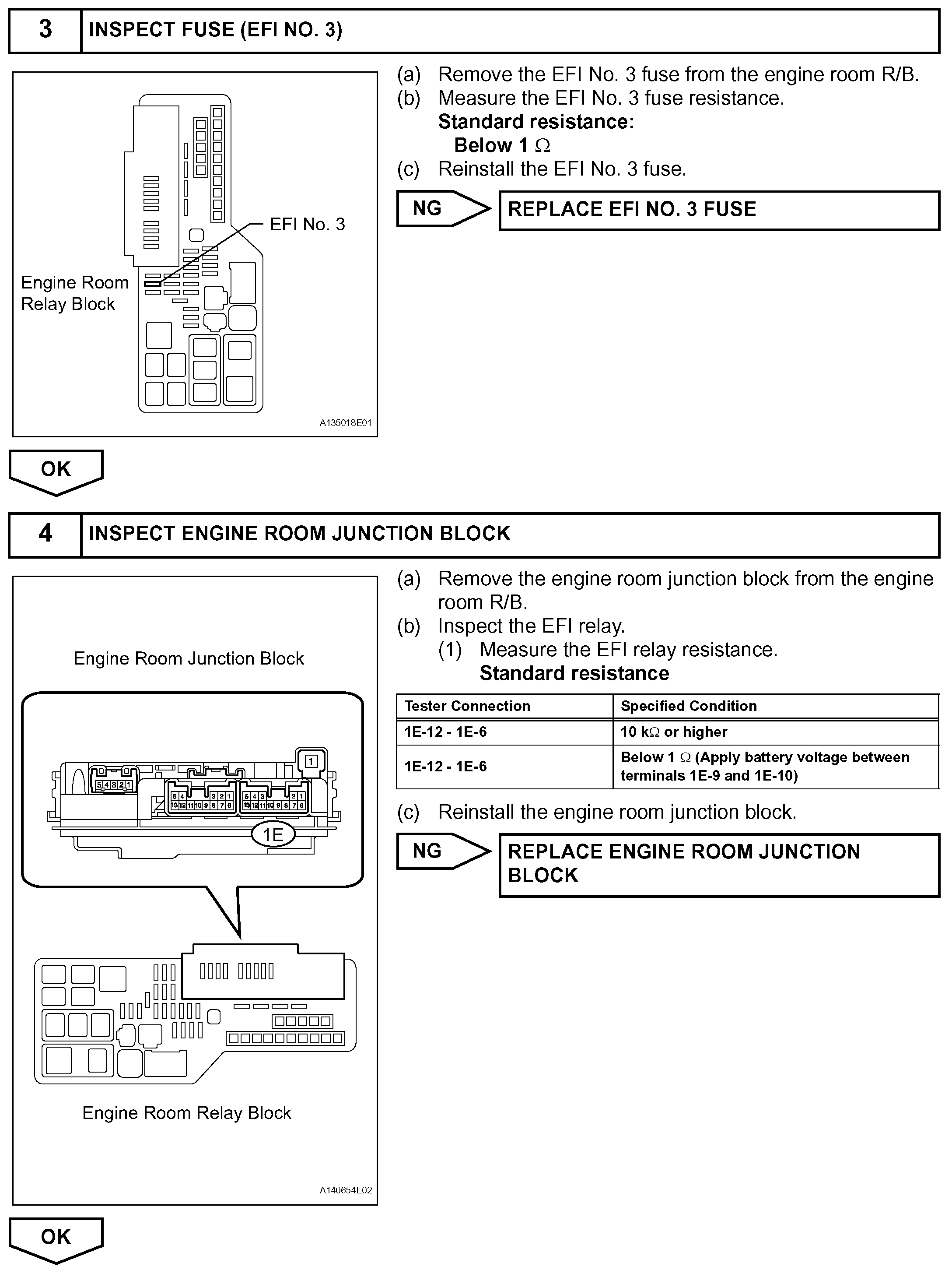

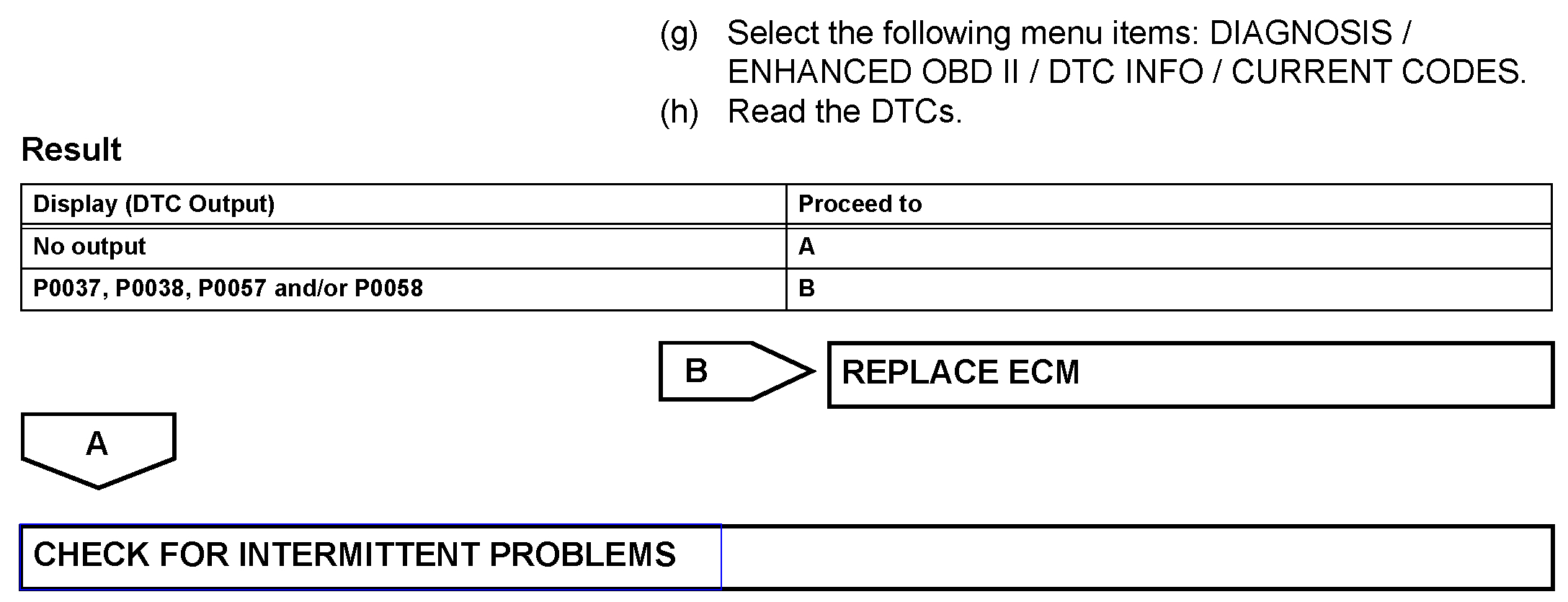

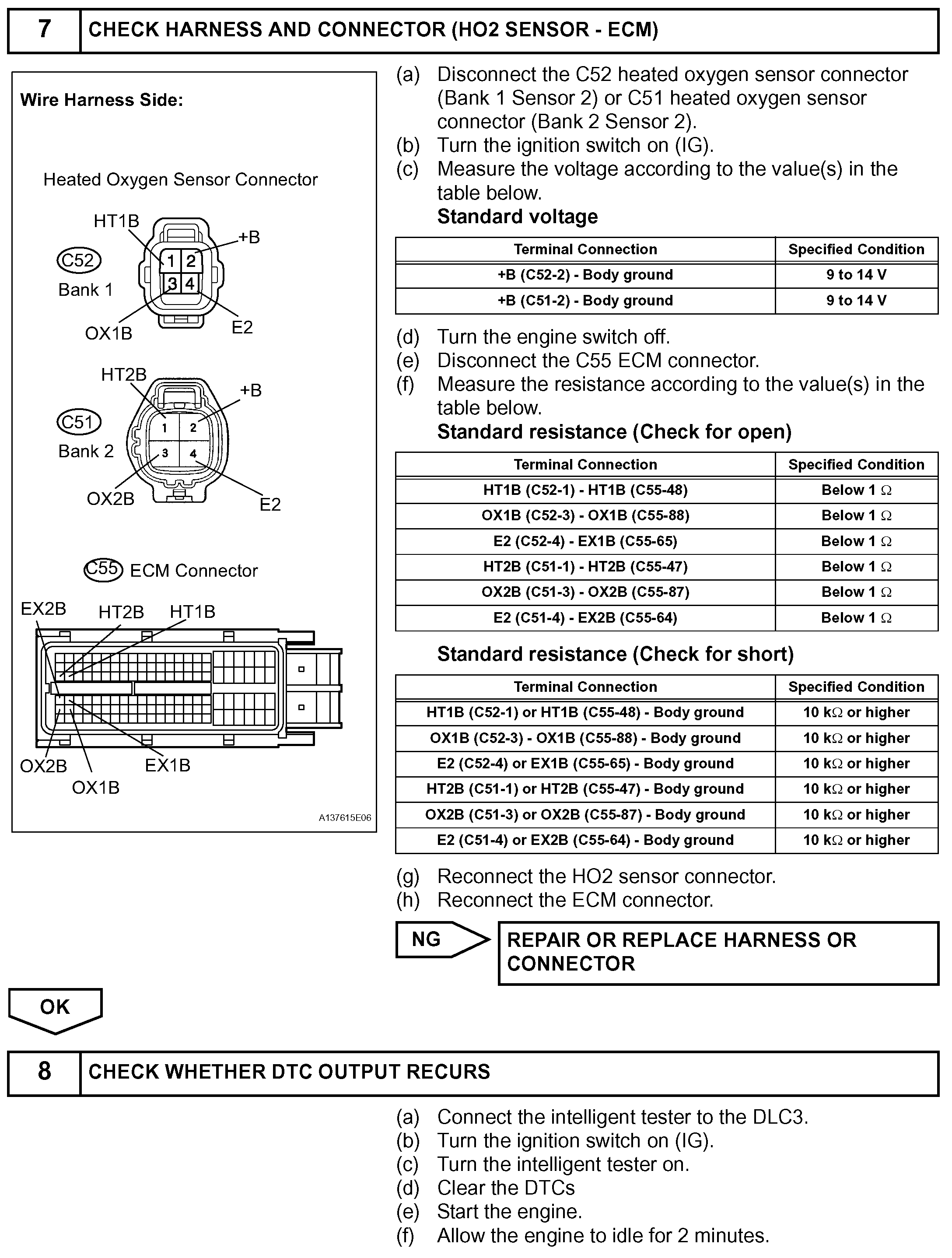

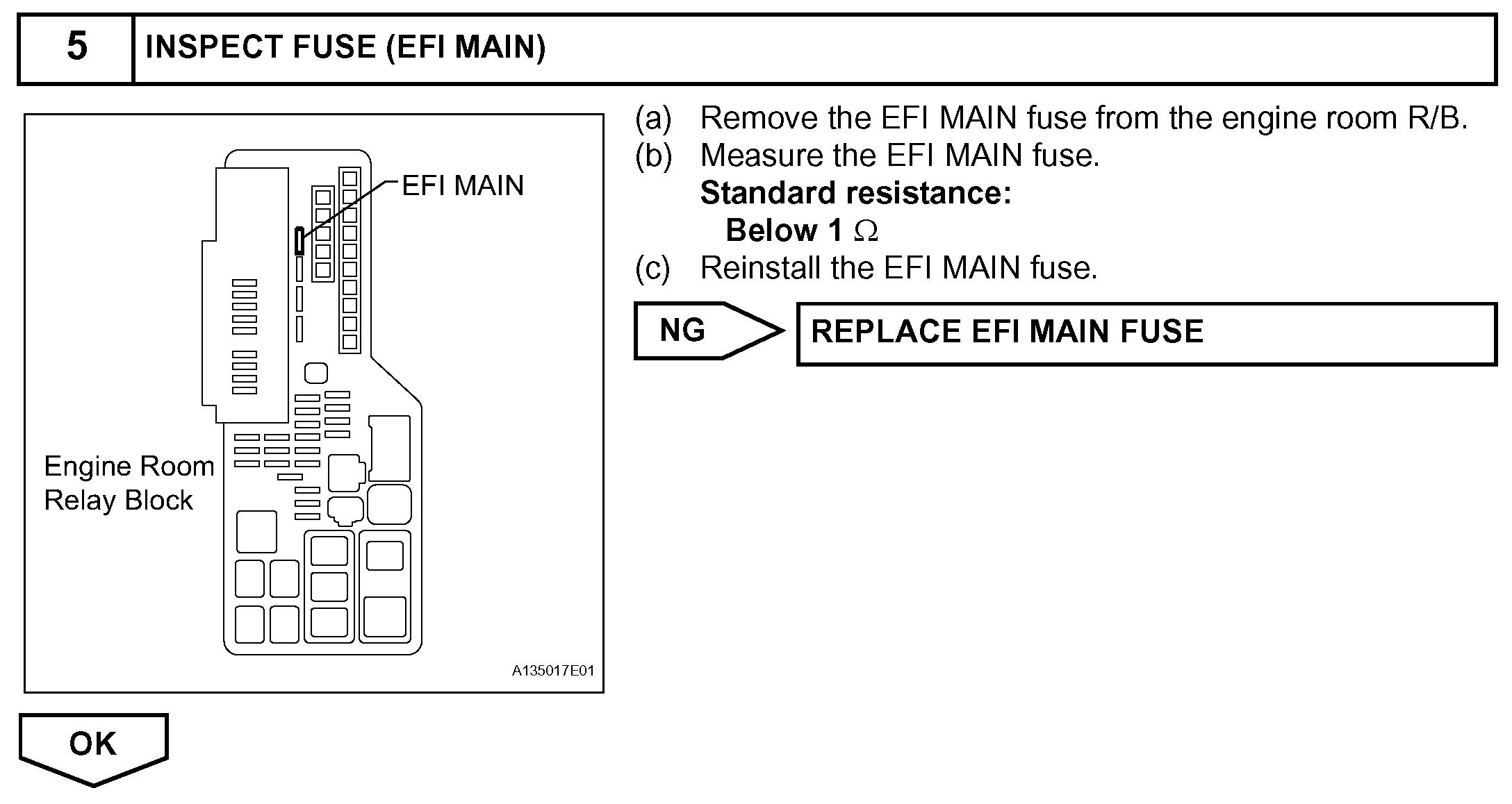

check engine light came on, code P0057, downstream b2 s2. removed sensor and replaced with a OEM part and reset lights. after about 25 - 35 miles lights came back on, same code.
compared both sensors (old and new) and they were identical.
what else could be causing the codes?
Jul 1, 2019 at 2:30 PM
  • 110,240 POSTS
Welcome to 2CarPros.
The condition you have is related to a voltage issue. The first thing I suggest is having the battery load tested to confirm that isn't an issue. If the battery is good, I attached a few pics below which contain a flow chart of checks related to the code. It will require some electrical testing. Here are a few links to help:
Let me know if that helps or if you have other questions.
