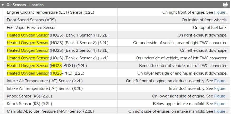

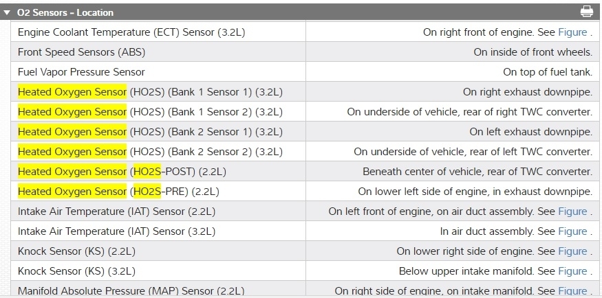

How many and where in my car? It is the sport model. Anyone know? Ha, I know you do.

Saw 3.2 L and 2.2 liter
The 2.2 liter locations are the last two highlighted ones listed.
This is an excerpt from "Prodemand"
Click on diagram below.
Sorry, I was unable to find an actual diagram for you. (Note: no "figure" to the right, as with others).
The Medic
Image (Click to make bigger)
