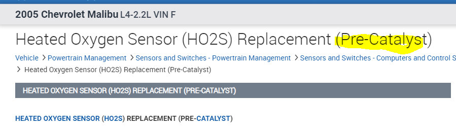

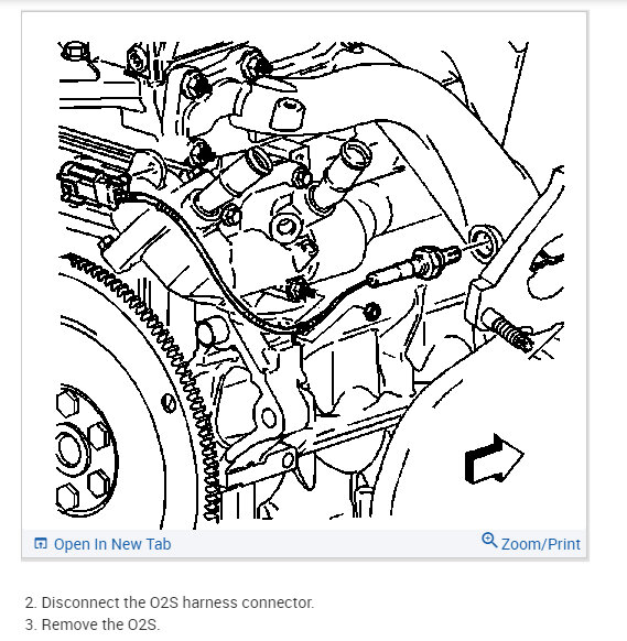

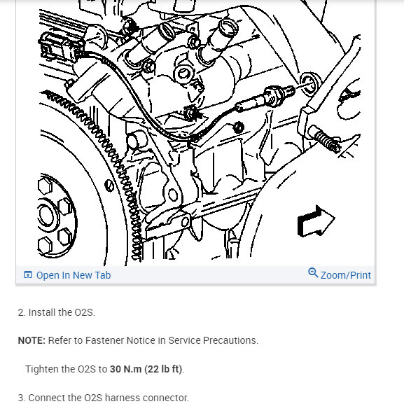

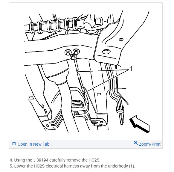

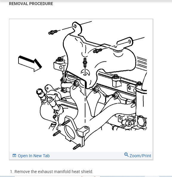

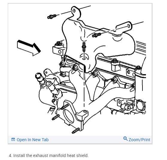

Can someone show me a detailed diagram of the upstream and downstream O2 sensors and where they plug in after installation?
Nov 8, 2023 at 8:39 AM
  • 110,194 POSTS
There are two sensors. One is a pre-catalytic converter sensor (upstream) and the other is a post-catalytic converter sensor (downstream).

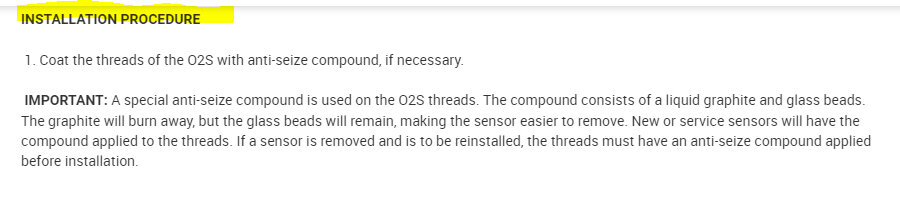

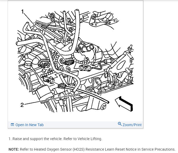

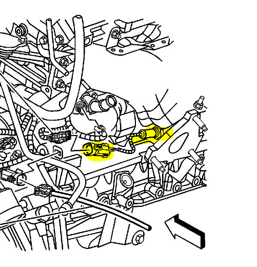

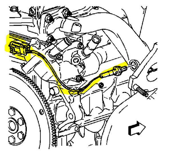

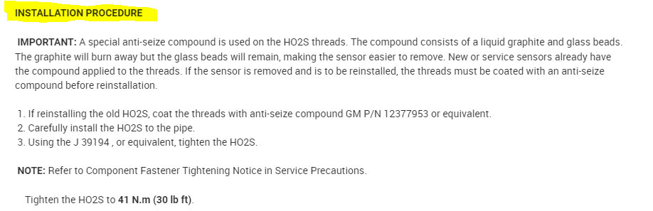

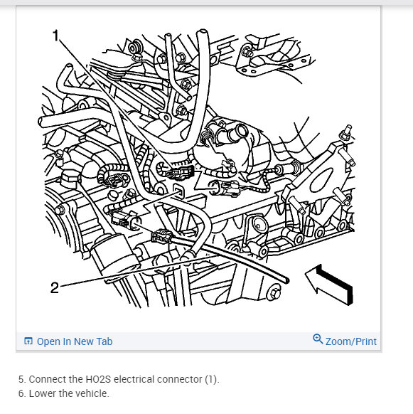

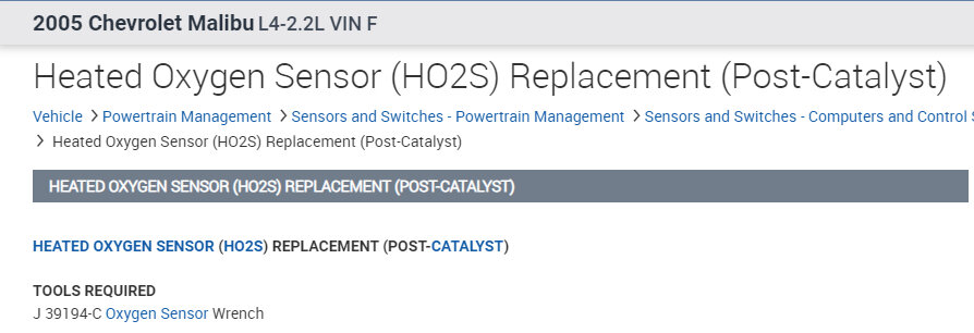

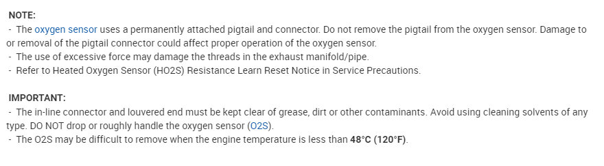

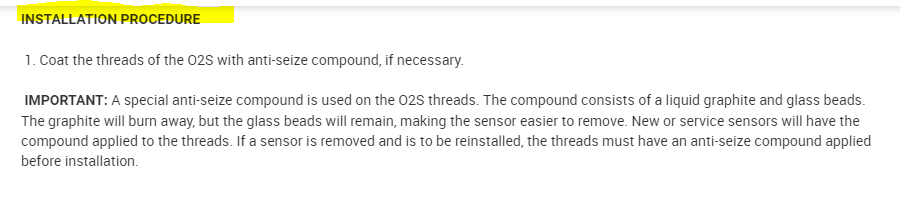

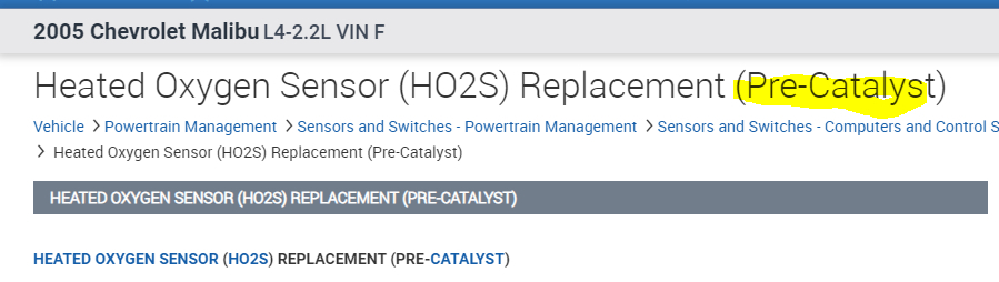

If you look at pic 1 below, I highlighted the upstream sensor and connector location. Note that the sensor is in the exhaust manifold and requires the removal of the exhaust manifold heat shield. Pics 2-7 are the directions for removing and replacing the upstream sensor.

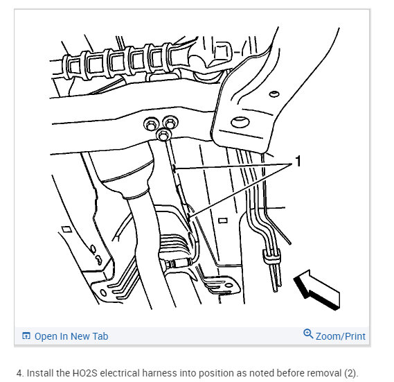

If you look at pic 8 below, I highlighted the downstream sensor and connector. The remaining pictures are directions for the removal and installation of the downstream sensor.
