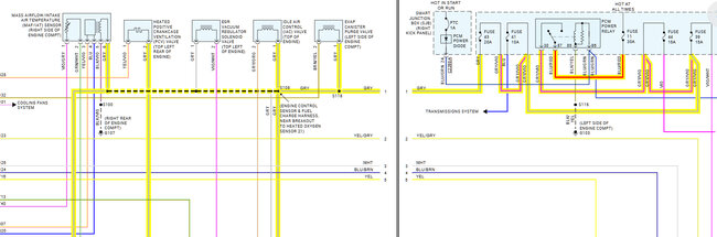

I have no voltage going to my o2 sensor bank 1 sensor 1.
Sep 8, 2025 at 4:45 PM
AL514
  • 5,662 POSTS

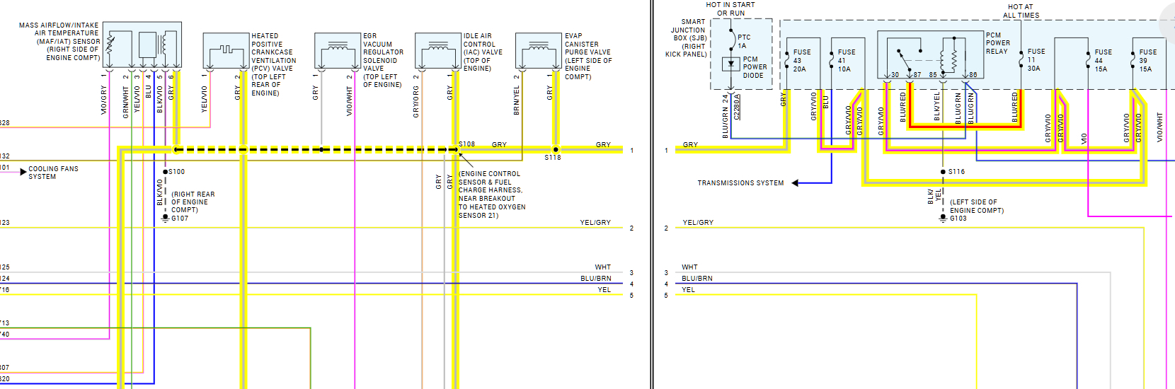

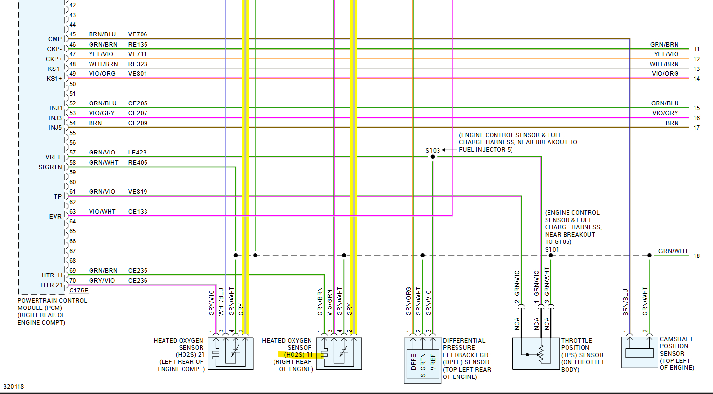

Hello, I assume you are referring to the heater circuit for the B1S1? Its the grey wire at the harness sensor plug.
Sep 9, 2025 at 10:07 AM
AL514
  • 5,662 POSTS
This grey wire is the power feed for the oxygen sensor heaters, and the 2nd diagram shows where the power originates from, but you would be missing power for a bunch of other actuators as you can see if it was a fuse issue. So it sounds like there is a break in the Grey wire somewhere in between the sensor and the smart junction box behind the passenger side kick panel.
