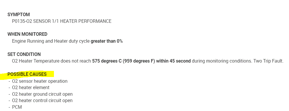

O2 Sensor replaced with new, and light comes back on, reset error coded PO135 keeps coming back?
Dec 30, 2021 at 2:55 PM
  • 110,244 POSTS

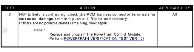

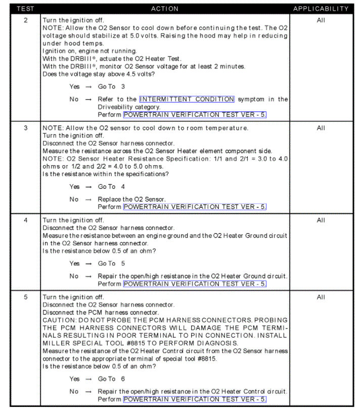

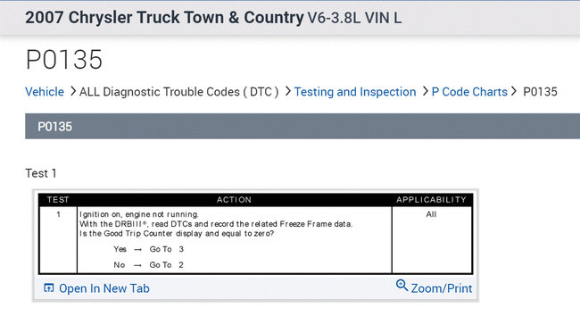

If the sensor is new, chances are it is a wiring issue. By chance, do you have a live data scan tool? If you do, check the voltage signals from the involved O2 sensor and let me know what you are seeing. The code indicates the heated component in the sensor doesn't reach 959F within 45 seconds, so chances are it isn't powering.
Also, if you look below, I attached the diagnostics for this code. Take a look through them and let me know if you are comfortable performing them.
