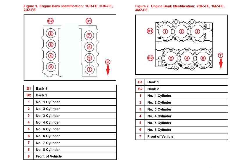

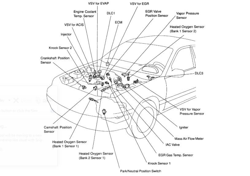

I purchased the car from a guy in California and I believe this car has 2 O2 sensors and 2 Air Fuel Sensors following California emissions requirements.
How can this be confirmed?

Good evening,
You can look at the emission tag under the hood. It is a white tag. It will say either it is federal or California emissions.
Get OEM sensors. Aftermarkets are not exact and can effect the way it runs.
