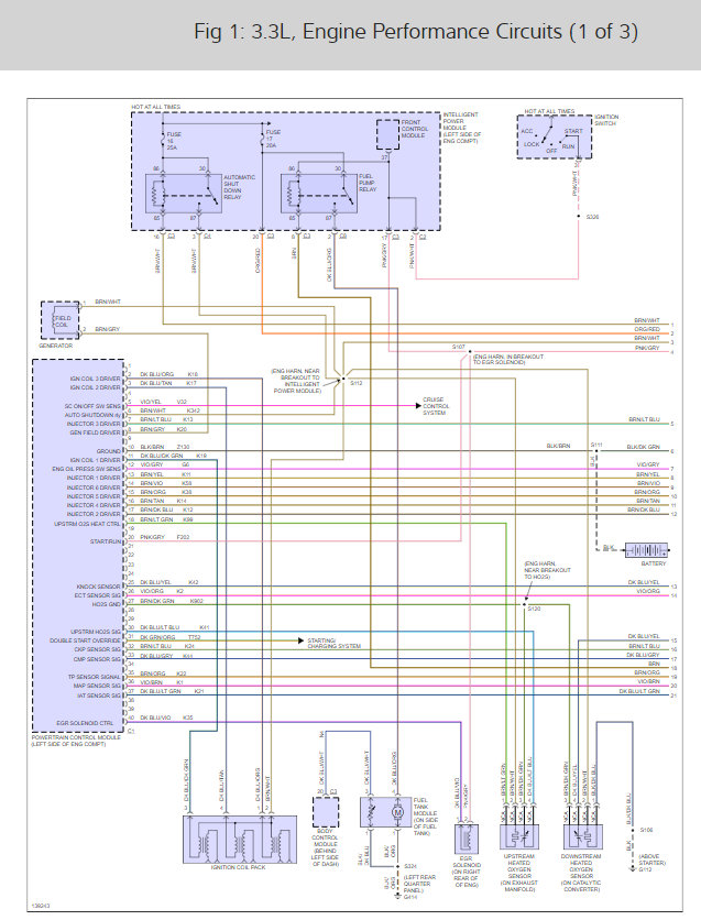

Already three sensors are replaced in the van after a run of 500-1,000 miles each. Error code P0135 appears.
When checking the sensor heater, the ohmmeter shows an open cirсuit!
The sensors are Mopar 04686938AB and Denso.
Please help me to understand the problem.
Usually the "CE" was lit at the gas station, after turning off the engine for five minutes.

The 135 code is for the Bank 1 or upstream O2 sensor heater circuit. the code tells you the area of failure not the part failure.
I listed below a description and possible cause for the code. It could be wiring issue, harness damage connector damage or a failing PCM.
you would need a advanced scan tool to monitor the heater operation of the sensor to determine if the heater is falling out.
check the harness for the sensor and be sure it is not laying on anything hot causing melting or damaging wires.

I wonder why the heater burns out in all sensors.
I will test by the lamp applying voltage to the heater.
Should it be turned off when the engine warms up?
Is heater controlled by PWM from PCM?
Apr 24, 2018 at 11:22 PM
Not saying the heater is burned out at all. check the resistance of the heater portion from all the ones you had to a new one. my bet is they are all the same.
yes, it is pulse width modulated by the PCM.
no, it stays on while the engine is running. it needs to keep the sensor hot so the signal is accurate going to the PCM.

I checked the heater resistance before sensor installation.
The new sensor has a heater resistance 2.6 ohms.

Since they keep burning out it sounds like you have a bad ground for that sensor which will cause high resistance across the sensor.
Here is a guide to help you run the test to confirm the issue:
