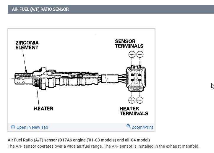

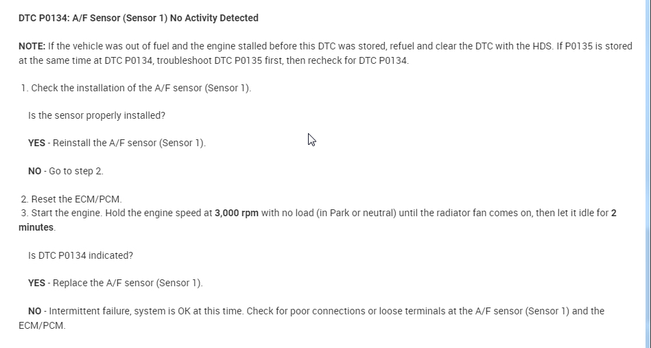

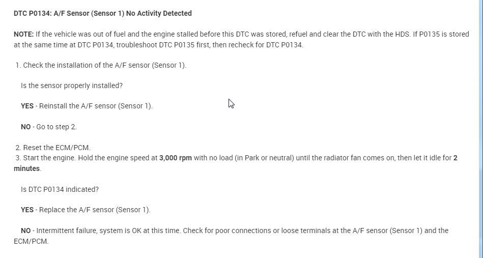

My car is showing (no activity detected bank 1 ). What does this mean? I have change my sensor twice.
Tuesday, June 30th, 2020 AT 4:30 PM
MECHANIC
18,907 POSTS
I attached the testing for this code. Basically it is saying that the sensor is installed wrong or you have a connection issue at the PCM.
Run through this testing and see what turns up. Thanks
