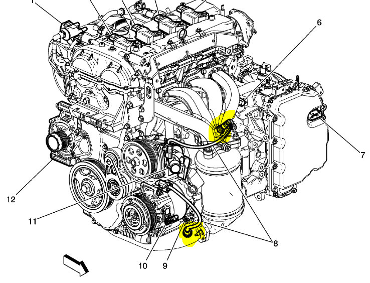

My CEL is on, and I believe it to be bank 1 O2 sensor. I would like to change all the O2 sensors, could you tell me how many there are and the location? Thank you

The one in the exhaust manifold will be bank 1 sensor 1. Below the catalytic converter is bank 1 sensor 2. (See pic below).
Here is a guide to help you change the sensor out step by step with diagrams below to show you on your car:
https://www.2carpros.com/articles/how-to-replace-an-oxygen-sensor
Please let me know if you need anything else to get the problem fixed.
See pic below.
