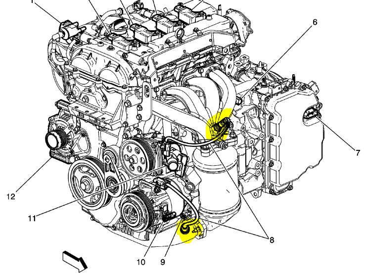

My CEL is on, and I believe it to be bank 1 O2 sensor. I would like to change all the O2 sensors, could you tell me how many there are and the location? Thank you
Jul 28, 2023 at 6:42 AM
  • 110,244 POSTS
The one in the exhaust manifold will be bank 1 sensor 1. Below the catalytic converter is bank 1 sensor 2. (See pic below).

See pic below.
