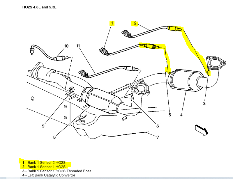

Help! Need to replace O2 sensors for bank1 sensor1 and bank1 sensor2. Needing locations and to know part numbers if needed? Please and thank you for all ya'll do!

Bank 1 on the engine is on the driver's side of the vehicle. If you look below, I highlighted where bank 1 sensor 1, and sensor 2 are located.

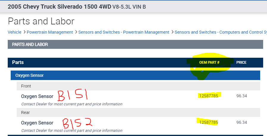

Pic two shows the manufacturer's part numbers.
