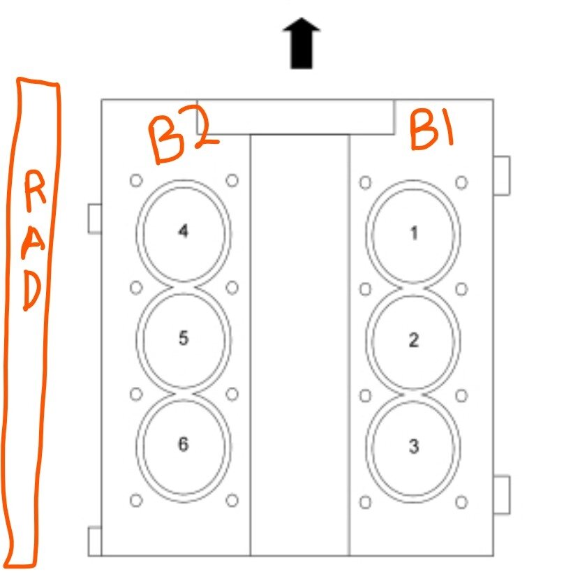

Hi I'm getting a p0131 code. Bank 1 sensor 1 i replaced the one in the front by the radiator but i believe it's the other sensor but having trouble finding it. There's not much online. Thank you

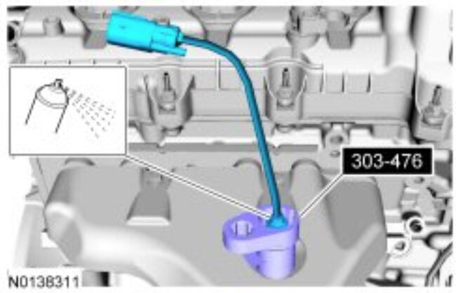

P0131 is a Bank 1 Sensor 1 circuit code. Basically, says that the sensor is showing a grounded state. The sensor you replaced would have been the left or bank two sensor. The bank 1 sensor is on the firewall side in the top of the exhaust manifold. It gets torqued to 35 lb-ft.
