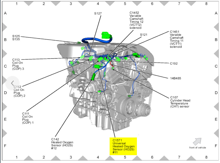

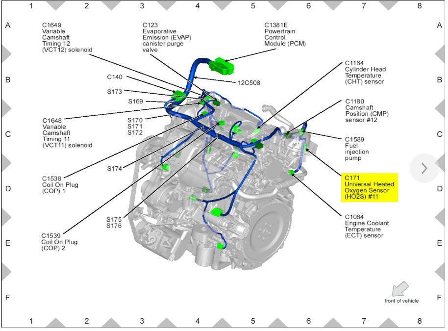

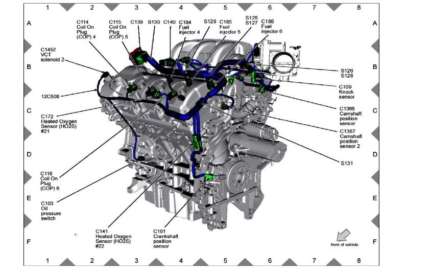

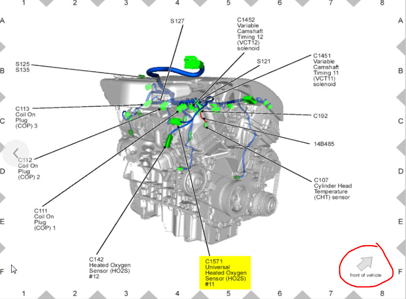

Got a P0131 error code recently for a bad O2 sensor in the bank 1 sensor 1 location. I've seen lots of videos of locations for the V6 3.5L engine, but I can't find anything on the location for a V4 2.0L Ecoboost engine on a 2012 Edge. Anyone have a drawing or video that might show where this thing is? Thanks!

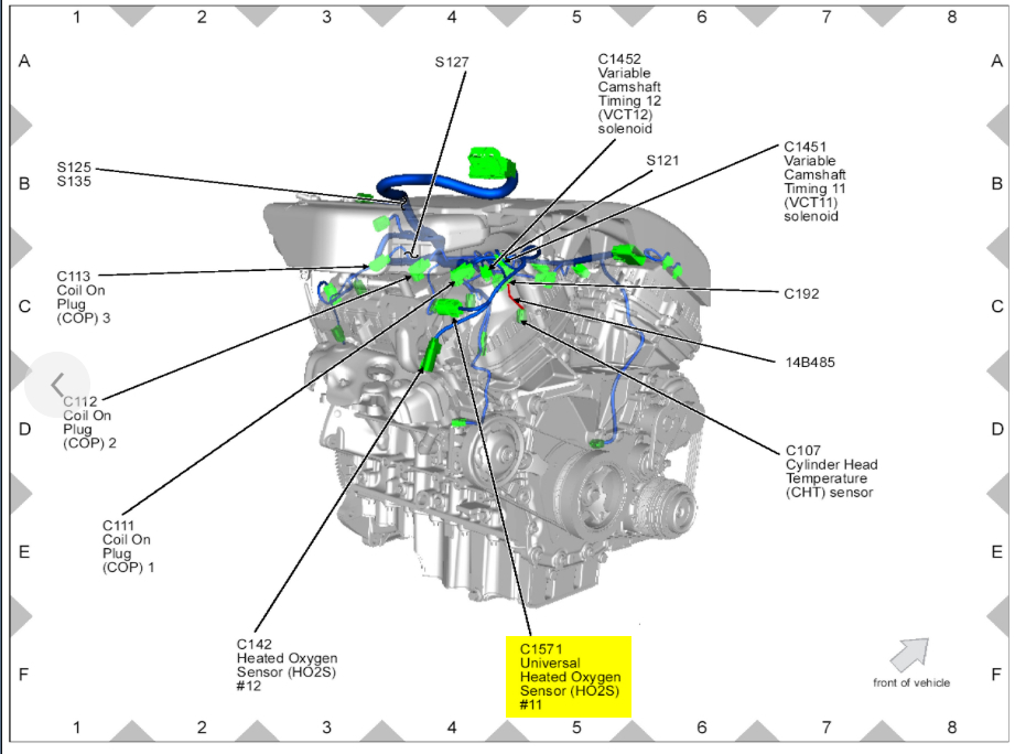

Attached is the location of the 1 1 HO2S. Let me know if you have more questions. Check out the diagrams (Below). Let us know what happens and please upload pictures or videos of the problem.

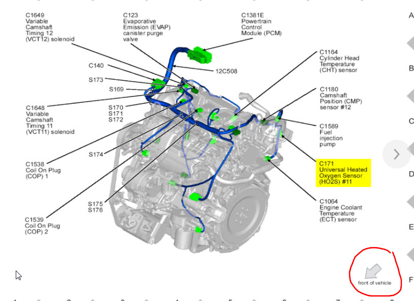

Awesome thank you! Can you show me where the front of the car would be on this drawing? If like to orient myself when trying to find this thing. Thanks!
Thursday, November 7th, 2019 AT 3:35 AM
Look in the lower right corner of the attachments. It gives an arrow for the front of the vehicle. I circled it and reattached it.

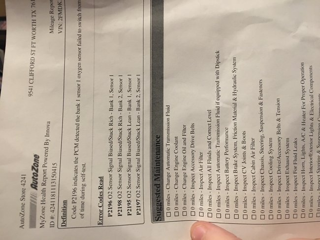

Here is what they said. We can totally send back the sensors that we do not need if you think we should not waste the time or money on the others.

There are checks to be done as the sensors may be working but seeing bad information.
Below are the possibilities for all the codes. All these items need to be checked to be sure of the reason for the codes.
The odds of having four sensors fail at the same time is like you getting hit by lightning two times in one day.

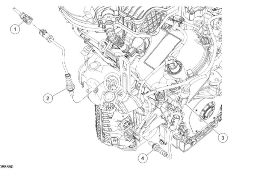

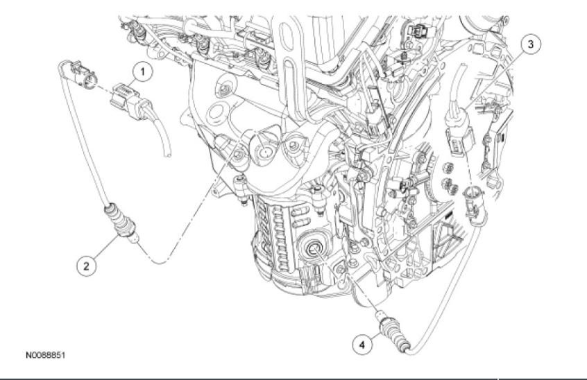

Bank 2 sensor 1 location any help would be great.

Here is a guide to help you step by step with instructions in the diagrams below to show you how on your car.
https://www.2carpros.com/articles/how-to-replace-an-oxygen-sensor
It is the one when you open the hood and it is right at the top on the exhaust manifold. I attached a couple of pictures for you to view. Check out the diagrams (Below). Please let us know if you need anything else to get the problem fixed.

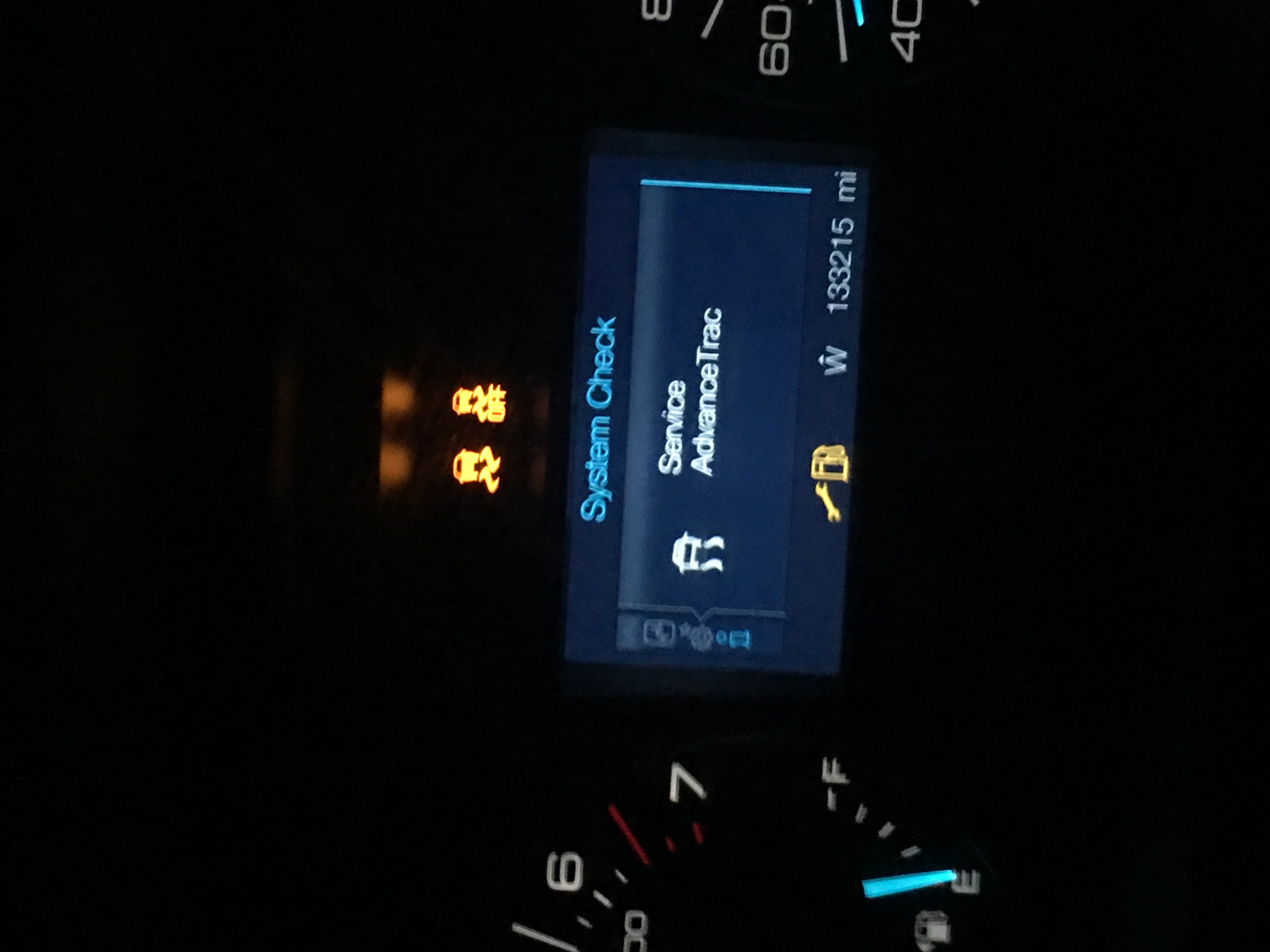

  • 52,797 POSTS
That code is for the stability control and has no connection to your current issue.
We can address that but you need to start a new question for that.
