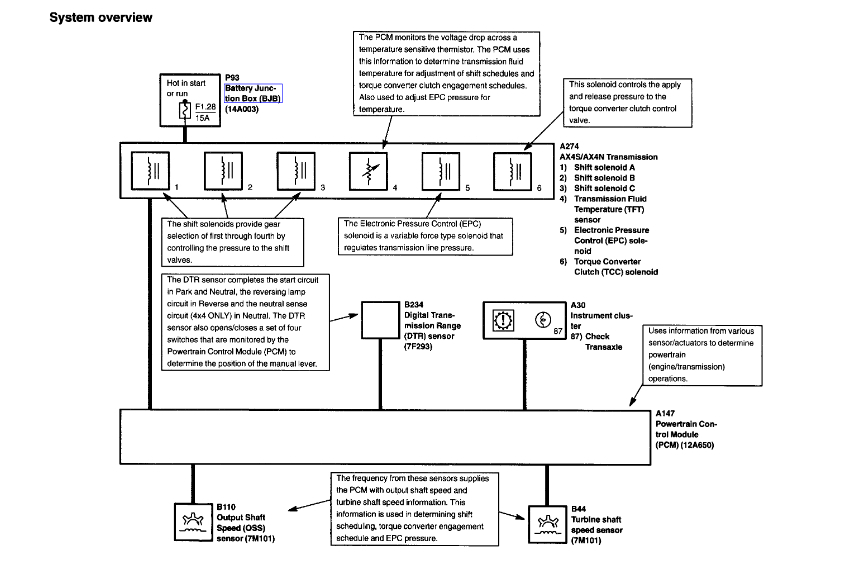

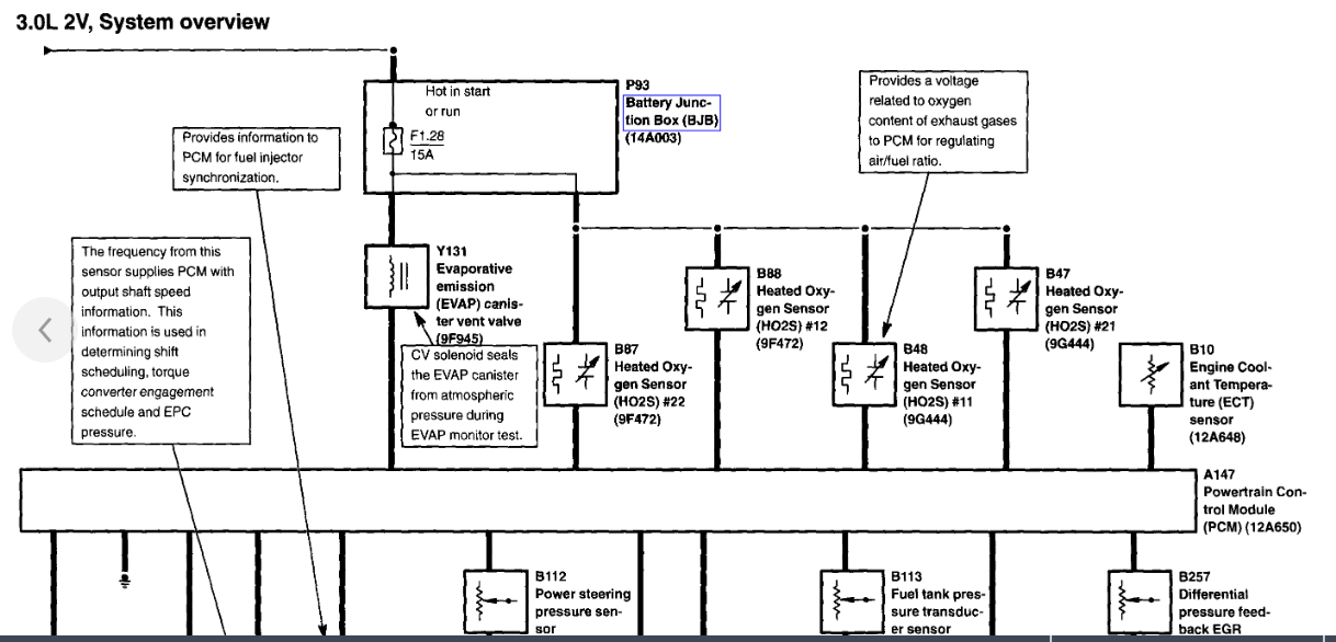

OHV. Diagnostic: sensor heater circuit malfunction and transmission issues. Scanned and pulled the following Codes- (P0135, P0155, P0141 and P0161) - (P0743, P0750, P1747 and P1751).
Jan 5, 2019 at 9:00 AM
Good morning,
I attached a diagram of the O2 sensors. the heaters are fed by a fuse listed. verify the power on both sides of the fuse and then verify power to each O2 sensor connector.
743 below
P0743
Descriptor
Probable Causes
Powertrain Control Module (PCM)
Torque Converter Clutch (TCC) Solenoid
750 and the rest
P0750
Descriptor
Probable Causes
This is possibly either a torque converter clutch solenoid failure, wiring harness issue or a failed PCM.
the wiring would have to be checked to verify before going anywhere else.
