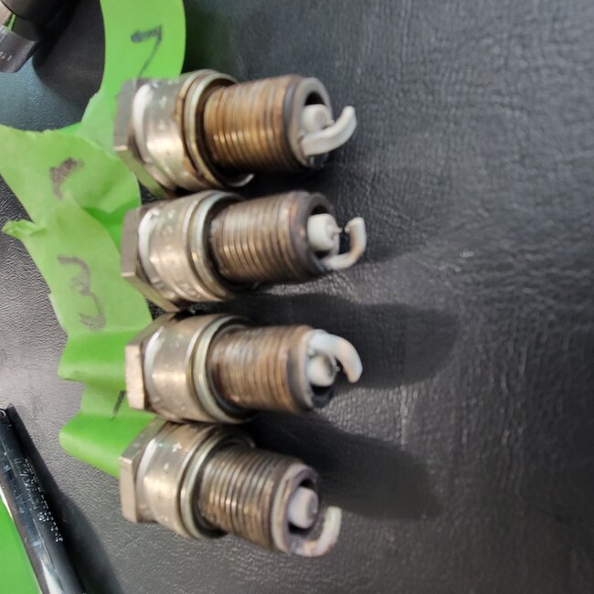

1997 Defender failed CA smog due to rich mixture at idle and gave code P0176. Ran live diagnostics on the sensors and have results but cannot determine if they are ok or not.

So it looks like you may have a fuel injector that is stuck open or leaking, I would remove all spark plugs and look for the one that is dark/black in color, this will be the cylinder that is having the issue.
P0176 on this model - Fuel Composition Sensor / Fuel Mixture Too Rich at Idle.
Please go over this guide as well, it shows what all can create a rich mixture code.
https://www.2carpros.com/articles/why-an-automotive-engine-will-run-rich
Please upload an image or a short video in your response of the spark plugs so I can see, be sure to keep them in order.

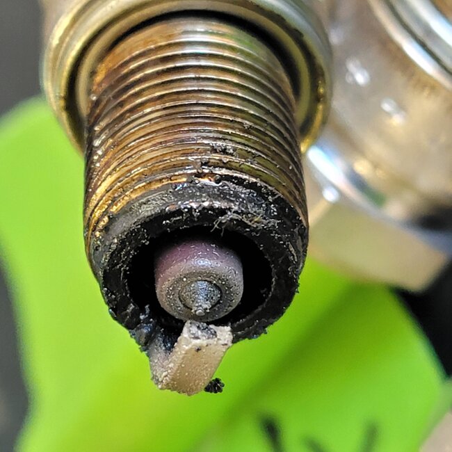

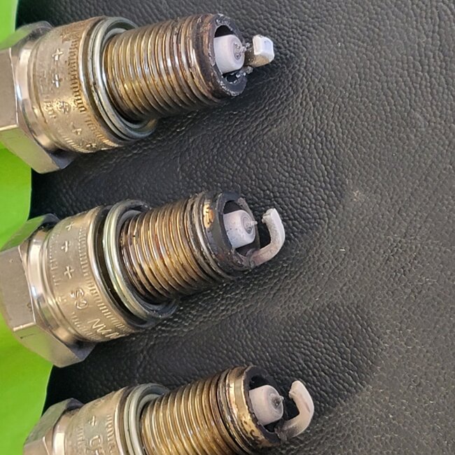

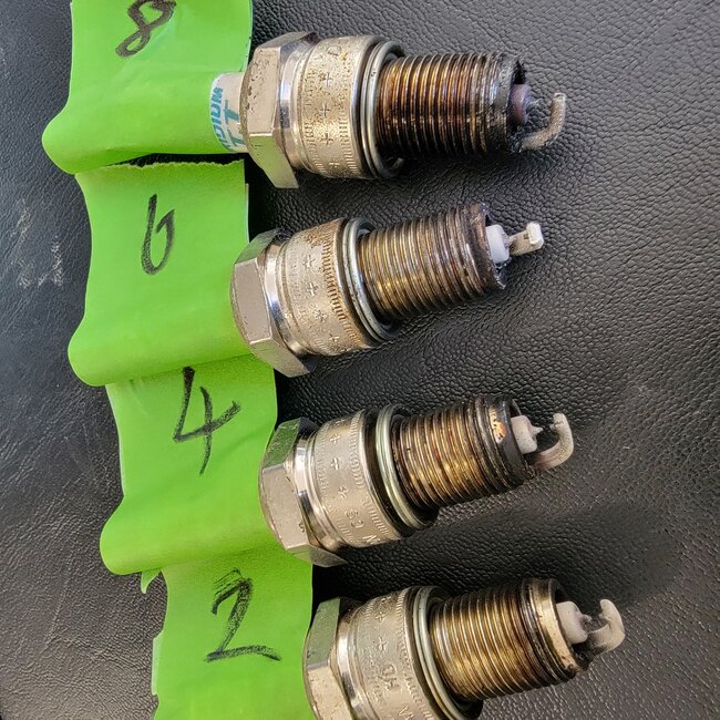

Hi Ken, first off thank you so much.
Plugs out as per pictured. Only one, cylinder 8, looks black with gunk on it.
Dec 6, 2025 at 4:39 AM
  • 55,433 POSTS
Alright! yep #8 does not look good, lets do a compression test to make sure the cylinder is okay, then we can replace the fuel injector which should fix the problem. Here is a guide to help.

Ken, installed new plugs and air filter. Poured a can of injector cleaner in the tank and it passed smog with flying colors today. Appreciate the help.
