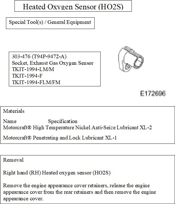

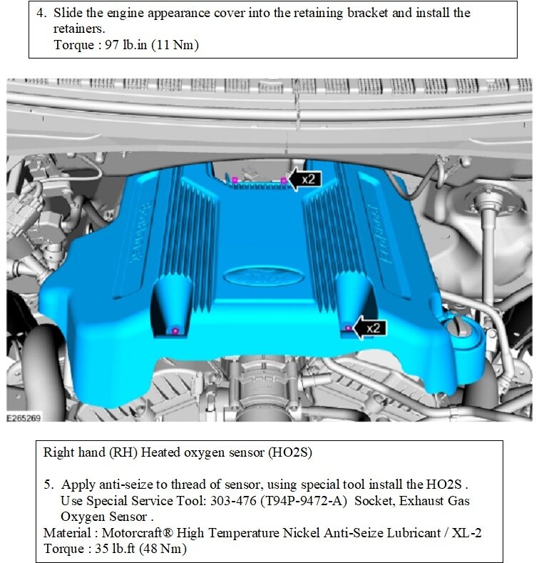

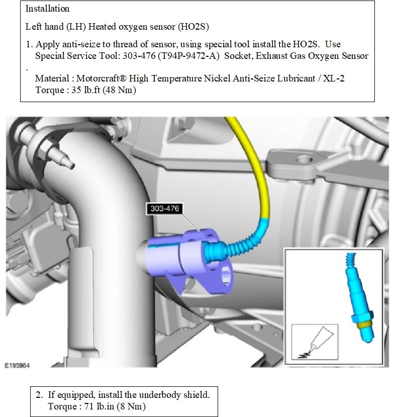

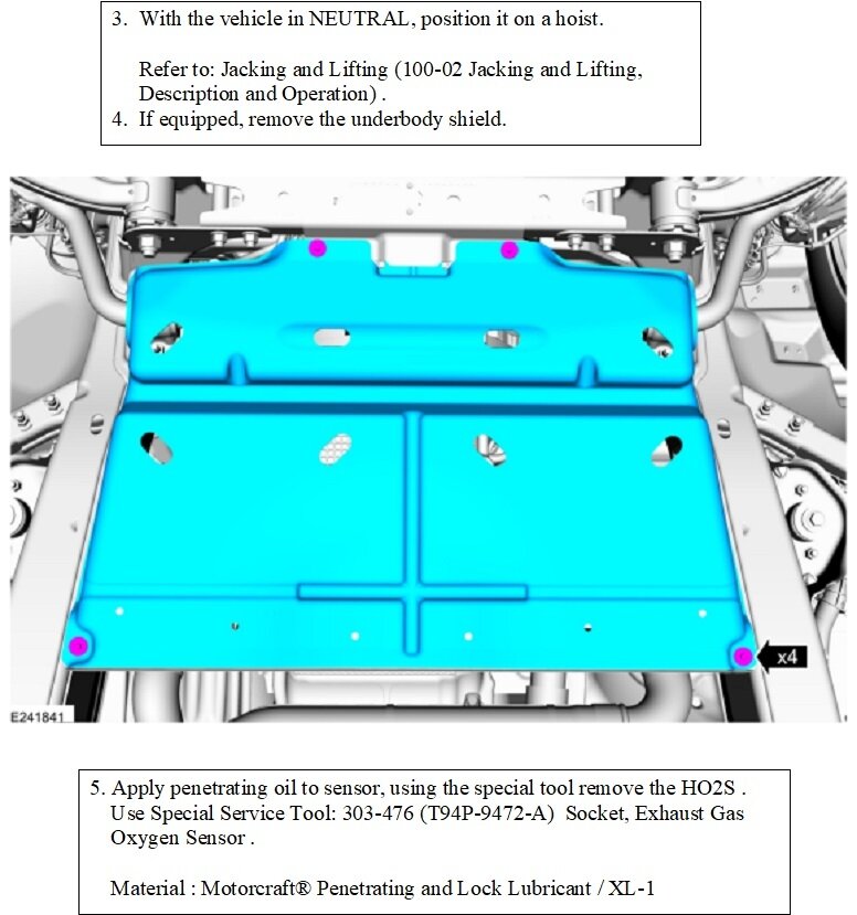

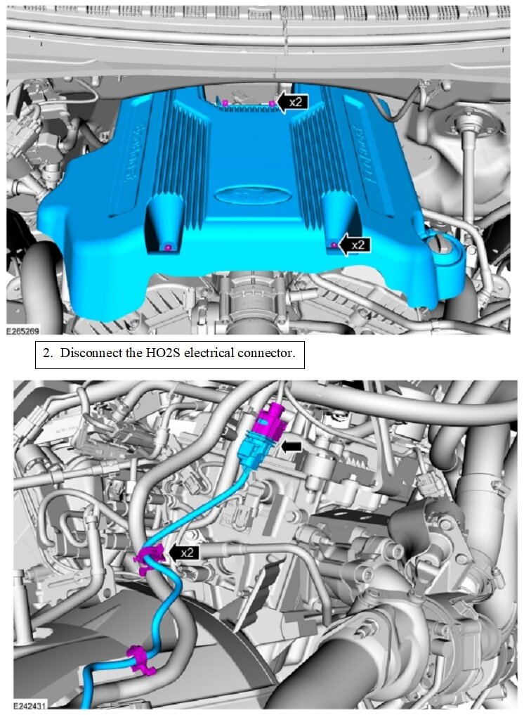

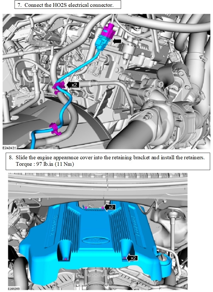

Where is the O2 sensor bank 2 located?
2020 FORD EXPEDITION
48,000 MILES • 3.7L • V6 • 2WD • AUTOMATIC
SB77095

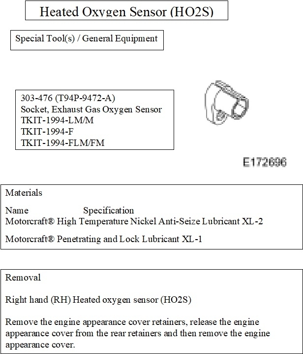

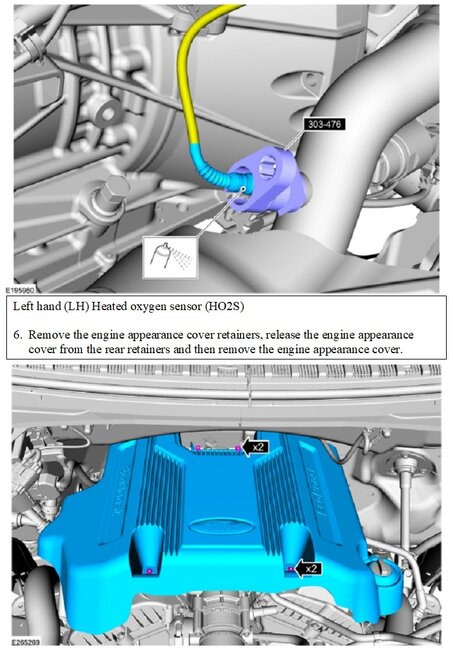

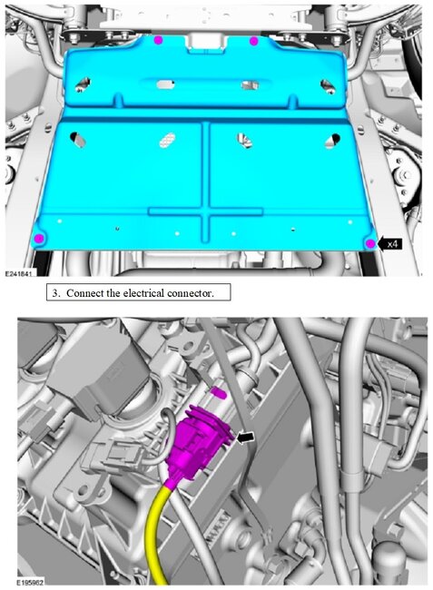

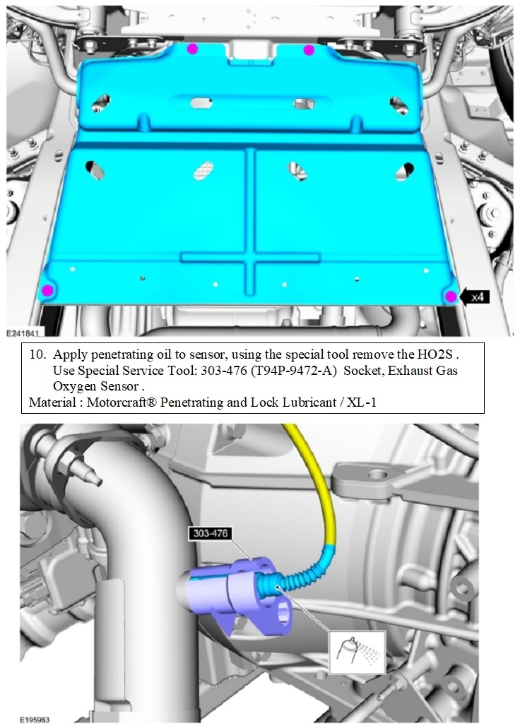

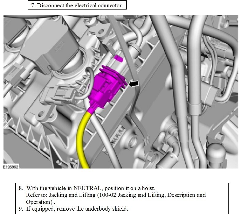

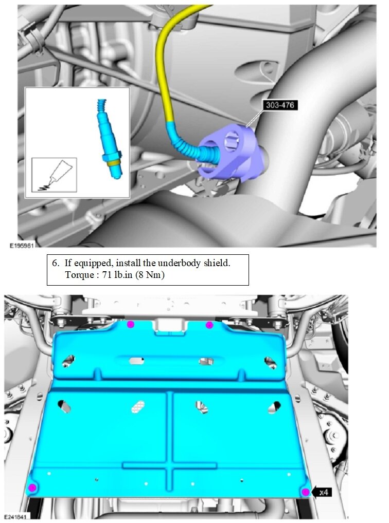

Where is the O2 sensor bank 2 location on the vehicle listed above?
Jun 10, 2023 at 3:09 AM
CARADIODOC
  • 34,378 POSTS
The only engine listed is a 3.5L turbo. Here's the removal instructions for all four sensors. Pictures are included to show the locations. Bank 2 is the passenger side.
