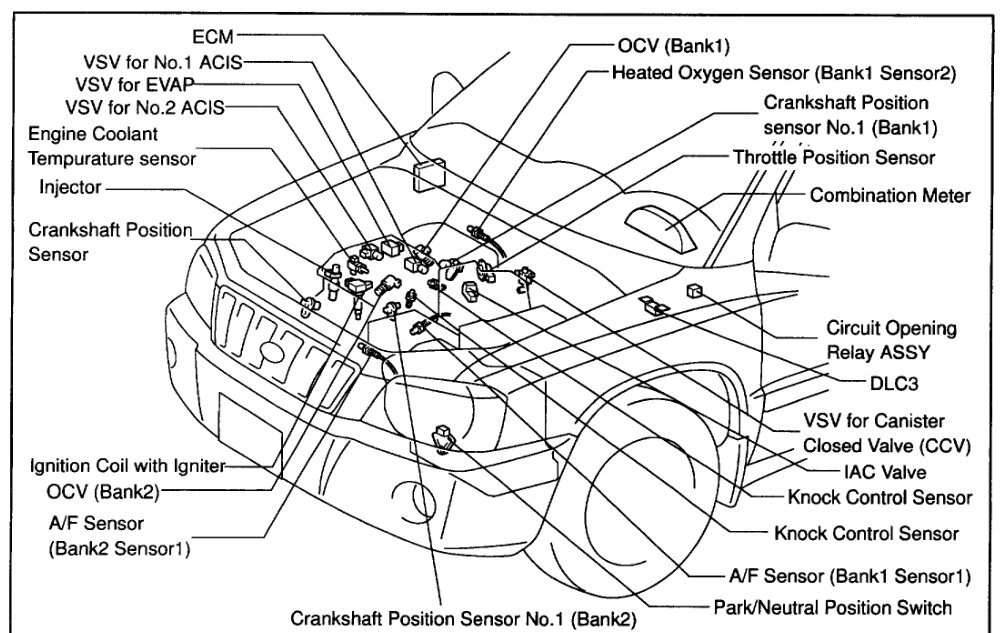

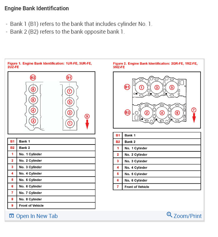

I need to replace o2 bank 1 sensor 2 because the engine code is p0136. I found 3 sensors but I'm not sure which one it is. Is the sensor the one that connects under the driver side seat after catalytic converter or is it located somewhere else? What is the spec for voltage and ohms because one sensor the one under the seat 13.5 when the car is cold and the other sensor in front of the engine which i think its bank 2 sensor 1, I get 1.5 ohms. Do you also know the OEM part number for the o2 sensor? Thank you
Aug 2, 2023 at 7:52 AM
  • 55,691 POSTS
The P0136 OBD-II Trouble Code in your 2001 Toyota Highlander refers to "O2 Sensor Circuit Malfunction (Bank 1, Sensor 2)".
Here is a generic guide to help you step by step with instructions in the diagrams below to show you how on your car:
https://www.2carpros.com/articles/how-to-replace-an-oxygen-sensor
Check out the images (below). Please let us know if you need anything else to get the problem fixed.
