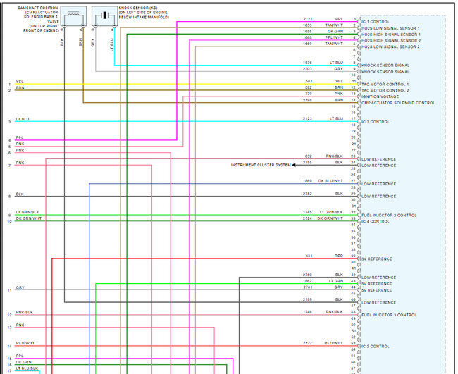

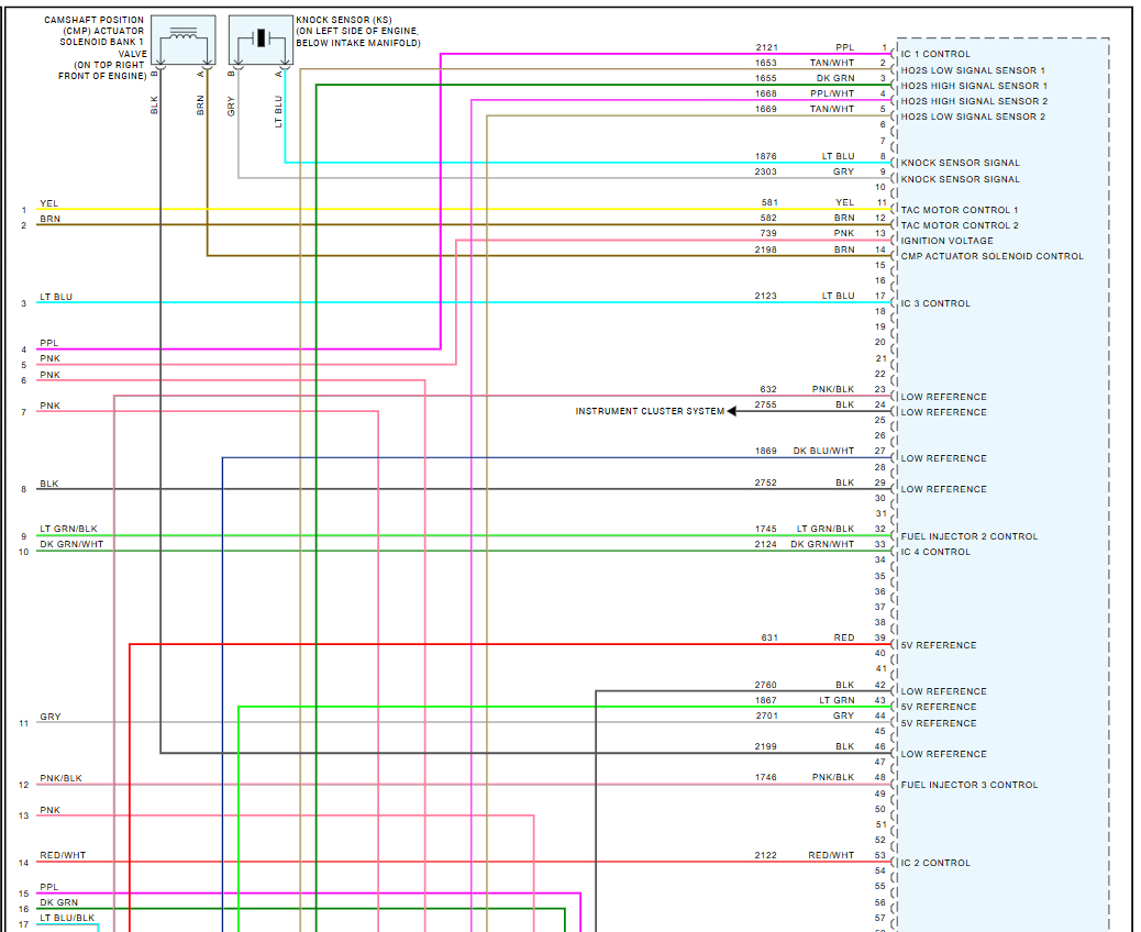

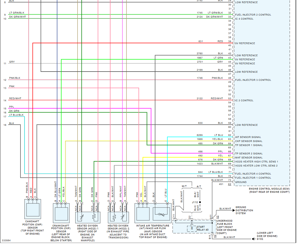

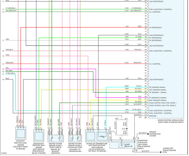

Have replaced sensor 3 times getting a sensor inactive code best I can tell only getting 0.47 volts to sensor can't find out what voltage is supposed to be coming to sensor. if I could find the correct wiring diagram it would help. Any tips on fixing this problem would be appreciated. thank you
Jan 8, 2025 at 12:28 AM
  • 55,711 POSTS
The heater circuit for the O2 sensor receives 12V from a fused power source and a ground signal from the PCM. The sensor generates its own voltage (between 0.1V to 0.9V) based on the oxygen levels in the exhaust. Here are the wiring diagrams and a guide to help you test the continuity from the sensor to the PCM.
Check out the images (below). Let us know how it goes.

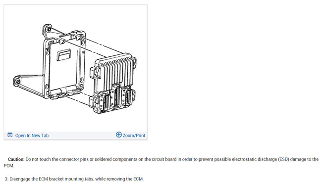

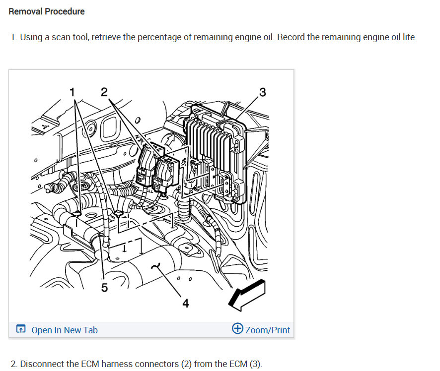

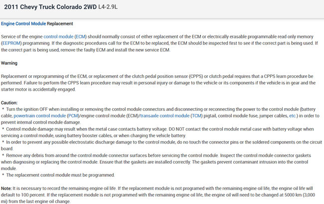

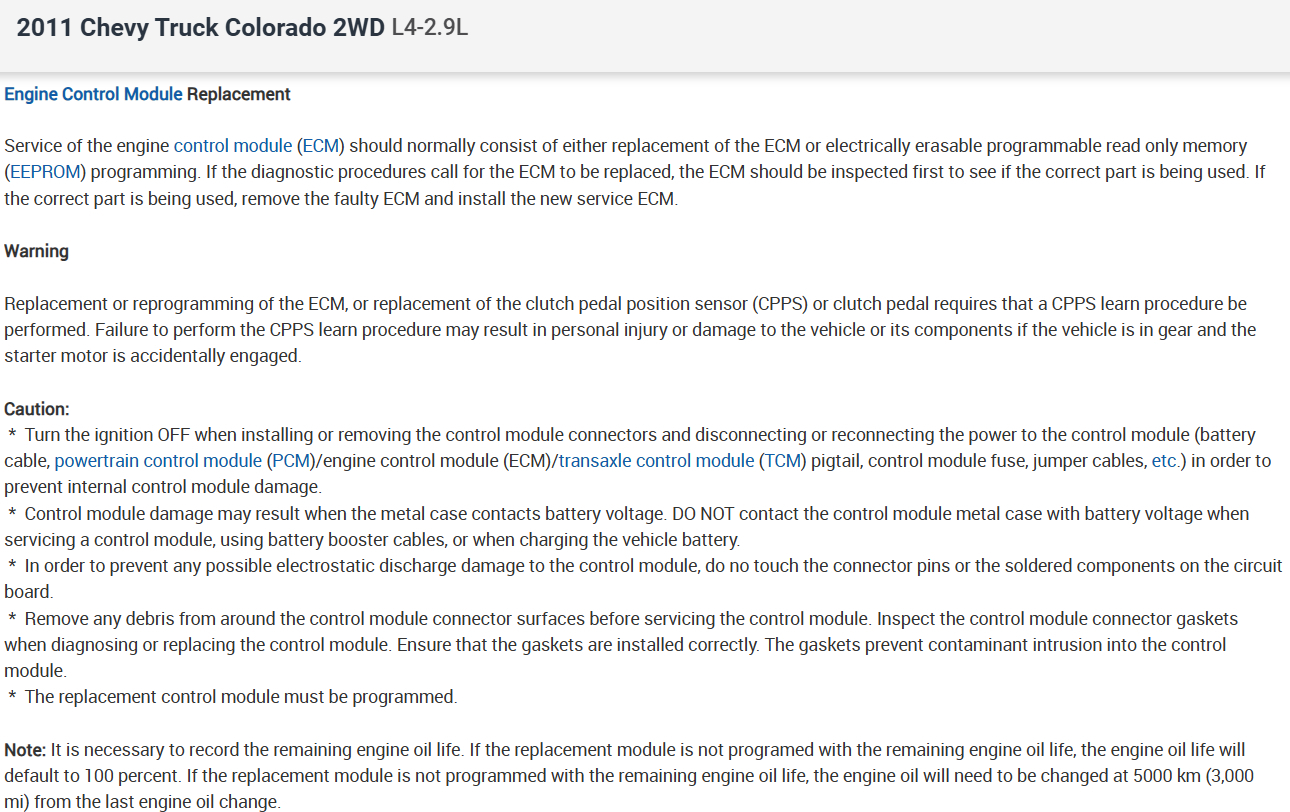

Yep, I would check the wiring to the PCM and if okay it sounds like the PCM is bad.
P0053 - HO2S Heater Resistance Bank 1 Sensor 1
P2A00 - O2 Sensor Circuit Performance Bank 1 Sensor 1
P0134 - O2 Sensor Circuit No Activity Detected Bank 1 Sensor 1
If the wiring is okay here is how to change the PCM out, you can get a preprogrammed unit by searching Google or Ebay. Check out the images (below). Please let us know what happens.
Jan 14, 2025 at 2:06 AM

I've checked wiring to o2 sensor no brakes. I'm getting 12volts on heater circuit i've got 9.3 resistance on o2 sensors heater I cleaned contacts on PCM but still getting trouble codes.
Jan 28, 2025 at 9:52 PM
  • 55,711 POSTS
I would send the PCM for testing, it sounds like it is bad.
