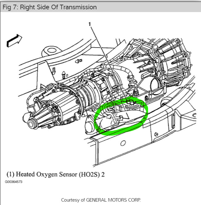

How many o2 sensors are on this vehicle?
2007 GMC ENVOY
110,469 MILES • 4.2L • 6 CYL • 4WD • AUTOMATIC
STEVE620
  • 70 POSTS
Tried looking for the one downstream and i couldn't find it unless it was hidden.
Thanks.
Dec 26, 2021 at 11:44 PM
AL514
  • 5,668 POSTS
Hello, this vehicle has two oxygen sensors, the rear one is behind the Catalytic Converter. Below is a picture of its location to the right side of the transmission.
