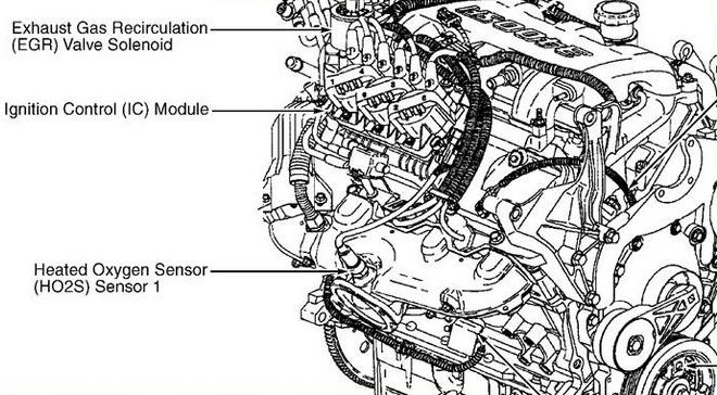

How many O2 sensors does my car have?
Wednesday, February 7th, 2018 AT 9:20 AM
18 Replies
  • 110,068 POSTS
There are two. One is an upstream (see attached picture) and the other is the downstream which is near the catalytic converter. Here is a guide to help you step by step with instructions in the diagrams below to show you how on your car.
https://www.2carpros.com/articles/how-to-replace-an-oxygen-sensor

What is the Code you are getting. Your vehicle if it is dual exhaust has at least 4 O2 Sensors. If single it has at least 3. In most cases if it is a sensor it would read something like this.
Bank 1 Sensor 1 below threshold.
Or Bank 1 Sensor 2
or Bank 2 Sensor 1 etc.
Usually if it just has Bank 1 lean or below threshold, could be an Exhaust Leak Vacuum Leak Fuel Pressure problems plus other causes.

Most newer cars (1996 and above) have more than one, usually two (upstream and downstream).
They are in exhaust system. Upstream is in header or close to header, downstream is in exhaust after convertor.
Later model cars have up to four O2 sensors.
