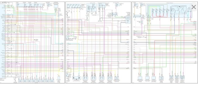

Engine light turned on, code reader said o2 sensor
2003 CHEVROLET SUBURBAN
180,000 MILES • 5.3L • V8 • 4WD • AUTOMATIC
RAVEN1936

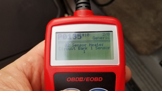

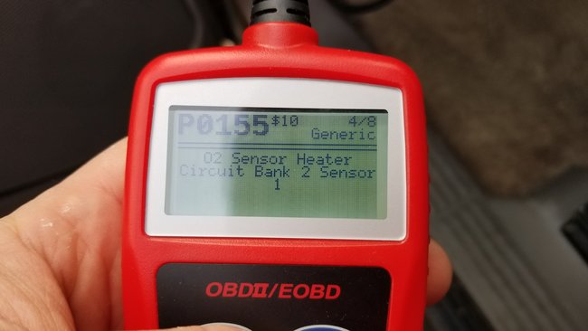

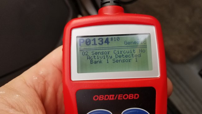

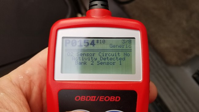

Engine light came on so I attached my code reader to truck it produced codes saying the bank 1 o2 sensor 1 and bank 2 o2 sensor 1 were not functioning. replaced both sensors and cleared codes after forty five minutes running the light came back on and produced the same codes.

Good morning,
What were the exact codes?
Rarely does a code identify a bad part, just failed systems.

RAVEN1936
Have also check fuse that's related to o2 sensor.

Got it. I need the code number.

RAVEN1936
Po155, po154, po135 and po134.
Mar 3, 2019 at 2:44 AM
Got it.

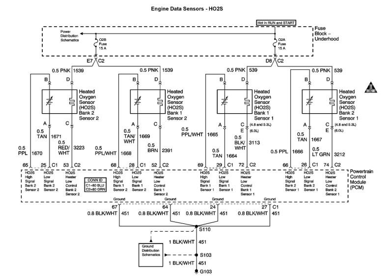

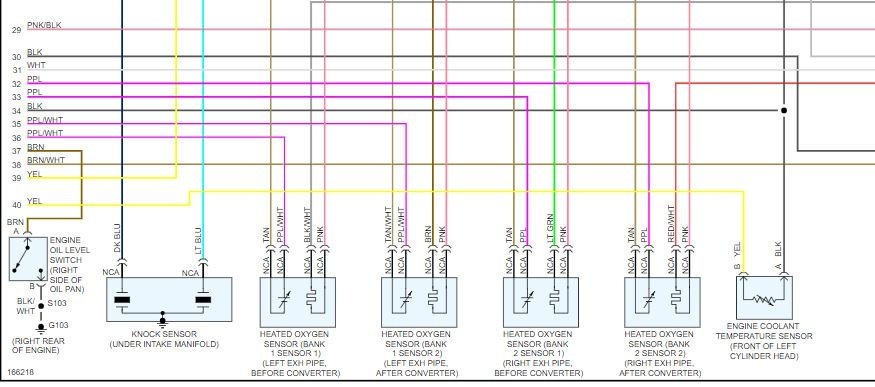

I attached two wiring diagrams for you to view for the O2 sensors.
Check the listed fuses for power on both sides.
