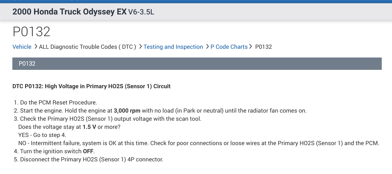

check engine light with codes PO131 and PO132
220,000 MILES • 3.5L • 2WD • AUTOMATIC
STEVO1109

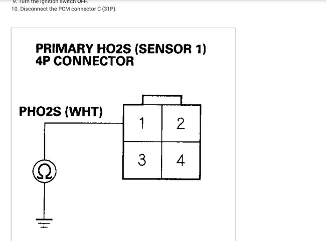

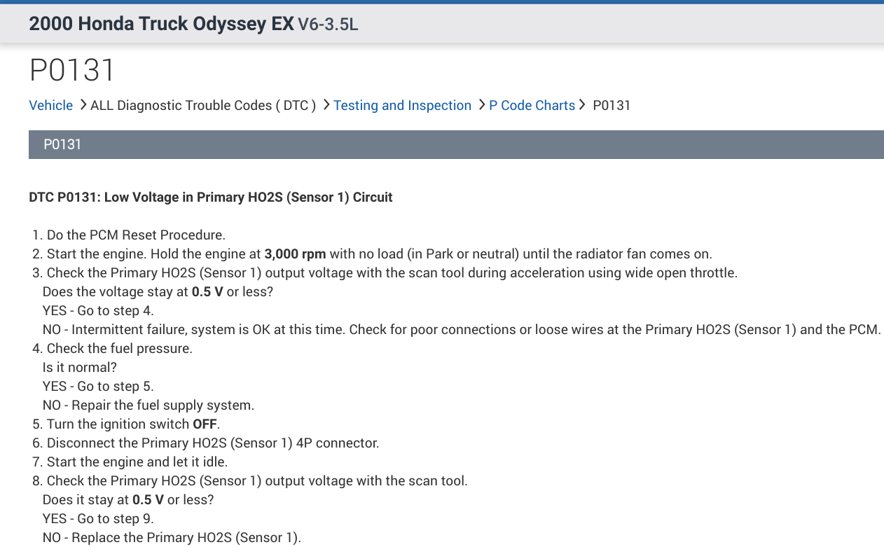

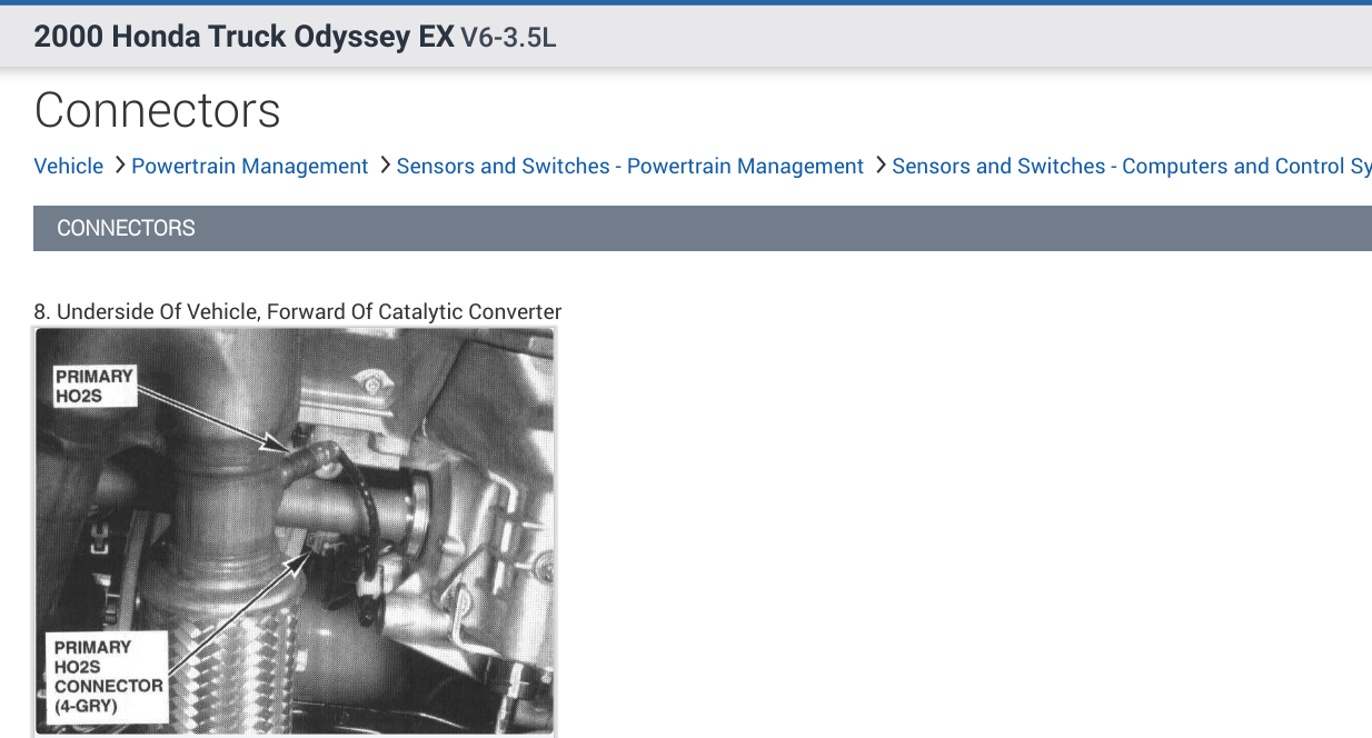

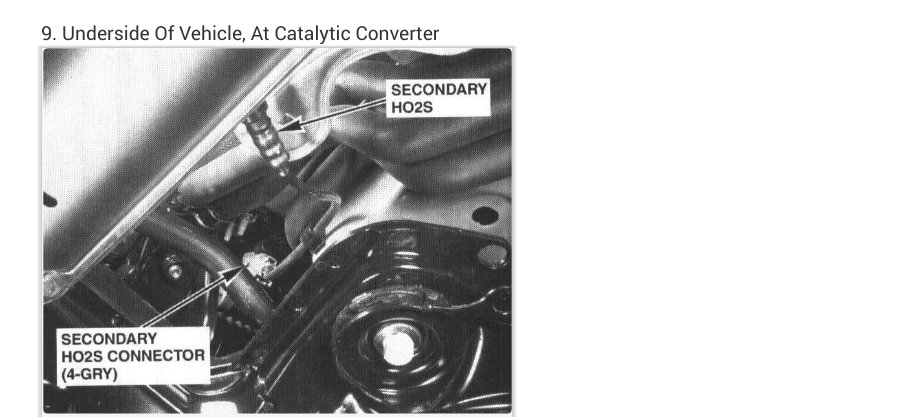

so I would like know is there only one O2 sensor on my model that I found just before the catalytic converter.
Mar 14, 2020 at 4:59 PM
SCGRANTURISMO
  • 4,897 POSTS

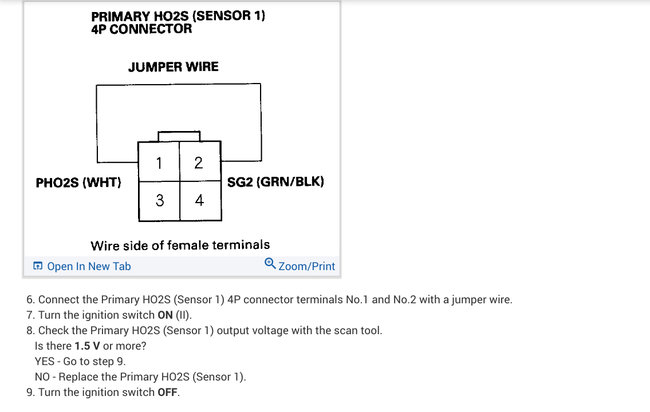

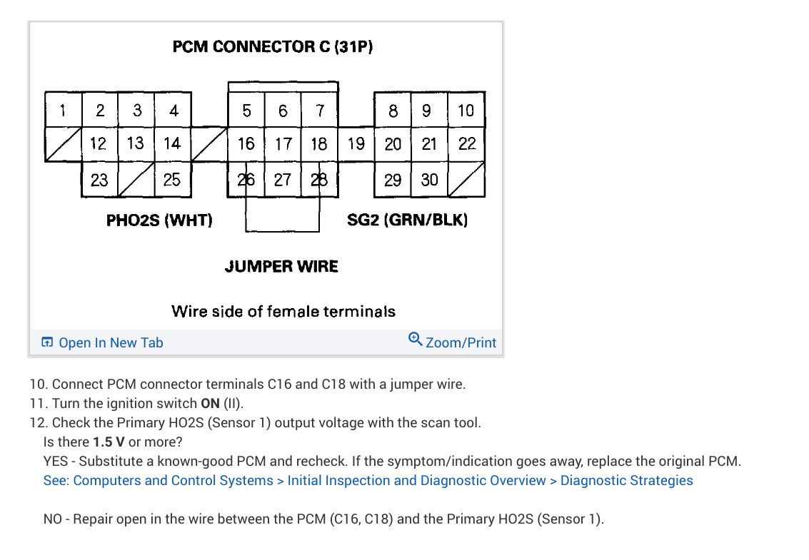

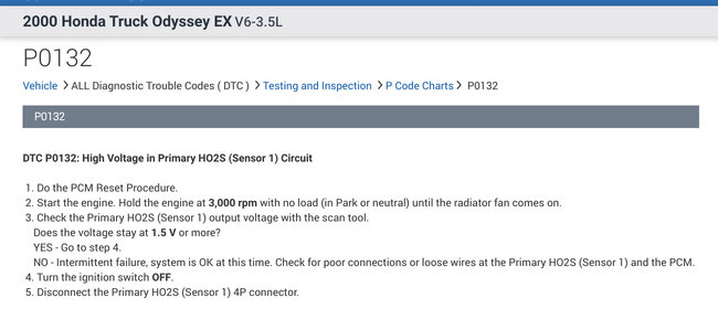

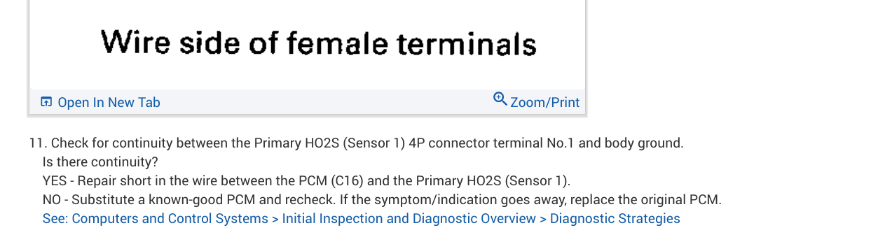

In the diagrams down below I have included the locations of both of the O2 sensors for your vehicle as well as guides for tracking down the problems for Direct Trouble Codes[DTC][s] P0131 and P0132 from the vehicle manufacturer. Please go through these guides and get back to us with what you find out.
