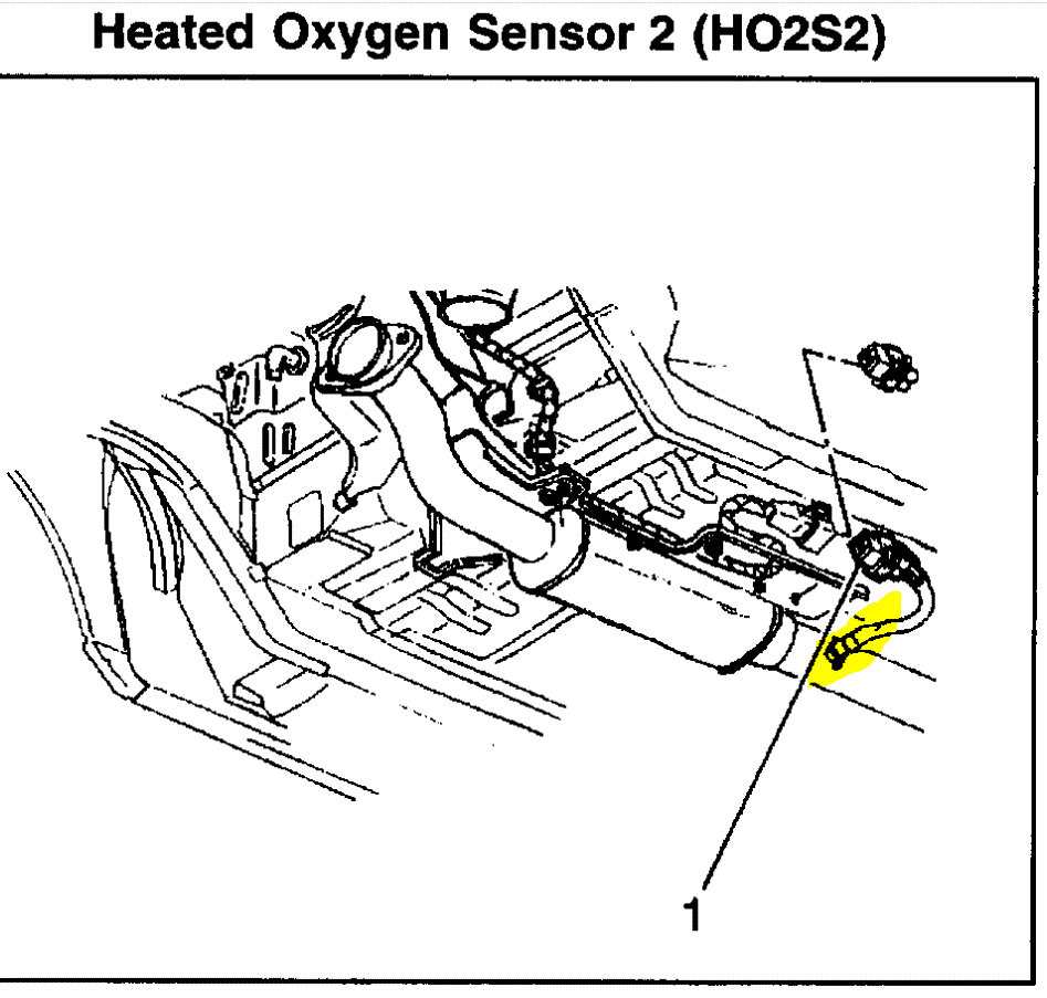

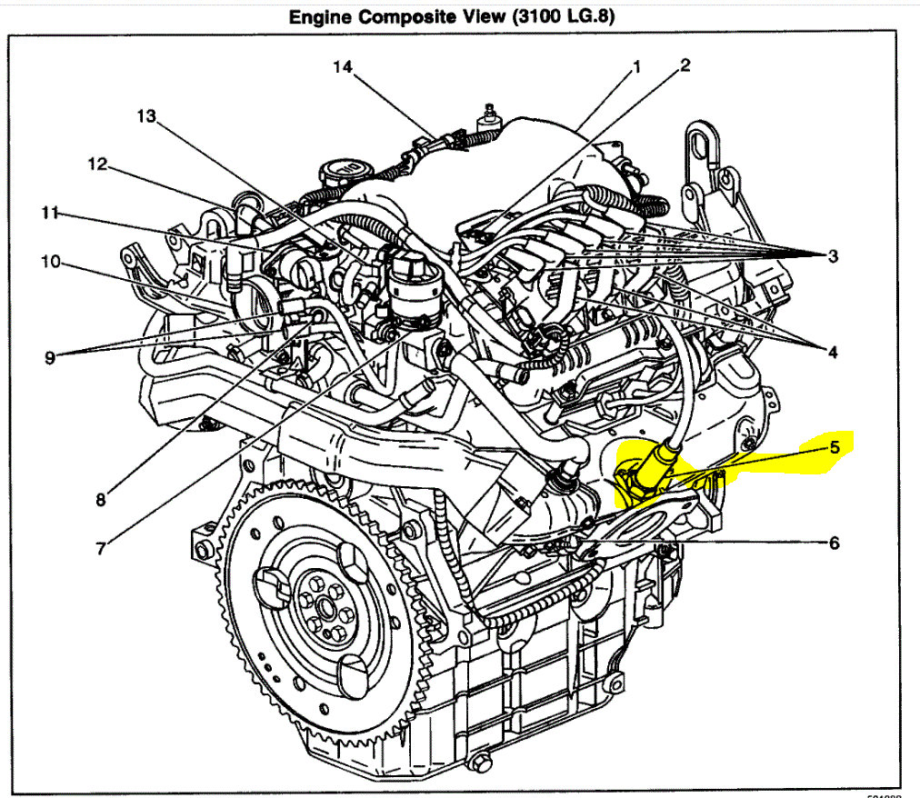

O2 sensors location needed.

On this vehicle, there are two. One is on top of the exhaust manifold and the other is under the vehicle on the exhaust.
If you look at the two pics below, I highlighted the sensors. The one on the exhaust manifold is sensor 1. The one under the vehicle is sensor 2.
