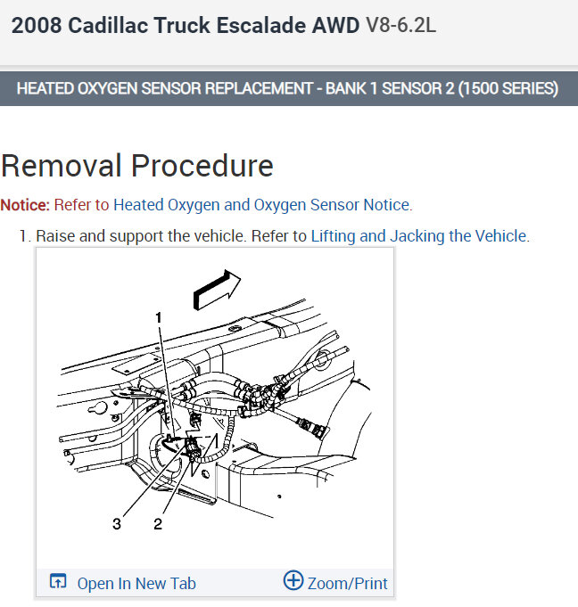

Bad acceleration response combined with poor mileage. Dtc set p0036, p0054, p0056..etc.
Jul 1, 2024 at 12:30 PM
  • 55,399 POSTS
These are all oxygen sensor heater codes.
P0036: Heated Oxygen Sensor (HO2S) Heater Control Circuit (Bank 1 Sensor 2)
P0054: Heated Oxygen Sensor (HO2S) Heater Resistance (Bank 1 Sensor 2)
P0056: Heated Oxygen Sensor (HO2S) Heater Control Circuit (Bank 2 Sensor 2)

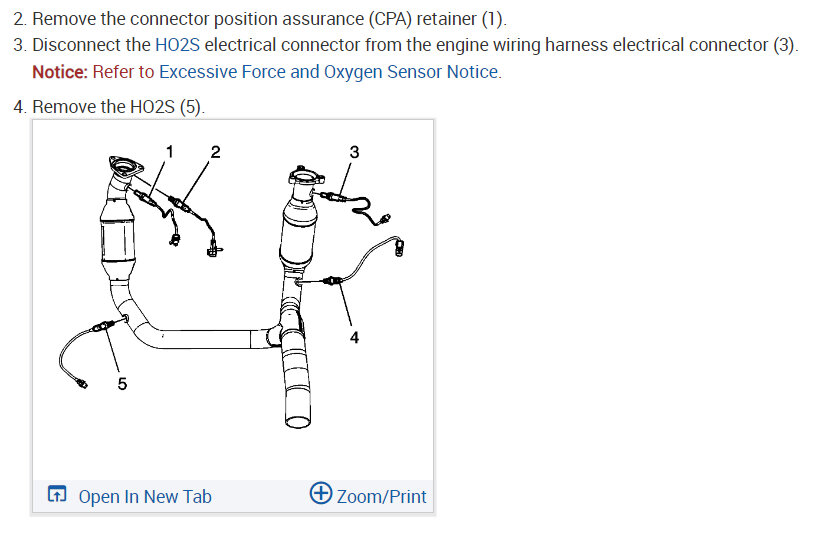

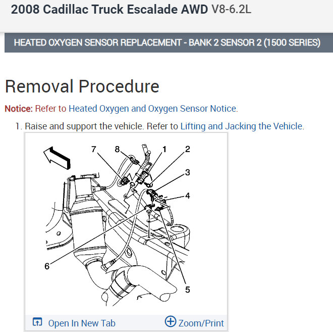

Did all of these codes come up at once? If not let's replace the 4 oxygen sensors with new units, here are the locations in the images below, here is a generic guide to help you step by step with instructions in the diagrams below to show you how on your car.
https://www.2carpros.com/articles/how-to-replace-an-oxygen-sensor
Clear the codes once the repairs have been completed and the problem should be solved. Check out the images (below). Let us know how it goes.
