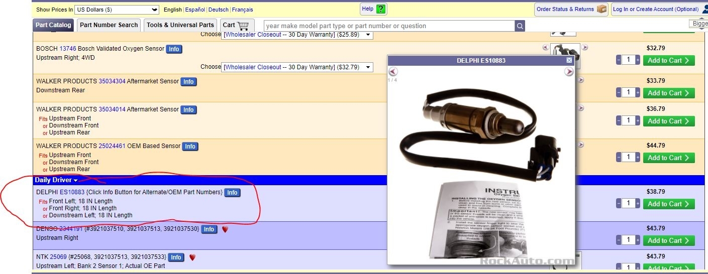

Hi there, can i use o2 sensor 2 from bank 1 to bank2? Or those are two different sensors? Thank you

The difference is the length of the wiring to the connector.
I attached the delphi sensor from rock auto that lists the 18 inch sensor which fits bank one and two upstream.

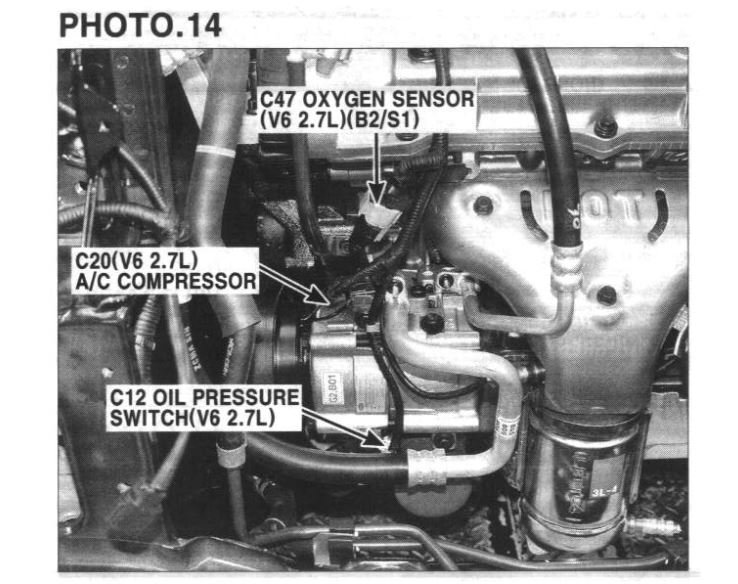

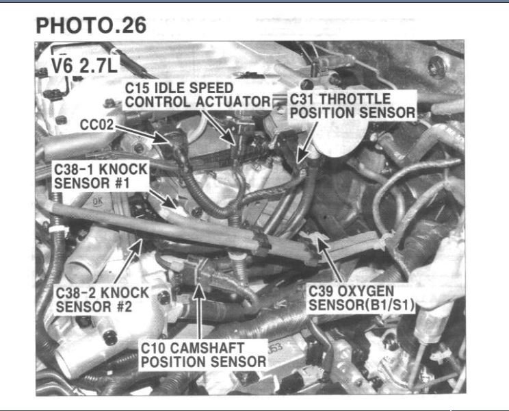

Hi there, i know it's upstream but is it right one in the vehicle listed above? The pictures are so confusing to me. i'm trying to replace it with engine oil pan because the oil dripping on it. It is weird because like i said before i have code p0736 where i already replace o2 sensor bank 1 sensor 2 and code p0530 . so i'm hoping that when i replace o2 sensors in bank 2 which i have to do anyways they were never replaced i won't have to fixed catalytic converter ( i can see it was replaced too). Thank you
