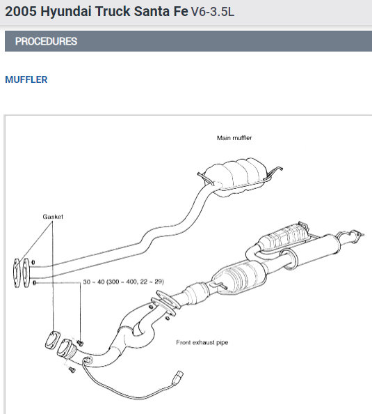

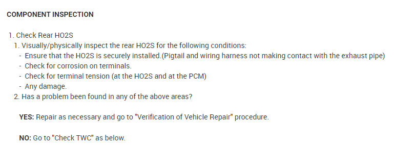

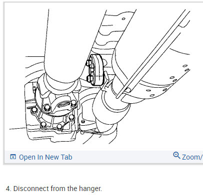

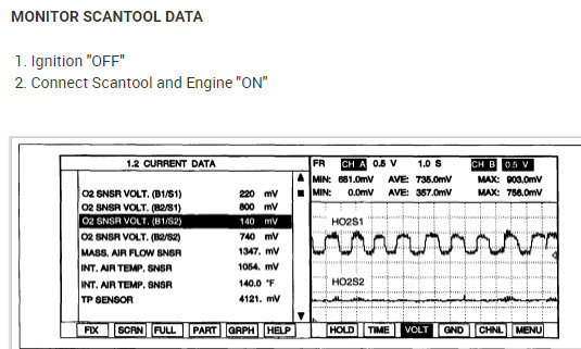

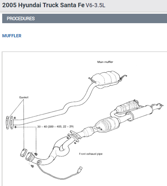

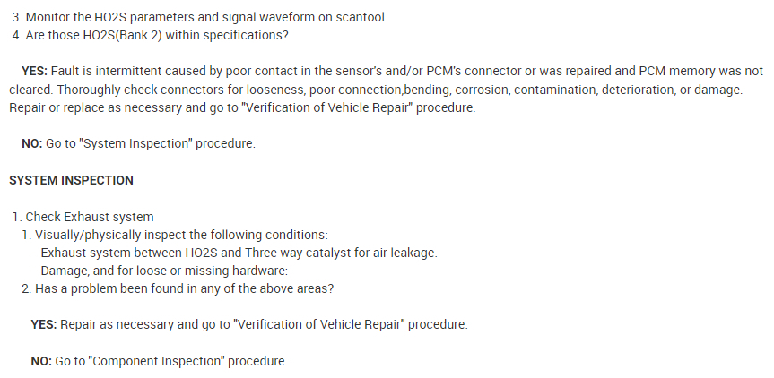

I just replaced bank 1 sensor 2 reset computer and drove a little bit. same code showed up what does it mean? i also have code p0430. Thank you
Mar 4, 2021 at 7:27 AM
DANNY L
  • 5,648 POSTS
Hello, I'm Danny.

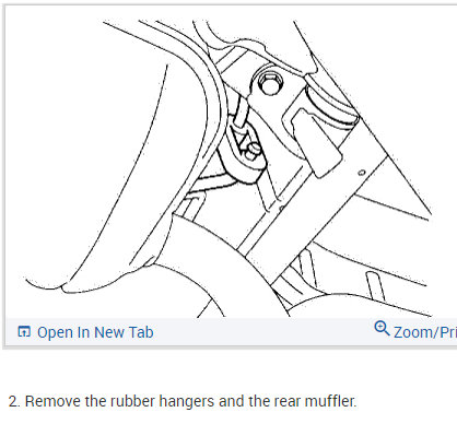

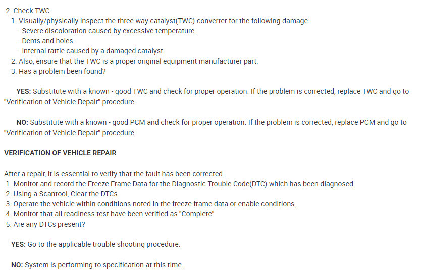

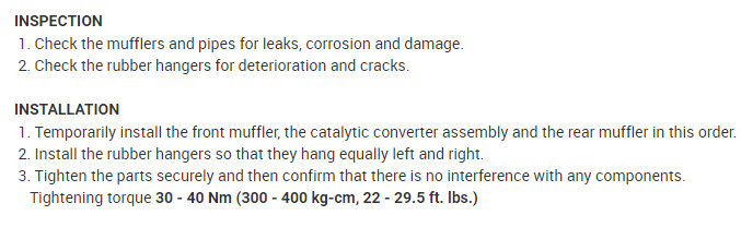

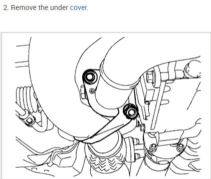

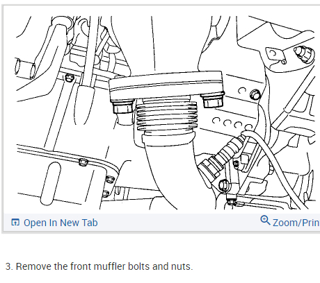

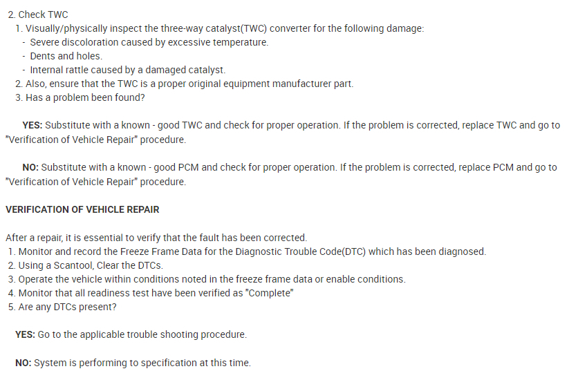

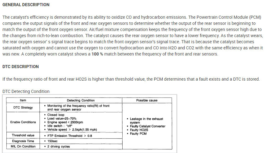

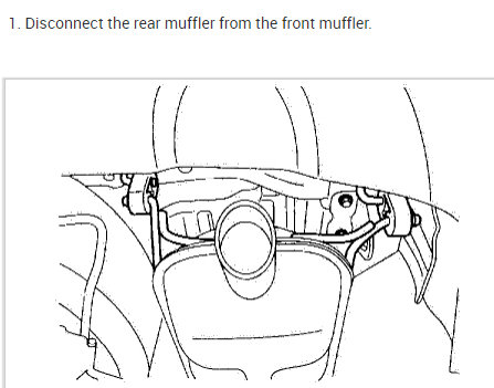

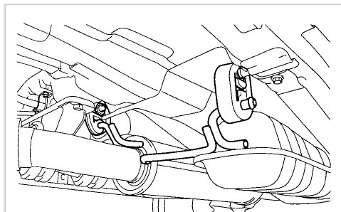

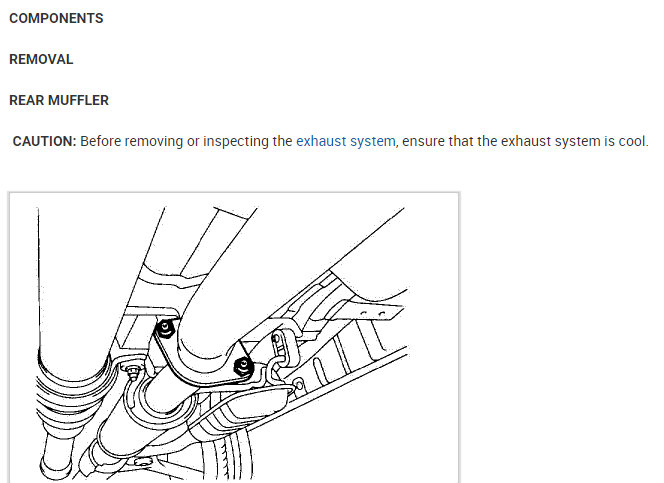

The code P0430 is for bank 2 catalytic converter inefficiency. Here are a few tutorials showing catalytic converter symptoms, testing, and replacement:
https://www.2carpros.com/articles/catalytic-converter-replacement
Due to having a faulty oxygen sensor up until replacement it may have caused damage to the catalytic converter. I've attached picture steps below on removal and replacement on your vehicle. I would have them tested first before replacement. Hope this helps and thanks for using 2CarPros.

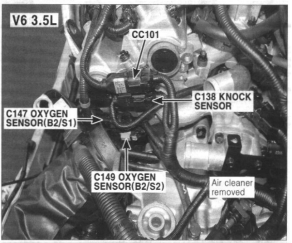

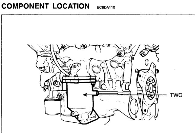

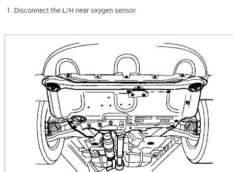

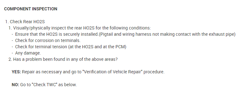

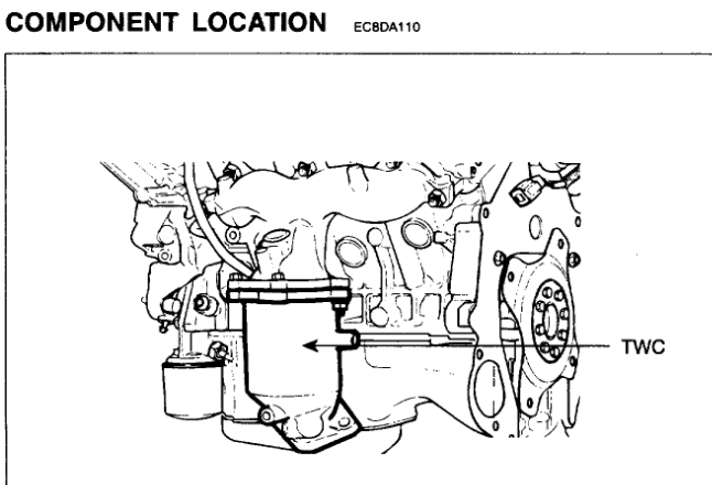

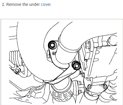

Which o2 sensor is under engine oil pan then? It's on the passenger side. thank you
Mar 5, 2021 at 9:27 PM
DANNY L
  • 5,648 POSTS
Hello again.
Your vehicle has 4 oxygen sensors. There are 2 sensors on each bank left and right. One is upstream and one is downstream. I've attached photos for you below. Hope this helps and let us know if you have any further questions on this issue. Thanks again for using 2CarPros.
Danny-
Mar 5, 2021 at 10:00 PM

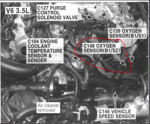

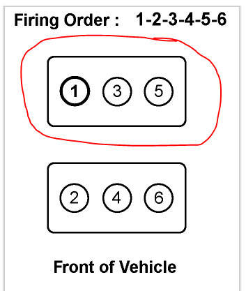

EVELKA
  • 47 POSTS

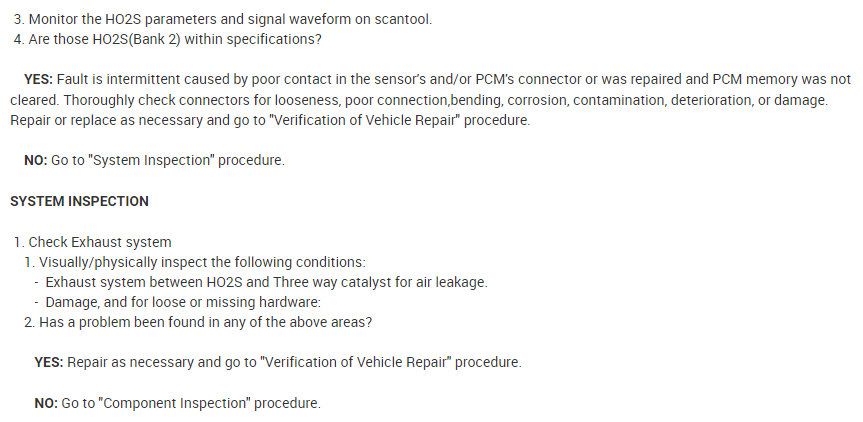

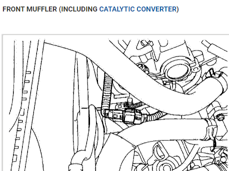

I'm sorry bother you. so the bank 1 is on the driver side or passenger side? And then bank 1 sensor 2 is upfront?
Mar 6, 2021 at 3:46 AM
DANNY L
  • 5,648 POSTS
Hello again.
Bank 1 is the cylinder bank closest to the firewall-windshield. Sensor number 2 is the lowermost sensor towards the back of car. Attached pictures again below and circled in red. Hope this helps and let us know if you have any further questions on this issue. Thanks again for using 2CarPros.
