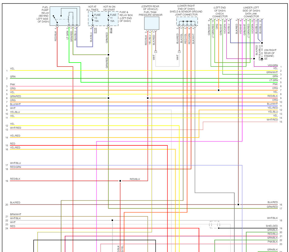

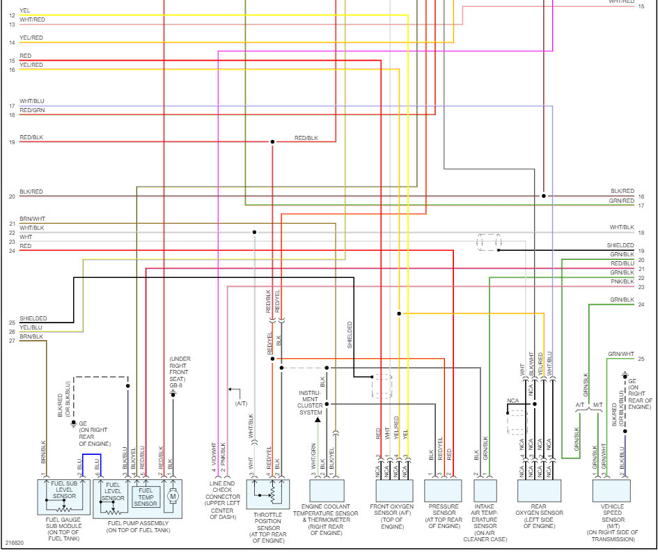

Can I get the wiring diagrams for both of the O2 sensors please?
150,000 MILES • MANUAL
DOLLABILL25
  • 46 POSTS
I just need to know the wiring diagram for both of the O2 sensors please. Because I know the 2 wires that are the same color are the heater side just need to know of the other 2 wires which is ground, and which is signal. Thank you
Nov 9, 2023 at 11:49 PM
  • 55,691 POSTS
Sure, here are the wiring diagrams for both primary and secondary oxygen sensors. Check out the images below. Let us know if you need anything else, please.
