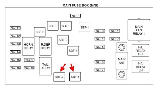

I understand what the computer means and throws a code at you. It is a p0031 code. I just thought it was odd that it popped up when my car started running hot. Was barely driving five minutes when it started overheating so I thought "let's change the thermostat and fix the overheating problem first" did that. Car is still overheating within a couple minutes of driving. Fans kicking on. Thinking of what to do next to stop it from overheating then worry about the sensor.

That code refers to the oxygen sensor's heater circuit. It could indeed be caused by a defective sensor, but it is just as likely to be caused by corrosion on a connector terminal, a cut wire, or water in the connector that caused a fuse to blow. Also look for a wire harness that fell down onto hot exhaust parts.
Lets start with the easiest thing to check. I can only find two fuses related to the O2 sensors. Those are SBF-5 and SBF-7, both 30-amp, in the under-hood fuse box. Check for 12 volts on both sides of both fuses with the engine running. If you find 12 volts on one side of a fuse and 0 volts on the other side, that fuse is blown.
At the mileage you listed, it is a little early to be thinking about a leaking cylinder head gasket, but given your observation the engine overheats in just a few minutes, that is a good suspect. An engine cannot overheat that quickly otherwise when started cold. The best test for this involves drawing air from the radiator, with the engine running, through a glass cylinder with two chambers partially-filled with a special dark blue liquid. If combustion gases are sneaking into the cooling system, the liquid will turn bright yellow. Those gases can pool under the thermostat, preventing it from opening. Thermostats must be hit with hot liquid to open. Hot air will not do it.
