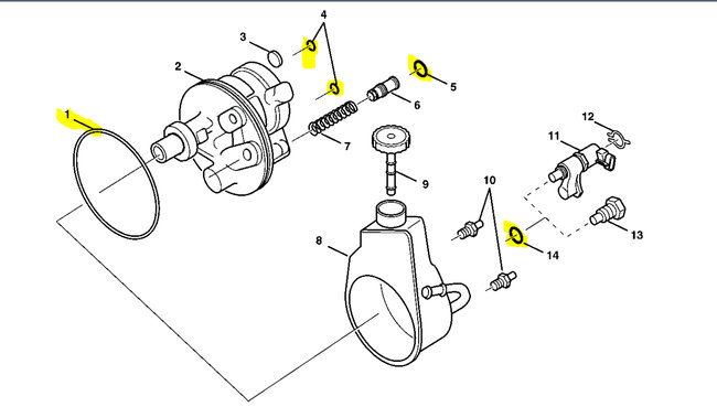

Not sure where to put the new o rings I had for power steering pump.

I was able to find an exploded view of the power steering pump. I attached it below for you to review.
Looking at the pic, I see a total of five. Take a look at the picture and let me know if that helps.
When you install these, make sure to lubricate them with P/S fluid first. It will help prevent damage.
See pic below.
