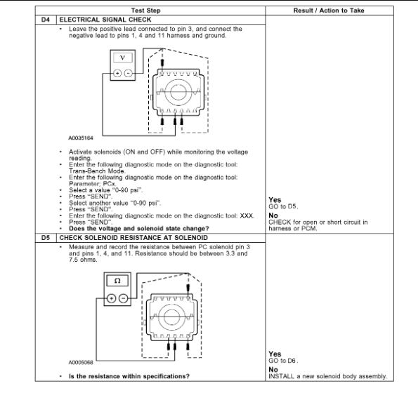

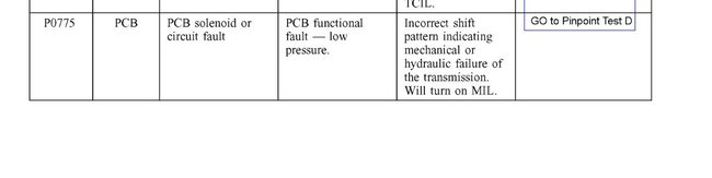

Overdrive light flashing, shifting hard. No overdrive. Had codes ran have a PO775 code pressure control solenoid B. Auto parts store said this item is inside of transmission so costly fix. Is that correct?
Nov 23, 2018 at 5:15 AM
Good afternoon,

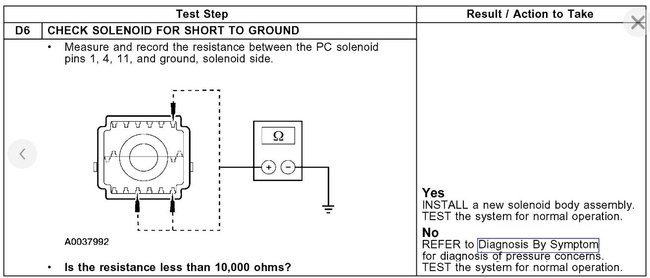

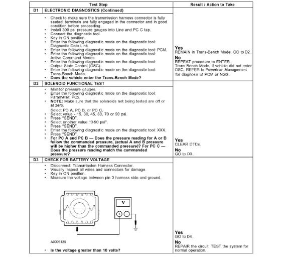

The 775 is an internal issue with the transmission. There is nothing external or electrical for this issue. The only thing you could try is changing the oil/filter in the transmission to raise the pump pressure.
Below are charts for the checks to verify the failure. I would have someone do these checks before assuming it is a bad transmission.
