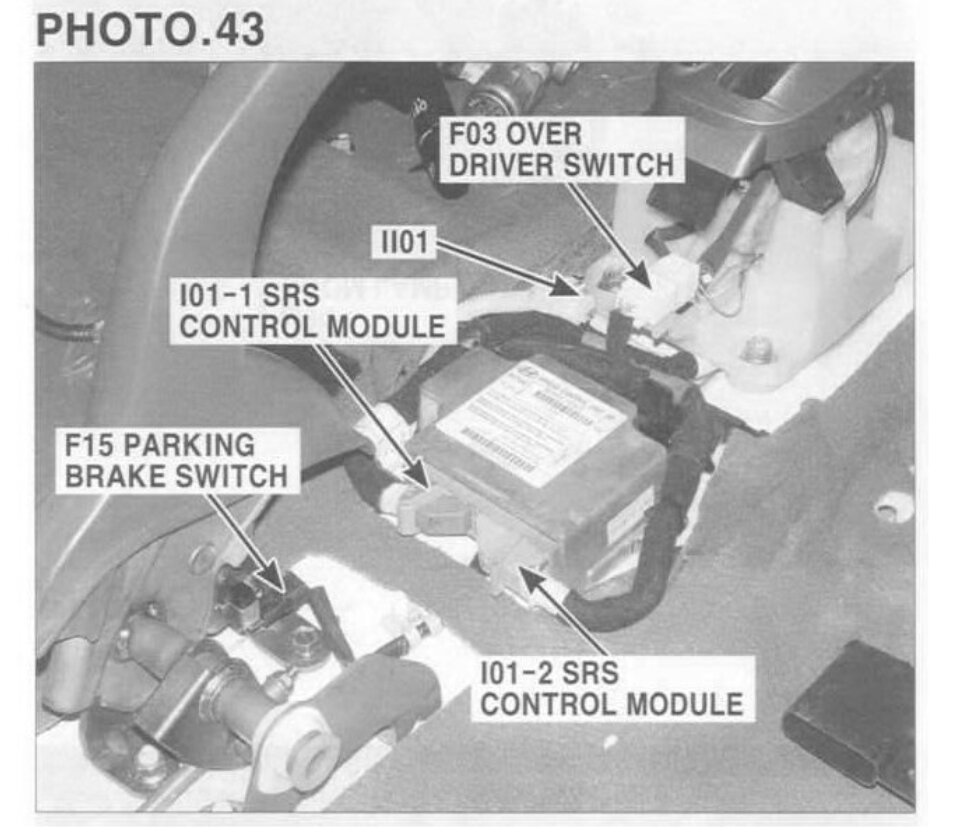

It randomly started and it was just on when i turned my car on one day and when i clicked the button nothing happened, it didn't blink or anything. so, i know it's electrical but it will occasionally turn on and back off again. I'm not sure how to solve this issue.

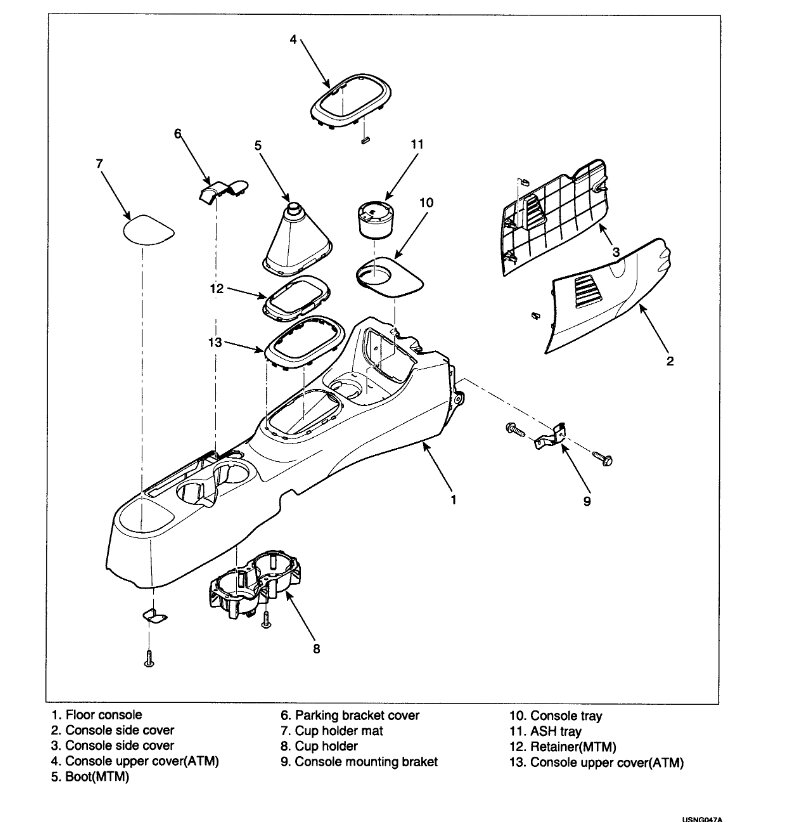

The first thing we need to do is a CAN scan to see what comes up, if no codes are found I would replace the switch. You can get a CAN scanner (Controller Area Network) from Amazon.

You will need to remove parts of the center console to fix it, please check out the images below and let me know what happens.
