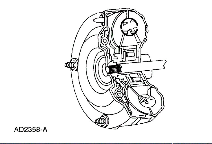

MTABOR
i was driving on freeway, and noticed the o/d off light flashing, i didn't notice anything weird/different, until i was coming to a stop. the first stop light i kinda thought it was just me; i was wearing flip flops and maybe my foot slipped or something. then at the next stop sign, it was almost kind of like a hesitation? our speedometer was discovered last weekend is 5 mph off. please help.
Dec 21, 2020 at 5:17 AM (Merged)
Good afternoon,
With the light on, there is a code stored in the system. In most cases, it is the torque converter that is the issue.
The first thing I would do is change the fluid and filter. It may be starving for fluid from the filter being partially clogged.

A MURPHY93
I have a 2000 Ford Explorer 4.0 4x4. I was doing some trail riding today didn't give me any problems but then I get back on the highway and I started to notice it wouldn't shift until 3,000 rpm's, then it stopped shifting at all. drove it home in 2nd gear and the overdrive light started flashing has 2000 xxx miles on it I'm not sure what to do; solenoid change or just replace the transmission? Not sure what to do. never gave me any problem at all still pulls strong in 1st and second. I don't want to waist the money on solenoids if it wont fix it. they are like $60.00 a piece for those. any help would be cool.thanks
Good afternoon,
This issue is caused mostly by the torque converter. It may either be stuck in lock up or will not lock up. When that happens, the light will flash and disable converter commands.
Are there any codes set in the system?
The first thing I would do is change the fluid and filter. Check the magnet in the pan for any metal or debris.
