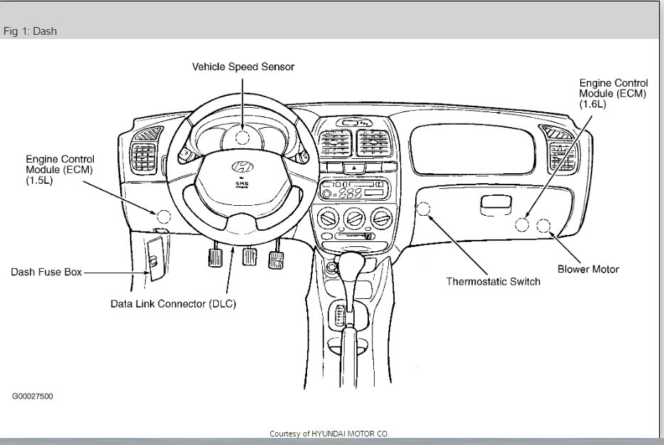

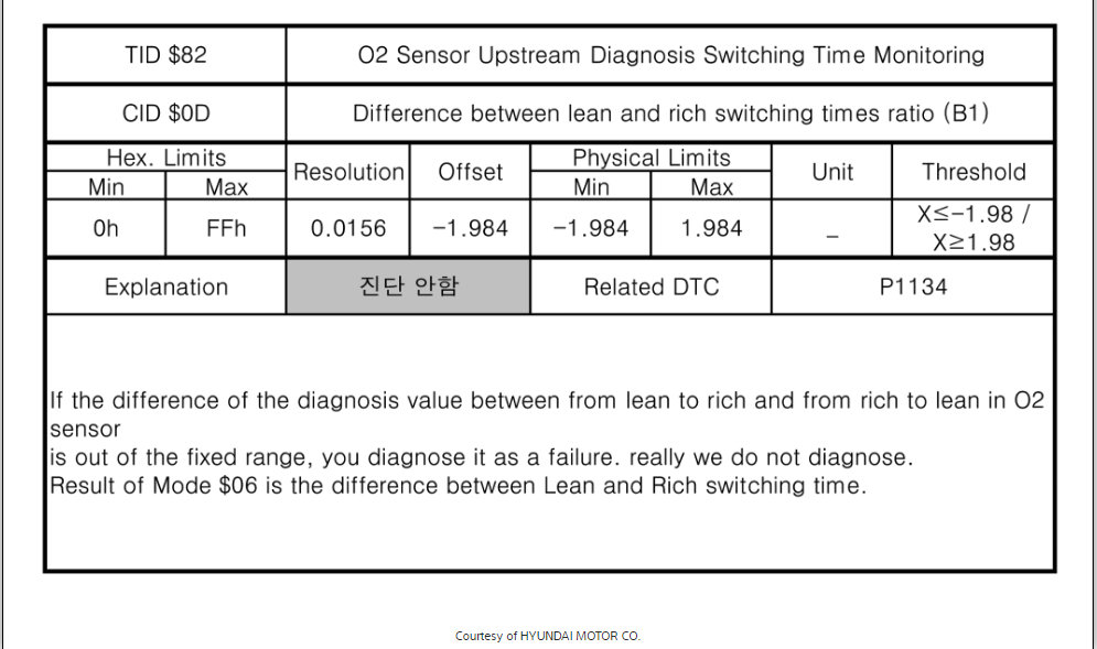

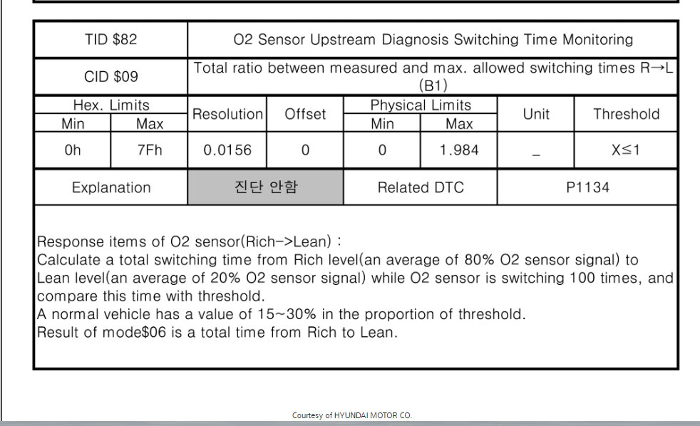

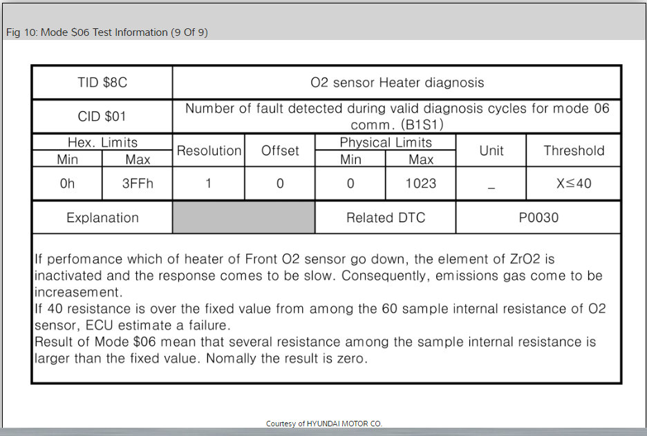

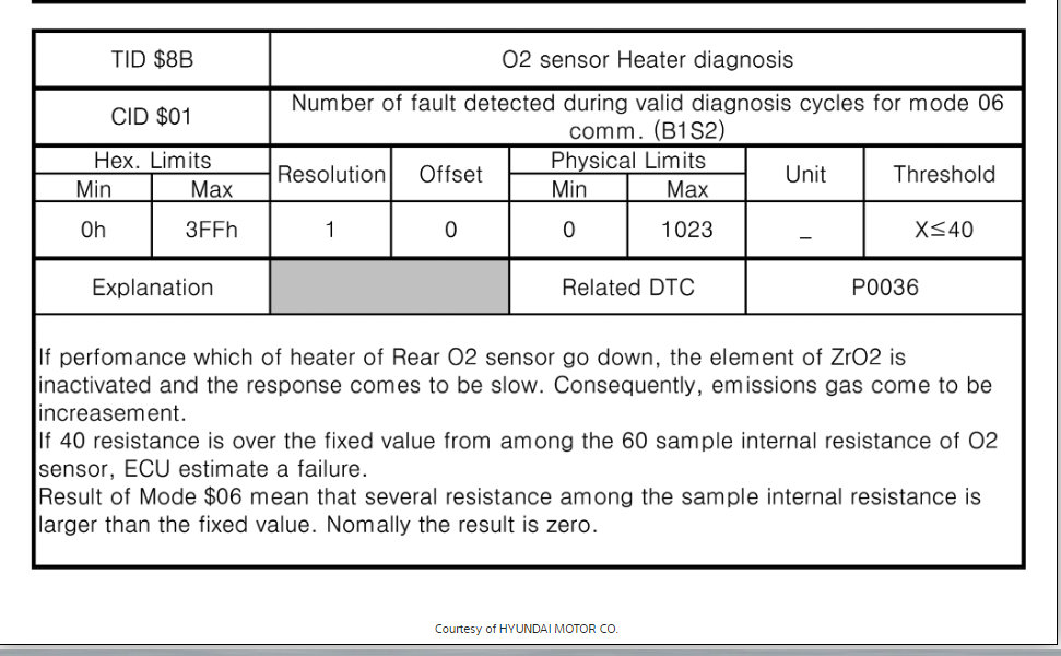

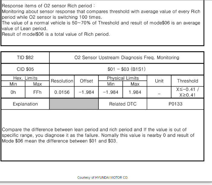

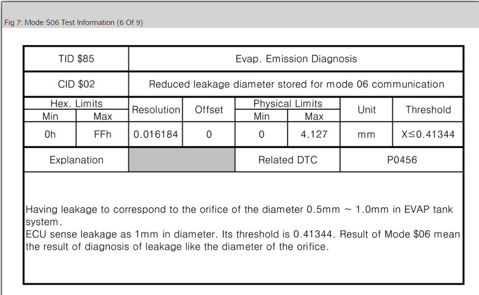

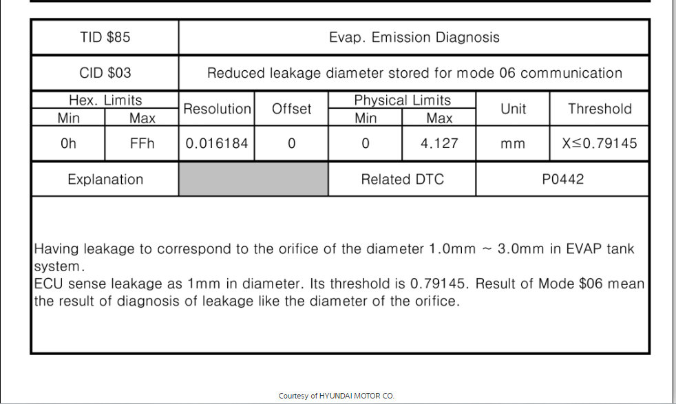

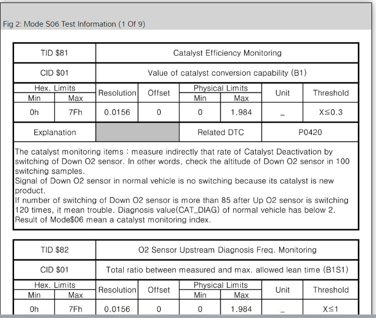

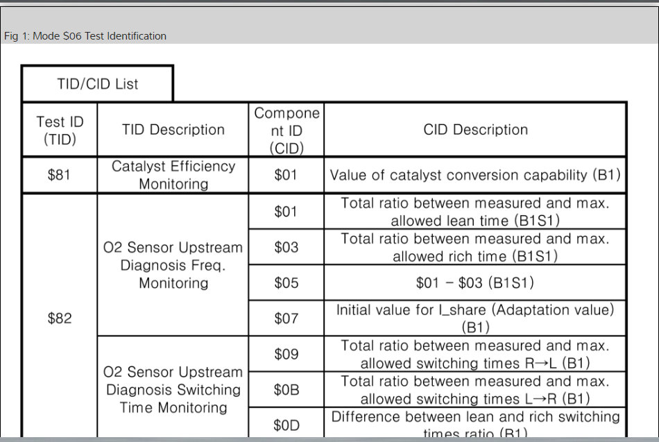

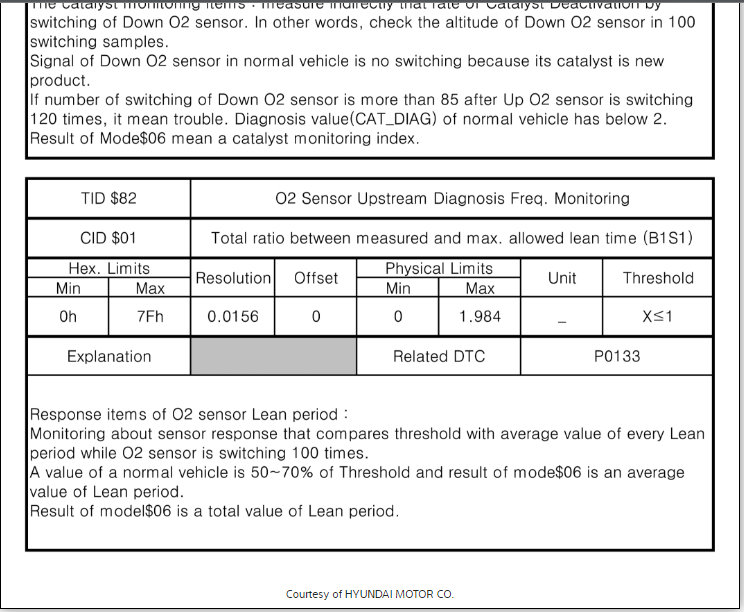

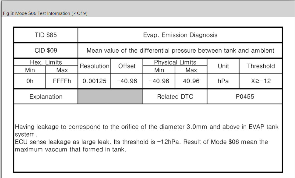

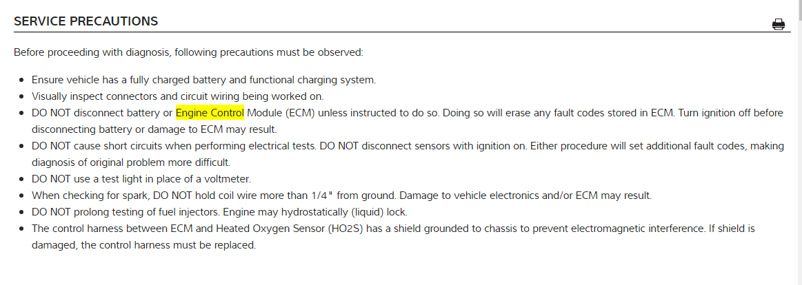

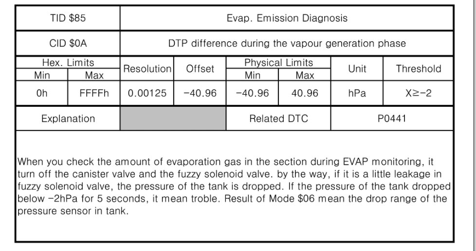

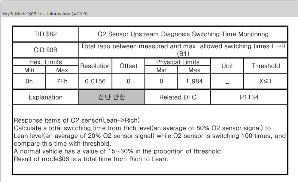

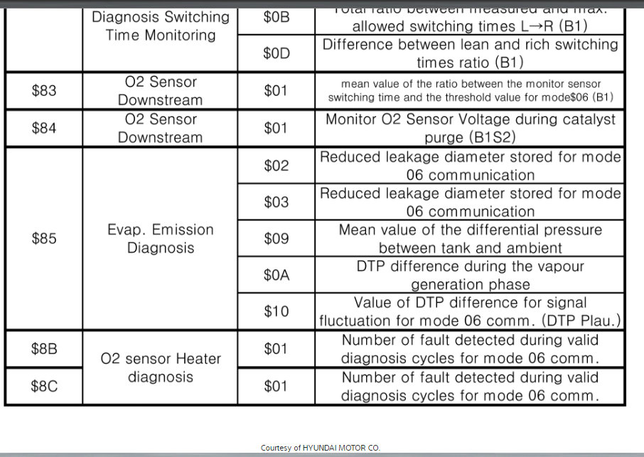

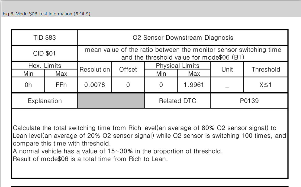

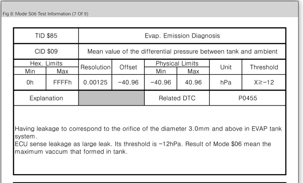

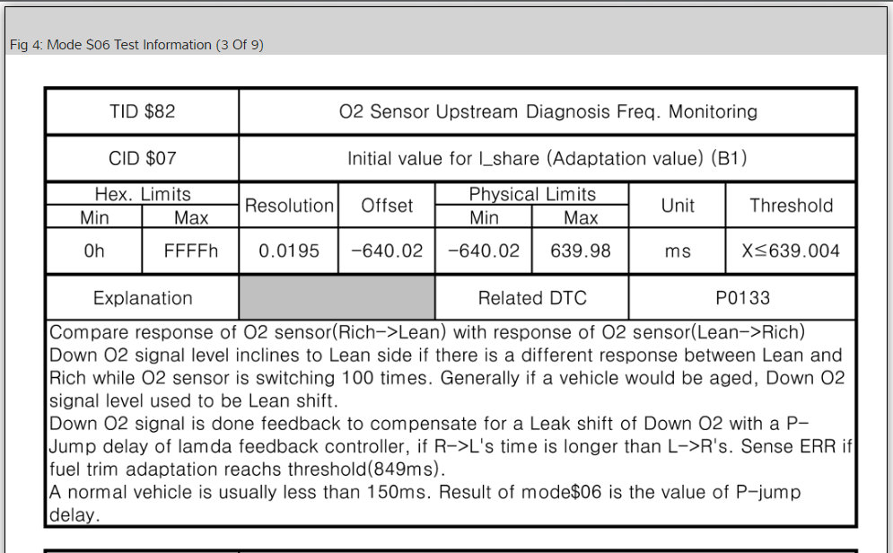

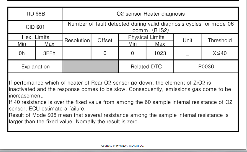

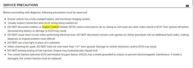

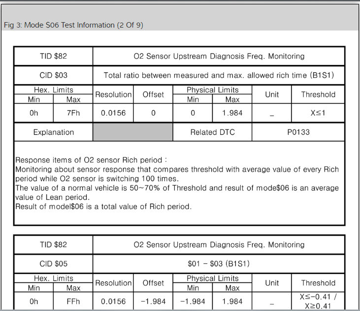

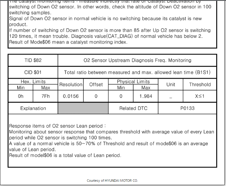

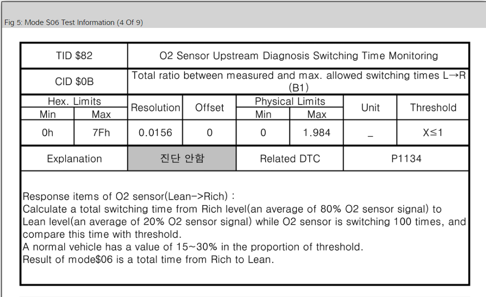

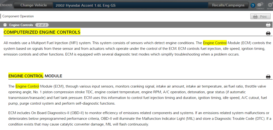

The problem probably is with the Power-train Control Module (PCM) or Electronic Control Unit (ECU)(Both do and are the same). If the monitor system is not ready, then you have an internal fault in the PCM/ECU. You should be able to go to either Amazon or Ebay and get one for your vehicle quite reasonably. The thing that you want to make sure that you match up is the vehicle's strategy. On the sticker on the PCM/ECU there will be a six alphanumeric bold print on top of the sticker. This must match the PCM/ECU that comes out of your vehicle, exactly.

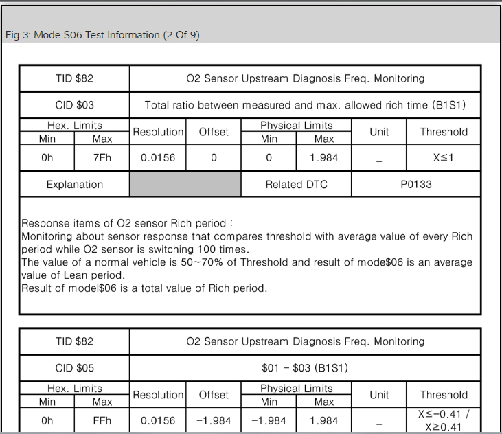

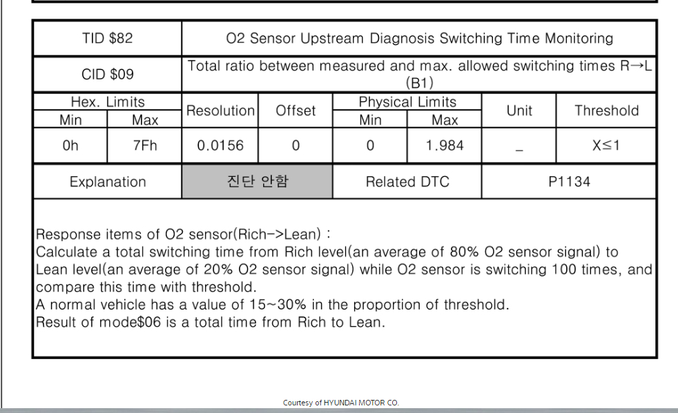

I have included for you in the diagrams down below the location of the PCM and all the Mode 6 information. Mode 6 is the name given to all the monitors of the PCM. Please go through this information and get back to us with what you find out.
Thanks,
Alex
