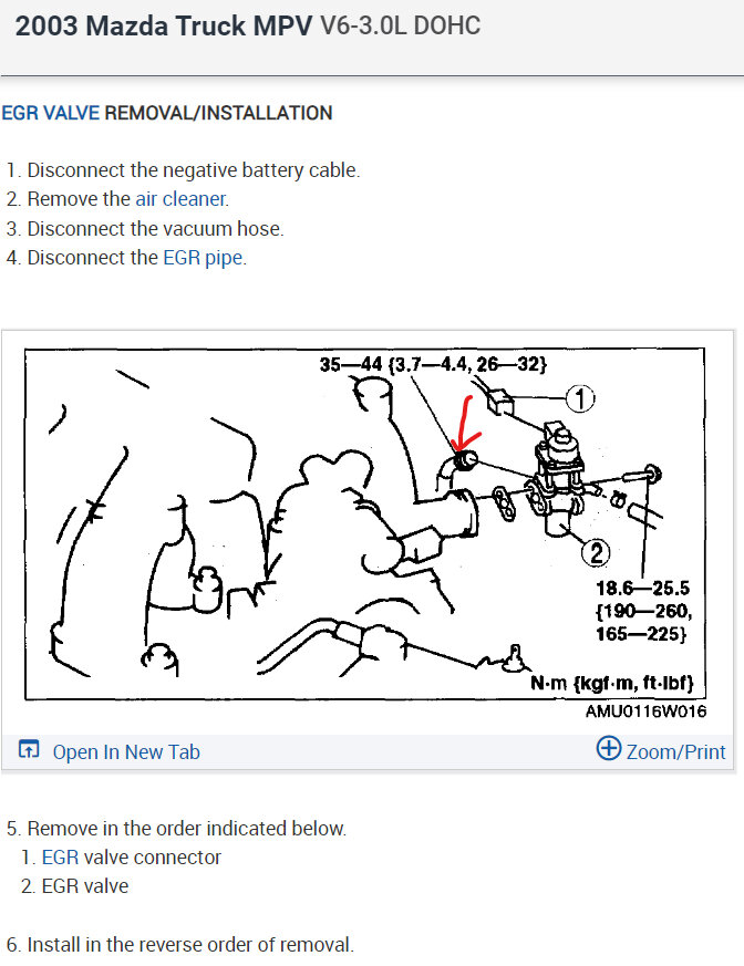

I'm curious if you might know the size of the nut connecting the EGR tube to the EGR valve on my 2003 Mazda MPV. I need to get a crow's foot wrench to loosen the bolt but I'm not sure of the size. I can't seem to find any definitive answer via internet search. Thanks for your time.

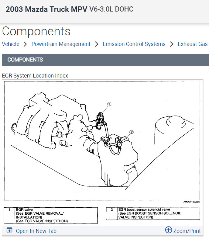

There is no information that will tell us this information but if I remember correctly, it will be 1 and 1/8. Here is everything we have on the repair. Check out the images (below). Please upload pictures or videos in your response to any problems so we can see what to help you with.

Thanks for the info. I ordered an adjustable crows foot wrench, hopefully it'll allow me enough access.
